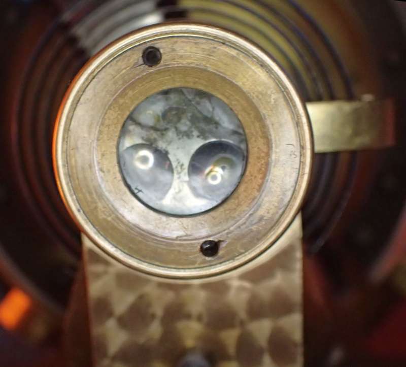

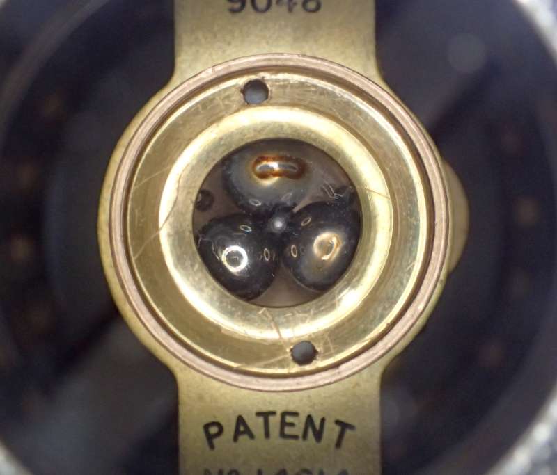

                          Couple of better images of Eureka bearings. Some are three balls as on the top image, some only have two balls as and a plate which retains them in the correct position as in the lower. The arbour is central to the housing and rides on the lower two balls.
                          Three Ball Bearing
                          Two Ball Bearing
                          They are fascinating clocks to watch (and work on). I have a couple a short (the two ball) movement which has the balance wheel behind the dial, and a tall (the three ball) movement with the balance wheel below the dial. The latter is very similar to the one Michael linked to.
                          #716073
                            Thanks, Peter … very interesting

                                                      For example: You have two different bearing arrangements in your clocks, and neither of them much resembles what is shown in the patent.
