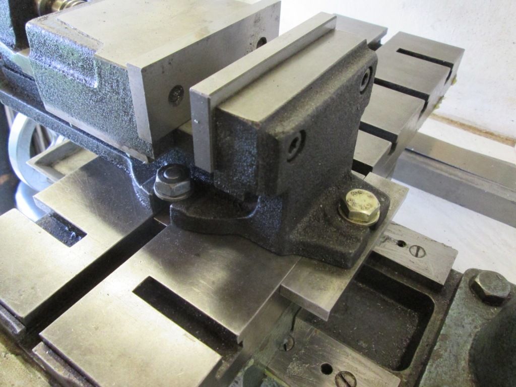

                  Bazyle
                    @bazyle
                    I have a dividing head with x & y slots milled from new. Not uncommon. So if you are doing it make both slots. Problem is you will keep having to switch slots.
                    An alternative method is to machine at least 2 sides of the base true to the jaws. Then fit a plate in the rear slot to butt the side up against, using parallels if necessary. For larger vices that overlap all slots use some thought and make reference points that are accessible eg on the bolt 'ears'.
                    That reference plate is often useful and can be held in place either with typesetters quoins or custom made with 2 tapped holes that have bolts of length just under slot width that are unscrewed to push the plate against the other edge. (from Mike Chrisp ex editor of ME).

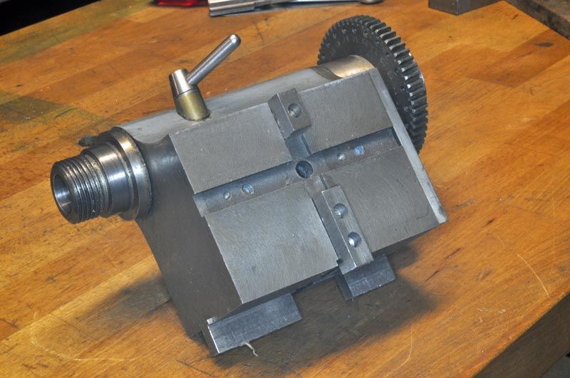

                      Roderick Jenkins
                        @roderickjenkins93242
                        I've had keys on my milling vice and dividing head for the last 30 years. I believe one can call them feather keys since they are fixed in one part but are able to slide in the other. Mine are at 90 degrees but I almost always use them in the one orientation.
                        The dividing head can fit on the cross slide of my Myford lathe or on my mill table. Whilst I've kept the seats in the dividing head the same size on both faces, you can just see in the picture that the keys for the mill have been reduced in width to fit its narrower T slots.
                        Thanks to Ron for publicising this feature, I've found it to be a great time saver

                          #149326
                          Glyn Davies
                            @glyndavies49417
                            I locate the milling vice on my Dore Westbury using a piece of 1×3/8 steel tapped M10. I set the vice dead square and tighten its clamp bolts. Then offer the 1×3/8 bar to the edge of the table and push it hard against the table while tightening the M10 bolt. I then just make sure I have the bar against the table whenever I refit the vice. No backlash and no modification to the mill or vice.
