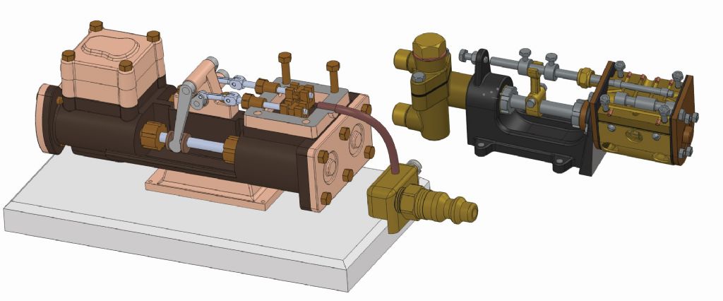

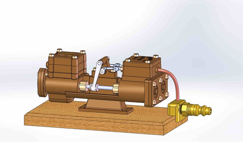

                There are models of steam operated boiler feed pumps on Grabcad.com and are free to download.
                Worthington Steam Pump – Utilizing a slide valve, directly linked to the pump piston. Files are in STEP format and can be imported into most 3D CAD packages.
                Youtube video **LINK**
                **LINK**

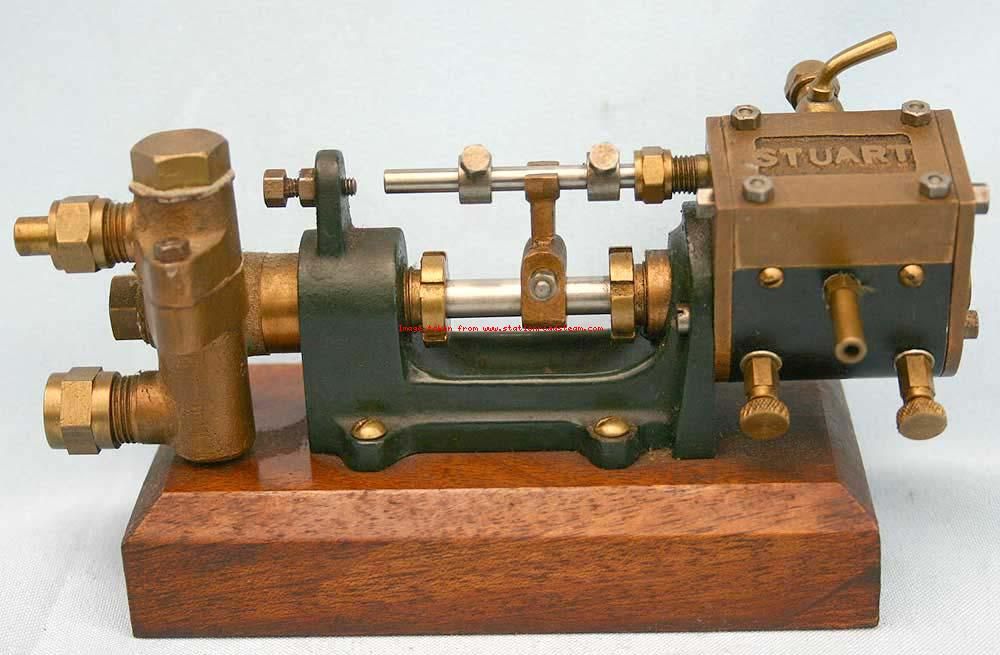

                Or a Stuart Boiler Feed Pump which has a hydraulic shuttle valve, a more reliable way of reversing the pump direction. Files are in Solidworks, STEP and Stl format.
                **LINK**

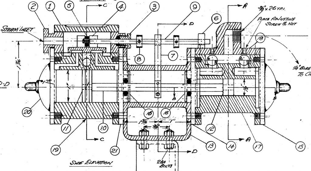

                          Thanks Paul. going back to the Austen Walton pump I've found it is described in volume 103 , 1950. Does anyone have that please? Would it be possible to get a copy of the relevant article? Thank you. I have volumes 102 and 104 and there is a picture of it in volume 104 and he says it was recently described so I am assuming it was in volume 103.

                            Sarik Hobbies sell plans for a J L Austin-Walton twin cylinder, double acting steam pump for £13.00
                            **LINK**

                                  Hi everyone, thanks for the feedback. I've found the Austen-Walton article at last! A friend who lives locally had a load of old volumes and I found it among them.

                                    Having had dome arms length involvement with steam air pumps, the duplex ones just work, the shuttle valve ones are touchy. Does the Austen Walton one have the reversing lever or cross drilling?

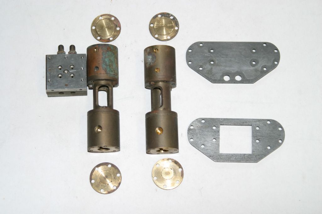

                                      Many years ago I came by some boxes of assorted locomotive castings including a part built duplex steam pump. I have often wondered whose design it was with the thought of finishing it. Now looking at the link provided by Paul it looks like it might be Austen-Walton's from Twin Sisters. Which issues of ME was it described in? If you could check, some dimensions of the pieces I have are: top and bottom plates: 3" x 1 3/8", Cylinders (steam and pump ) 1" dia x 1" long, overall height of cylinders and spacer less top and bottom covers 3 1/4", valve chest 1 1/4" x 1.175".

                                            Hi John, yes that is the Austen-Walton one. I now have the articles , they are in October 12th and October 19th 1950 issues. The top and bottom steel plates are very distinctive.
