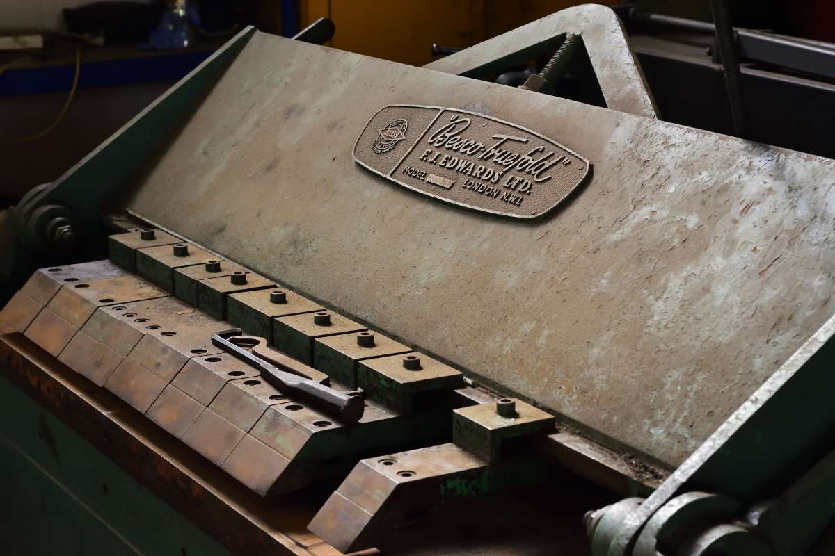

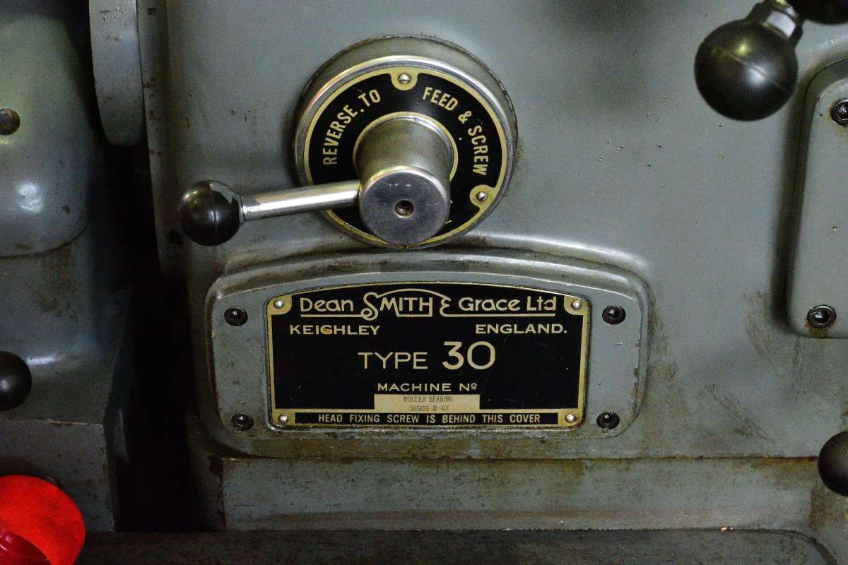

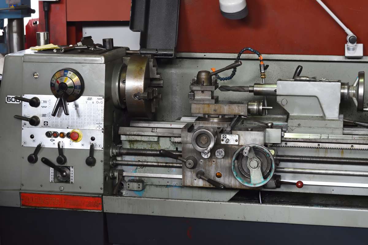

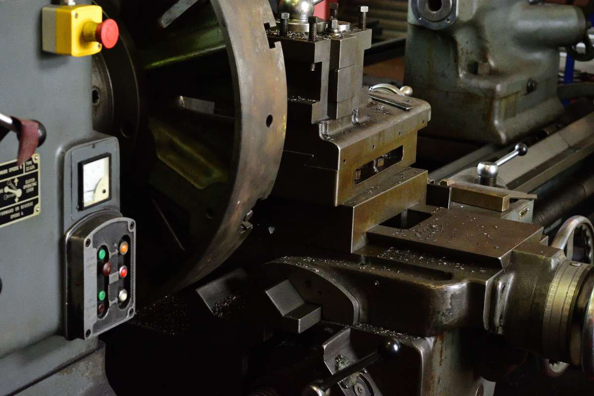

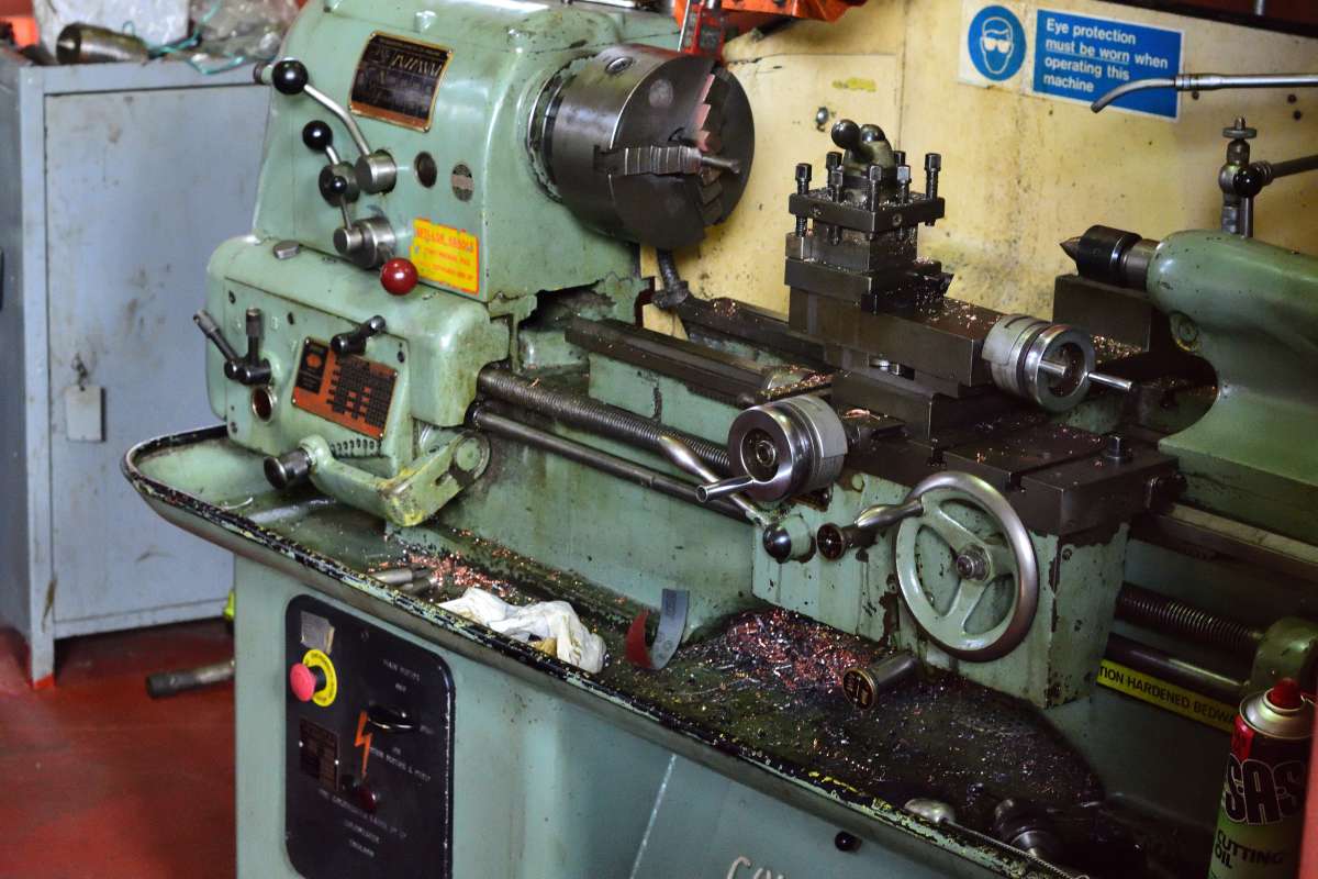

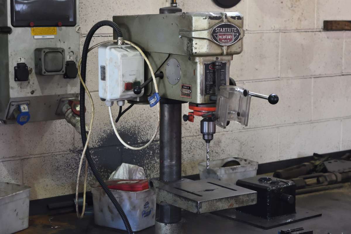

                  Grindstone Cowboy
                    @grindstonecowboy
                    Looking back at my photos, it seems like they managed to acquire a replacement (or skilfully restore the old) DSG at Ravenglass, as the fire was in 2013 and I visited in May 2019. There was also a couple of Colchesters (Triumph 2000 and a Bantam, I think), a Start-Rite Mercury pillar drill and a Besco Truefold press brake, amongst other things.
                    The arsonist got a ten year sentence in 2016, so will be out around now.
                    Rob
