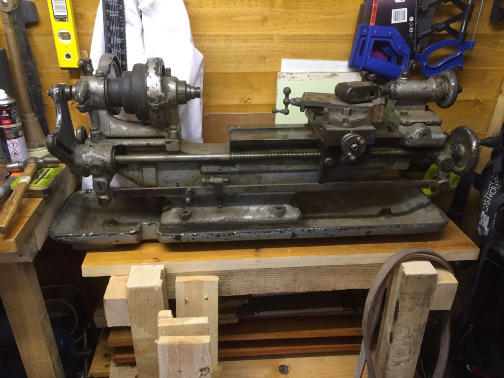

      I have recently acquired a Drummond 3 1/2" M Type lathe. I have just started to strip down to refurbish it, overall it seems in decent condition generally but is currently still very 'as built'. I have been trawling the internet looking for some spares as I think I'm going to need to replace the lead screw and nut. I also think I will need to acquire some of the change gear bolts for holding the gears to the banjo. whilst I can find a few spares I'm struggling to find somewhere I can get a leadscrew and nut. any ideas??
      also I was wondering if anyone has any experience of the size motor I should rig up, I have got a couple 1 being a small 1/4 horse from an old washing machine and the other is a 1/2 horse from an old black and decker band saw. the latter being my preferred option as it has a bracket I can utilise to attach to the rig with the countershaft. any comments would be much appreciated.

              Welcome to the fold. Quite a few M-type owner on here. Mine is a 1937 model, still going strong.
              Post us some pics of what you got. (Best way is to post pics to Photobucket and then use the image button at the top of the new post pro-forma to insert the direct link into your post).
              What makes you think the leadscrew needs replacing? Usually it is just the half-nut that wears out. MEW magazine ran an article by Geoff Walker in the past 12 months or so on how to fix it up. There is also details on the Yahoo Drummondlathe group on how to cut up the original leadscrew and reverse the threaded section so the unworn section from the far end is now in the most used spot next to the headstock. It is in the Files section, IIRC, which is a good place to download all the info you can from, before they shut the groups down (inevitable one day, they are so primitive). Another good file to have is the section from the owners manual on how to adjust the headstock bearings, a simple but cunningly tricky technique which must be followed to get a good finish on these old lathes.

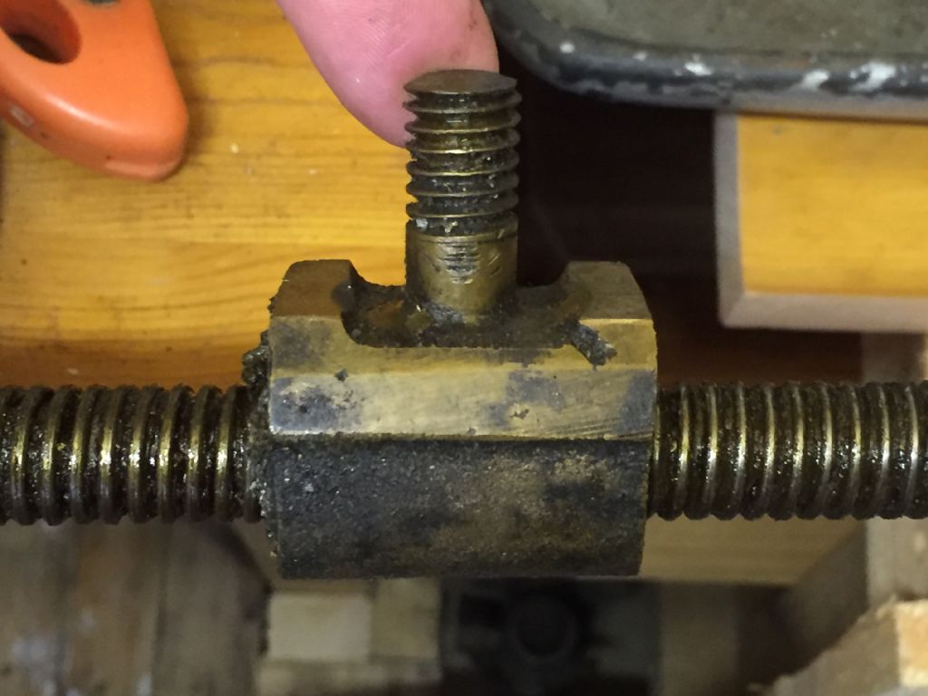

                i have stripped the lead screw out and it is heavily worn, the nut is U/S as is places i can move it up and down the lead screw so threads must be ruined.
                i was wondering if a Myford ML 7 leadscrew could fit?

                  Does anyone know if the lead screw looks standard? there is a shoulder at one of the screw and i can't work out how its fitted or how it can be removed so i can remove the nut. i was wondering if the leadscrew at some point had been damaged and repaired by adding the part with the shoulder.
                  you can see in the below picture with the nut, the threads to the right of the screw are very rounded.

                    Much depends on how much you have invested in the ole girl currently, how much tooling you have, and how much you are willing to punt in the future. You've seen the prices asked for M type bits and bobs; crazy IMO.
                    What you have right now is an old machine, quite worn and lacking some parts. If you look on it as a fun project in itself, and don't actually need a fully competent lathe straight away, then fine, but if you want to use a lathe to make things without a good deal of time and money invested in fettling, this probably isn't the place to start.
                    As to specifics …. the lead screw looks to be standard; can't comment on the shoulder because I've never disassembled one, but Im guessing it must be pinned or just possibly, sweated. The change wheel "bolts" are actually thread-less spring pins; there is a drawing on the Drummondlathe website in the files section.
                    The other areas you might check before making a decision on future progress is wear and tear on the bed ways, the state of the spindle and bronze bearings, and the condition of the saddle and cross slide gibs / vees.
                    Sorry to sound a bit cautious, but I've been where you are, and whilst some of it was fun and instructive, a lot of it wasn't. On the positive side once you've got an M type sorted, even a novice like me can produce some surprisingly good work, which is very satisfying.

                          Naive question, but doesn't the nut come off the tailstock end of the leadscrew, not the headstock end?

                            What we see in Anthony's picture is the top section of the bronze lead screw half nut … except it isn't threaded from the factory, just a plain shell; it isn't permanently engaged. Pic below from a selling site ad of the apron from an M type with the parts of the half nut arrangement.

                              The bush is at the tailstock end to take the thrust from the leadscrew doing its job and fits up against the larger diameter of the thread. A spanner that just fits over the thread followed by the rest of the spanner set can act as sort of slide hammer and avoids hitting the bush one side only. Put the handwheel securing nut back on the end to protect that thread end before anything else. I suggest cooling the bush and rod as far as possible with an ice pack then with cardbosrd heat shields each side of the bush heat it up with a paint stripper gun to try and get a bit of heat differential expansion while the main rod is still cold.
                              Worst case you turn off the bush – trying that might reveal a pin holding it too. It's not that extreme you have a lathe so you can make a new bush.
                              Like I said it is easy to modify so have a look at how the M-type half nut works and copy that instead of the B-type fixed nut.

                                Ignore me, I've got that nutty thing wrong. Anthony's M is an early type with a full nut.

                                    This type of lead screw with the full nut suffers the same problem as the other early drummond lathes.
                                    Because it is is a full nut rather than a half nut it is constantly engaged, so it is rare to find one in very good condition.

                                        If you look on the Yahoo Group, Drummondlathe, in the Files section, there is a description of how to cut the lead screw, turn the threaded section around and rejoin it. so the worn out section is way down the tailstock end where you never use it and the unworn section is now up near the chuck in the high-use area. You just cut the lead screw and machine a hole in the end of one part and a matching spigot on the end of the other part and put them together with Loctite, a pin or a tack weld or whatever.
                                        If the nut has enough teeth left to then grip on the unworn section you can machine up a new insert from brass, bore out the original nut and solder or loctite the insert into position.

                                            Posted by Anthony Jamieson 1 on 03/06/2016 12:11:52:
                                            … you can see in the below picture with the nut, the threads to the right of the screw are very rounded.
                                            Indeed they are, Anthony … and I think your opening assumption that you need a new leadscrew is quite reasonable.
                                            That said; unless you are intending to do accurate screwcutting, you will probably get away with it for years.
                                            … Concentrate on the rest of your restoration, and grab a decent leadscrew when one comes along.
