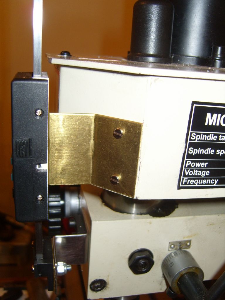

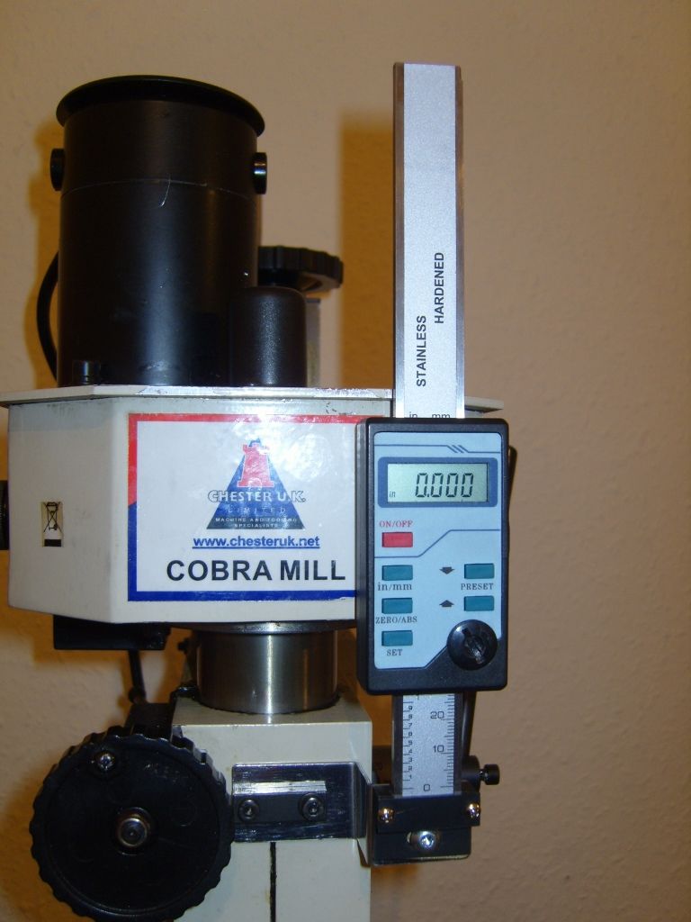

      Hi, I though it time I fitted DRO's to my Mini Mill. I have gone for three separate units and the first one I fitted last week is on the Z axis and has proved to be very satisfactory in use. This one consists of a vertical slider with is own DRO, the slider being attached to spindle drive cover and the bottom end of the bar attached main body of the mill head.

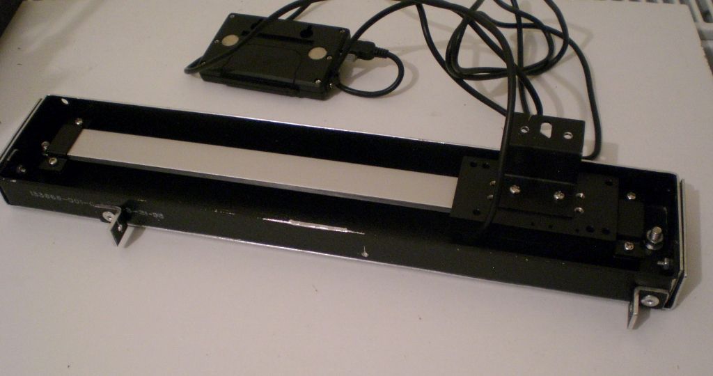

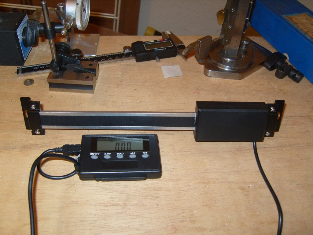

      The X and Y ones are the slider which is plugged into an Individual remote DRO type, there is no DRO on the slider itself.
      The bars of these two will be mounted onto an aluminium carrier which will also cover the bar and slider to protect them from swarf and oil ect.

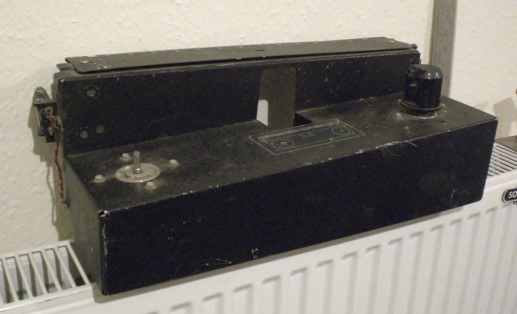

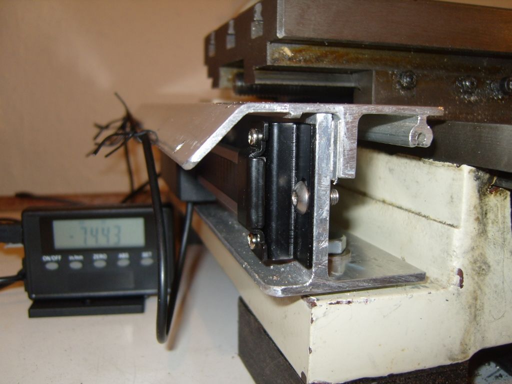

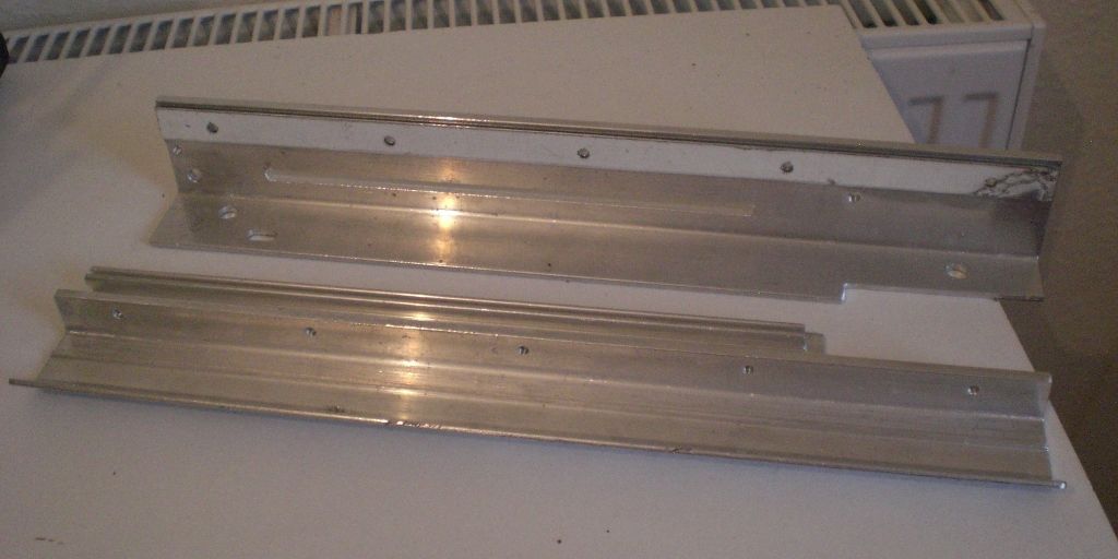

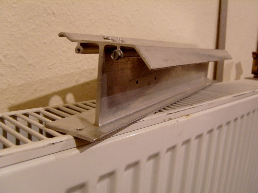

          Hi, the aluminium extrusion in the photo below was salvage from a scrap Telex printer and is what I have used to mount my Y slider bar onto.
          This had to be cut down, as it was too tall to fit under the mill table. Firstly using a hacksaw the upward angled bit on the left hand side was cut off at the bend and then the whole of the top part was cut off 20mm down the vertical web, then the section on the right hand side of the top, with the screw in it was removed as best I could with a normal 125mm cutting disc in my angle grinder. All the cut edges were then trued up on my mill and the two parts were cut to the required length. A 5mm slot was then milled into the lower part of the vertical web of the bottom part, long enough to accommodate the slider bracket for the full length of the slider bar. A hole was drilled in each end of the left hand side of the horizontal part of the bottom piece, to allow it to be bolted down with the bolts that hold down the left hand side of the mill. The vertical web of the top piece was drilled and tapped and matching holes were drilled in the vertical web of the bottom piece and a 15mm X 2mm packing piece was cut and drilled to allow it to be sandwiched between the top and bottom pieces, when they are bolted together.

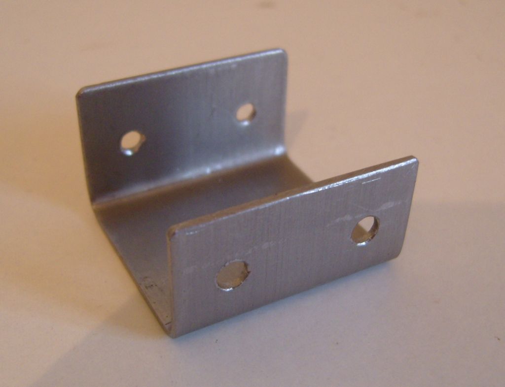

          A new bracket was pressed up for the slider, as the one that came with the unit was no good for my purpose.

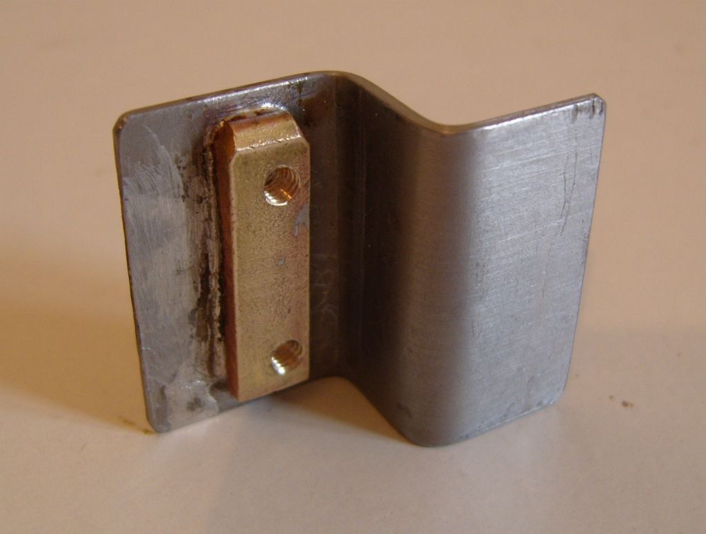

          An extension bracket was also pressed up to attach this bracket to the cross slide of the mill, then the earth pin from a scrap 13A electric plug was soft soldered on, to correspond with the two holes in the slider bracket and were drilled and tapped for the same.

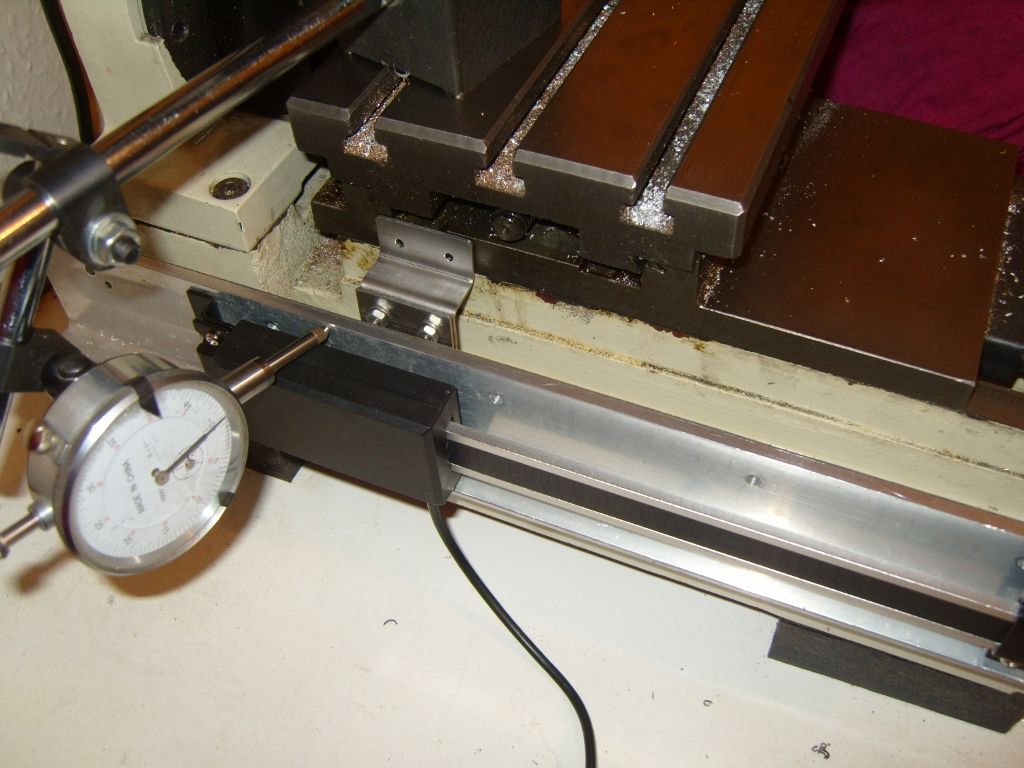

          The lower piece of the carrier had the slider bar fitted to it together with the slider bracket and extension piece and was mounted onto the milling machine, Then a DTI was set up to check that it was clamped down parallel to the cross slide, before the two holes were marked through the extension piece onto the cross slide and were drilled and tapped.

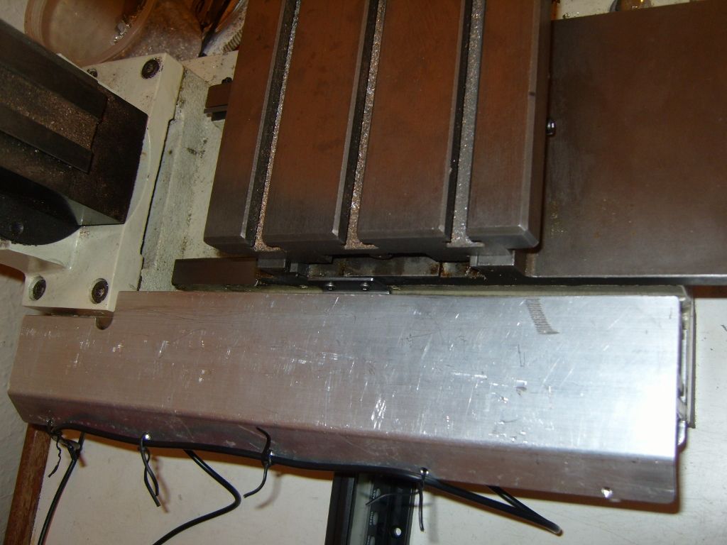

            Hi Nicholas,
            Make sure that you have a protective guard over the DRO. I originally had these on my mill and they failed and started to give irrational readings. I suspect because of moisture or oil on the slide. Cleaning the slide had little effect. Replaced them TWICE. Eventually replaced them with better glass scales.
            Paul.

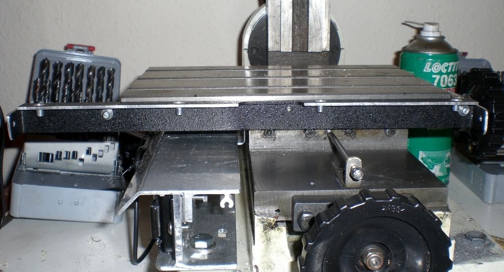

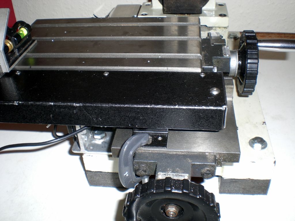

              Hi Paul, a protective guard over the slide and bar has been in the plan all along, The photos below show the Y slider and bar completed and guarded from swarf and oil ect.

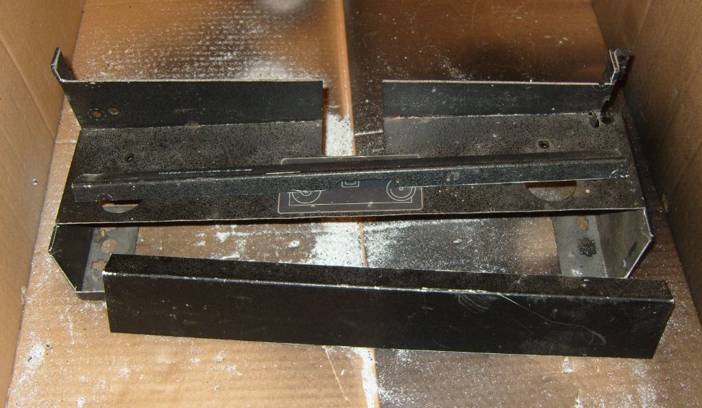

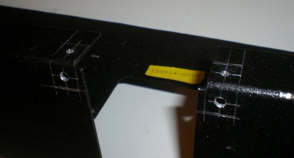

              Turning attention to the X slide bar and slider, the next photo shows the printer ribbon assembly from the same Telex machine as the aluminium extrusion that the Y slider guard was made from.
              Two sections were cut out with a jigsaw, as shown in the next photo.

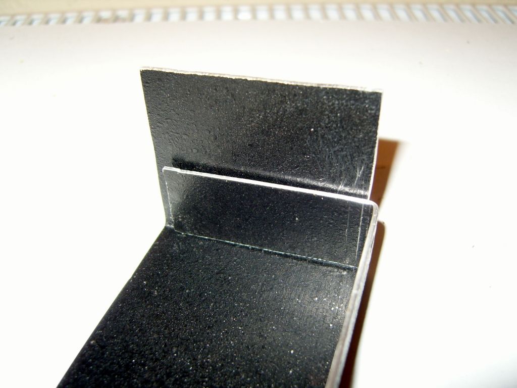

              The larger section at the bottom of the photo had each end pressed up as shown in the next photo and the excess bit that is sticking up, was then cut off to the same level as the other fold.
              The smaller section that was cut out, had both ends folded in on the wider side, so that it fitted snugly between each end of the open side of the pressed up section in the above photo. The narrow side was then drilled with four pilot holes and was then clamped into the pressed up section with spacers between it and the opposite side to get the two parralell and the four pilot holes were marked through with a transfer punch. see photo below.

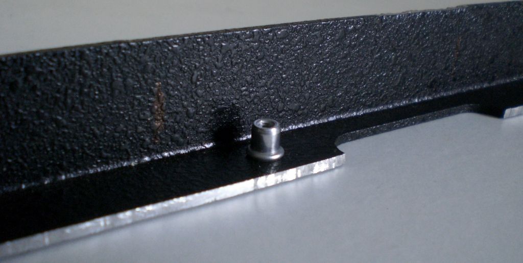

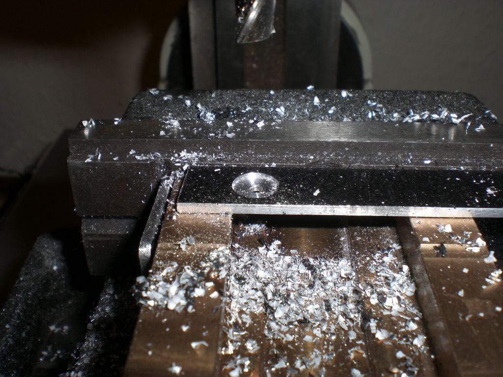

              The smaller section was then held in a vice on my mini mill with the top side upermost and the four pilot holes had an 8.5mm recess cut centrally on each of them using a slot drill, to accomadate the thickness of the flange of 3mm threaded inserts, so that the threaded insets are flush with the top side of this section.
              Regards Nick.
              #215544
              Nicholas Farr
                @nicholasfarr14254

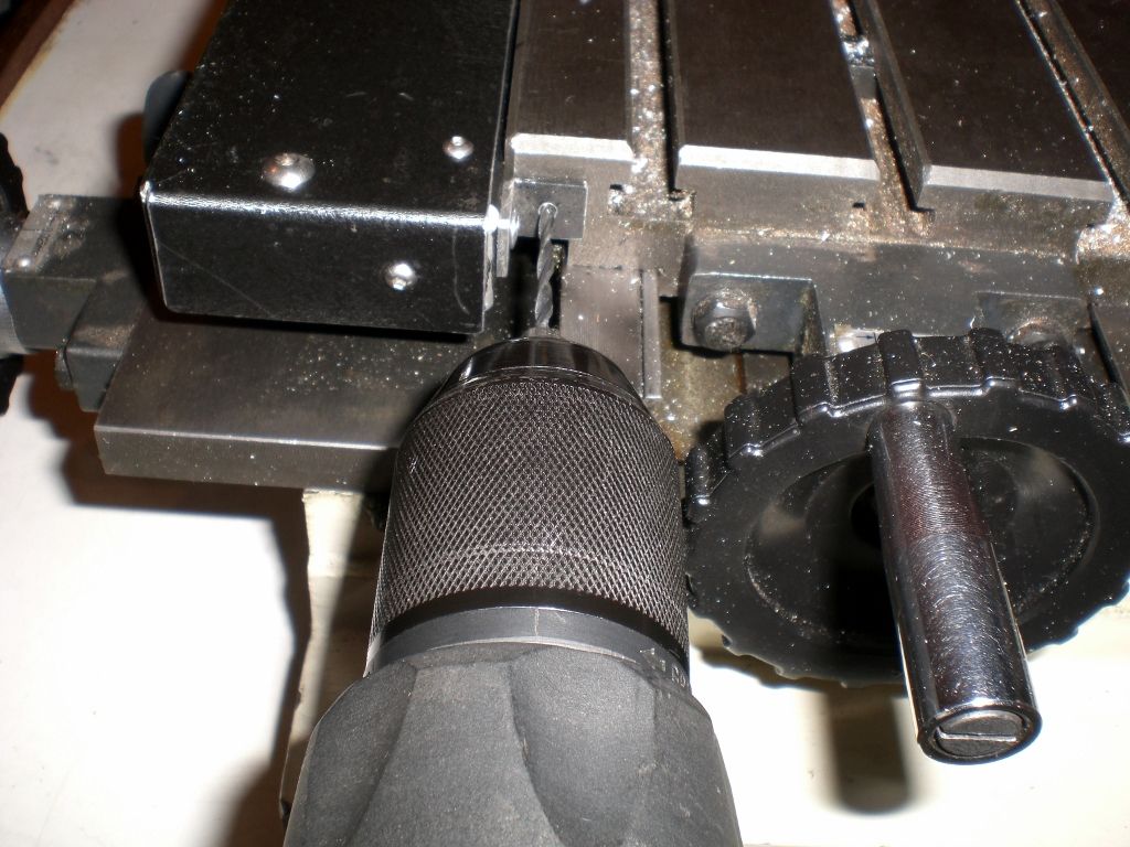

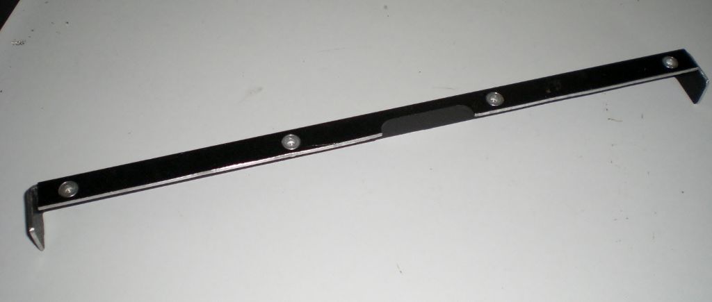

                After repairing the pulling pin of my threaded insert riveter **LINK** I riveted all the threaded inserts into the section shown below.
                This was then attached to the larger section that carries the slide bar and holes were drilled for 3mm bolts through the larger section and the folded ends of this section.
                Two 90 degree fixings were marked out, drilled and cut out from another area of the printer ribbon assembly and were pop-riveted to the smaller section of the slide bar carrier, for fixing the carrier to the miling table.

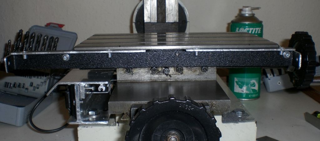

                The slide bar was also fitted into the carrier. This whole assembly was then setup onto the machine and held in place with a small G clamp.
                After checking the carrier was running at the same level as the table, using a small adjustable square as a depth gauge, the holes for fixing it to the table were marked through with a drill.

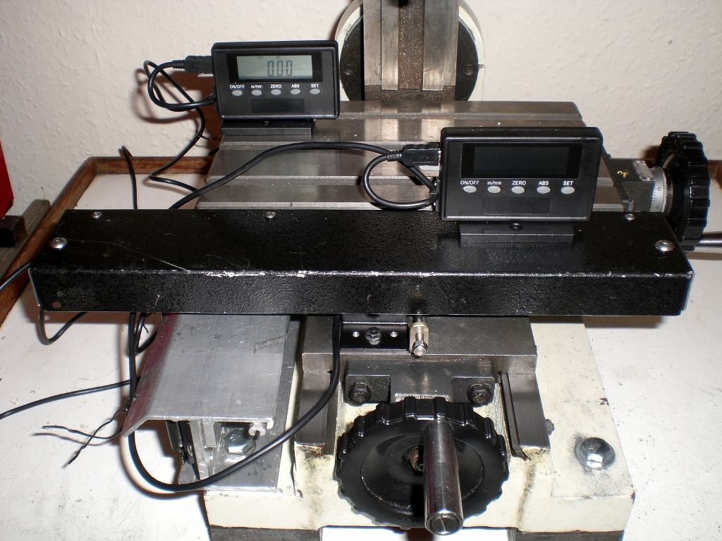

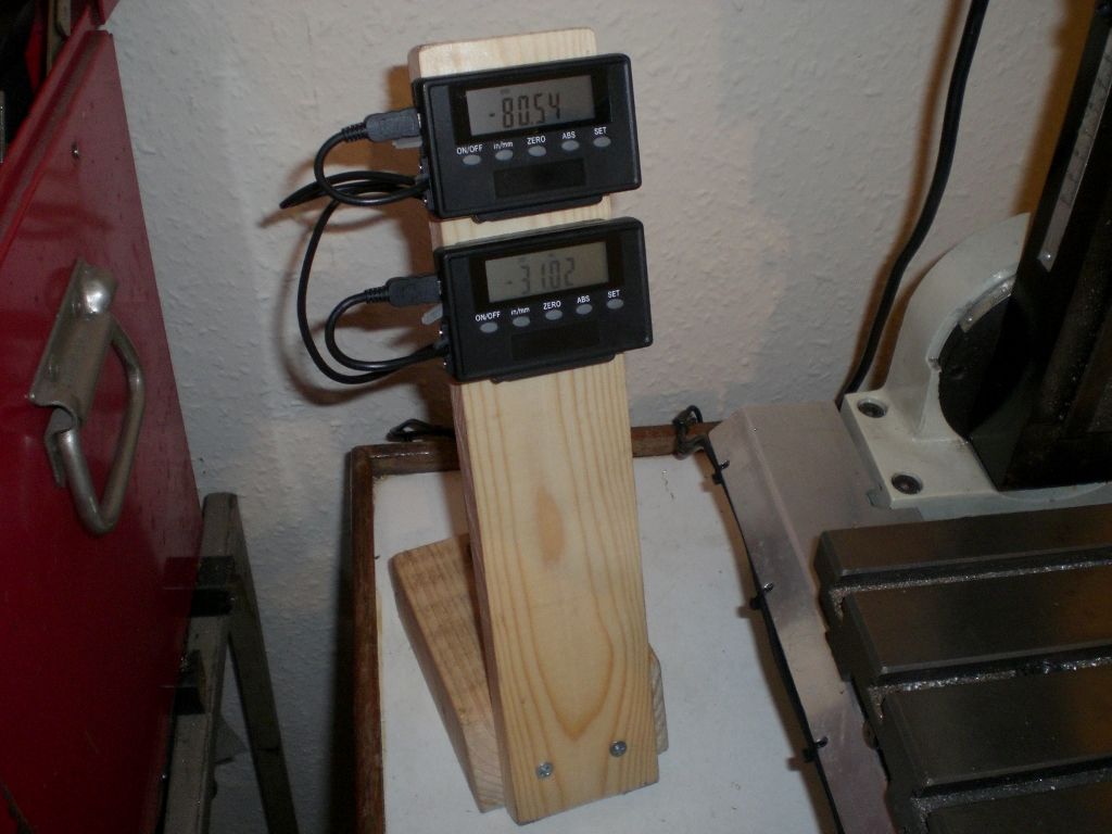

                      Hi, I made a not too elaborate but functional stand for my displays, it is not fixed and can be moved from one side or other and the leads are cable tied to it to help keep them out of harms way.
                      This compleats this project.
