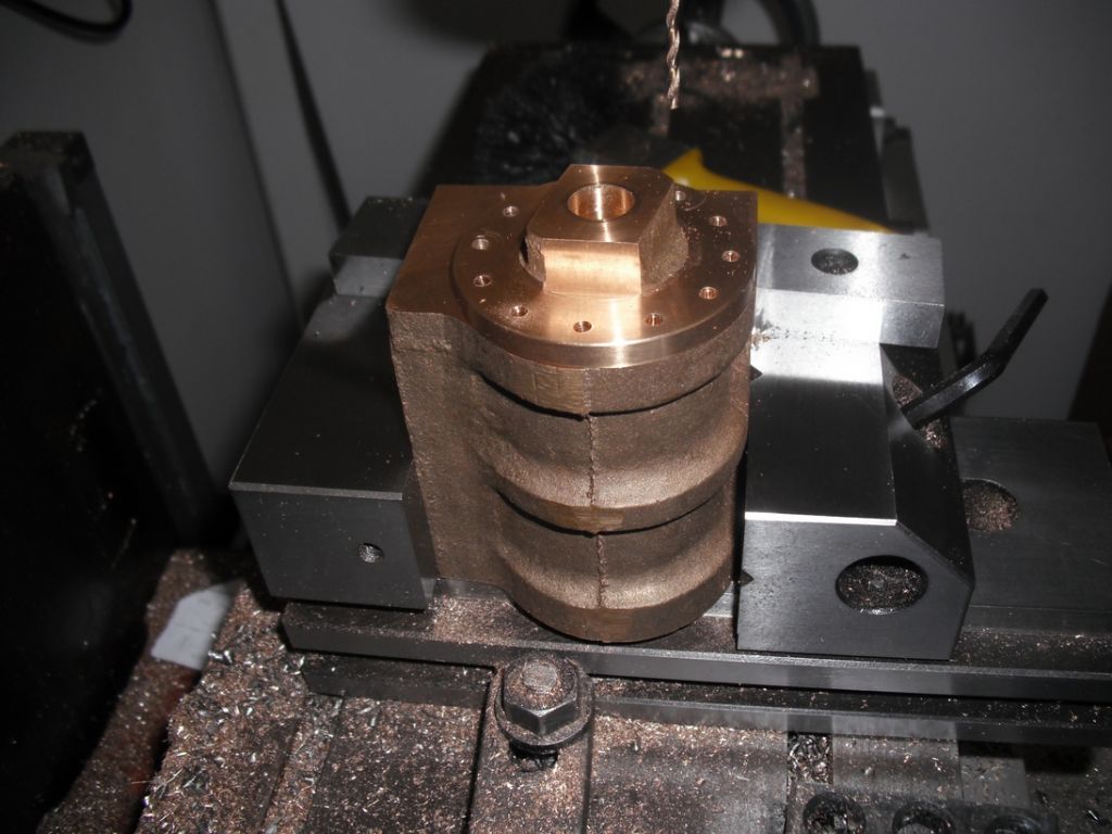

                      Well if you will get other people to make your engines for you it's hardly surprising you don't use the DRO muchsmile p
                      I very rarely do any layout work on a part, tend to locate one edge and zero the axis, locate opposite edge and use 1/2 function which will give me ctr between the two edges and work from there.
                      Metric Imperial is as you say useful depending on the job.
                      Next most used is PCD, enter the position of the ctr of the circle (usually 0,0) then fill in the rest – diameter, No of holes, start & stop positions) and it will then give you the position of each hole in turn. Much easier than using Zeuz tables.
                      Absolute and Incremental can be useful, the absolute can be used to move around the main part and say locate the ctr of a feature, then switch to absolute and layout holes, pocket etc from that point.
                      I have only used the ARC function a couple of times to mill curves and that is hard to understand in the manual. You can mill features you can't easily do on a Rotary table
                      Holes along a ling, again only used once or twice.
                      Anything else is obveously even less used as I can't think of the other functions.

                                John, a couple of curved parts done using the dro, think I use a 0.020" step eg whatever you move x&z teh hypotinuse will be 0.020". Teh advantage of doing it this way is you get a crisp internal corner and can also do longer curves where a milling cutter would not have the reach.
                                And a different radius on teh end
                                Then as you say a quick clean up to get rid of teh machine marks
                                You can also use your CAD package to work out offsets at regular intervals which makes it easy to mill profiles, these were 1mm steps
