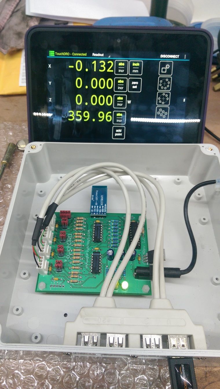

      I currently have these scales **LINK** fitted to my milling machine with the display on **LINK**, however the display has died.
      ​Currently I am thinking I am thinking that I will replace the display with either Caliper2PC or TouchDRO, but I don't know what protocol the scales use, does anyone know and have they successfully used these scales with either system.
      In terms of the reader I am currently thinking I will go with the TouchDRO as it is cheaper, provides the functionality I need and from the youtube videos seems easy to use. With the Caliper2Pc I tried running the demo, whilst it worked I wasn't keen on the display and wasn't convinced that I would be able to use it with a touch-screen as easily as TouchDRO, has anyone done a comparison with both of these recently? I know they are other threads that mention TouchDRO, some rather old, so would prefer recent experience from those that have used later versions of the software.
      If there are better reasonably priced options, that in the future I could upgrade to better scales, I would also be interested, however I don't want to go down the route of designing hardware to interface to scales.

                I also use TouchDRO, and opted to use shielded USB cables as recommended on Yuriy's site.
                Beforehand, when I was using the original Igaging remote displays attached to the front of the mill, the interference from the motor would randomly reset one or more of the displays – not ideal in the middle of a machining operation.
                I built my own board and used an ATtiny85, the older Arduino firmware and a bluetooth module along with a cheap 10.1" Android tablet as a dedicated display (details here and here), it is working fine for me whilst I use it on my mill to make the parts for its own CNC conversion.

                            #271610
                            Baldric
                              @baldric
                              I thought I would post an update, I have not completed the Touch DRO kit.
                              When I took the display apart it provided enough information to work out which connection was which. I used standard shielded USB leads from the head to my box, in my box I used a PC USB header assembly with the PCB connections remade to match the wiring on the PCB. The whole unit is powered using a USB to PSU adapter lead so a single wall wart PSU will be able to supply the unit and the display.
                              In my case I am using an Amazon Kindle for the display, I used an app on my phone to extract the app to be able to install it on the Kindle.
                              So far this has all worked when tested, I have yet to use it in anger.
