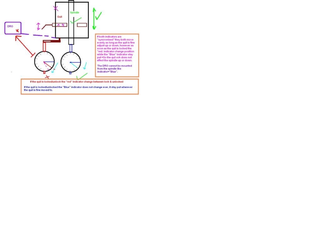

                                          Here is an illustration: This is about using the Fine Adjustment for quil/spindle.
                                          I can get the "Red" indicator close by repeatedly locking unlocking the quil, but if I unlock it, the Red indicator sags away from locked reading…If I actually mill this is worse.
                                          I am pretty sure one can trust the spindle behaviour when quil is locked and you mill, but that is not where I can mount a DRO pick up of course.

                                            Hi Chris, all I can think of is there is too much clearance in your spindle bearings, the quill and spindle should move as one, but perhaps you are chasing microns.
                                            Regards Nick.

                                                The first thing to do is check the spindle bearings are properly adjusted. Take the front trim off and you should see a tab washer and two slotted nuts. Bend back the locking tab and loosen the top nut. Then tighten the lower nut, tighten down the lock nut and bend a tab back into a slot on the nut. The bearings should be tight enough to get warm when running but not too hot to touch. I'll post a photo shortly.
                                                This shows a slot with the tab bent up into it. Loosen the top nut, bend the tab down, loosen then retighten the lower nut (there should be an obvious increase in the force needed to tighten the nut when you get metal to metal contact in the bearings). Rotate the spindle by hand to check everything feel ok. Bend a tab up into a slot (not necessarily the same tab or the same slot) then tighten down the top nut. Run the machine at high revs for a while ( 10 minutes for example) and check the bearings are warm but not hot.

                                                  Chris, thanks for posting the diagram. That makes the problem clearer now. But the solution could be more tricky!
                                                  It seems strange, as you know, that the quill can move downwards but the spindle does not.
                                                  I think Martin is right in the above post, the first think to check would be the spindle bearings. The spindle bearings should be holding both quill and spindle solidly so they move up and down together with no variation. The only movement should be the rotation of the spindle, not up and down movement.
                                                  It may be that if there is slack in the end float of the bearings, that the spindle is held in place by where it passes through the splines in the pulley at the top end that drives the spindle. Depending on how your mill works. I am not familiar with your model machine. But if there is slack in the bearings and the spindle is a tightish fit in the splined pulley that drives it, it could be possible the quill moves a small amount but the spindle does not.

                                                    Ok, I took a test cut Aliminium bar:
                                                    A-I Trusted in Mitutoyo Dial Indicator(Red in drawing) mounted to head, measuring the Quil up/down with the Fine Adjust wormgear.
                                                    B-From an in dept experiment between the two guages setup, I determend that if I got them syncroed, then chose a target measure lower it to that, the Red Guage of course not on target with Blue gauge.
                                                    -Now if I pump the quil lock lever between lock and unlock, I can step by step advance the Red Guage to the same value as the Blue guage that dont change with the Quil Lock/unlocking.
                                                    -So from this I trusted that by using the pumping action I can mill ok.
                                                    C-I remove the Blue indicator, and put the aliiminium bar in the vice & tighten/Hammer down, tighten.
                                                    D-I am now ready to chose mill a starting surface…I milled that once, back, twice, back, thrice..
                                                    —–I mark this setting as zero on Red Idicator(Mitutoyo).
                                                    —–I then move the quil up a bit, wind the X- Axis back and measure the starting diameter with Digital Calier.
                                                    The result is 39.66mm.
                                                    E-I am now ready to chose a cut= -0.066mm off.
                                                    -I carefully Lock the Quil-Pump, Unlock-Adjust, Lock-Pump, Unlock-Adjust, Lock-pump, Unlock-no adjust needed target reached.
                                                    -I carefully mil it Once, back, twice, back, Thrice, unlock adjust Quil up.
                                                    —Move X-axis way back so I can measure(Vice in centre)…
                                                    Result:
                                                    Start=39.66mm
                                                    Target=39.594mm (-0.66mm)
                                                    Measured=39.57mm………..(The 0.066, the last 6 I guessed.(Indicator-.01mm).
                                                    I think I am happy, let me know…My problem is the effort to get to that, this effort seems impractical and wrong to me.
