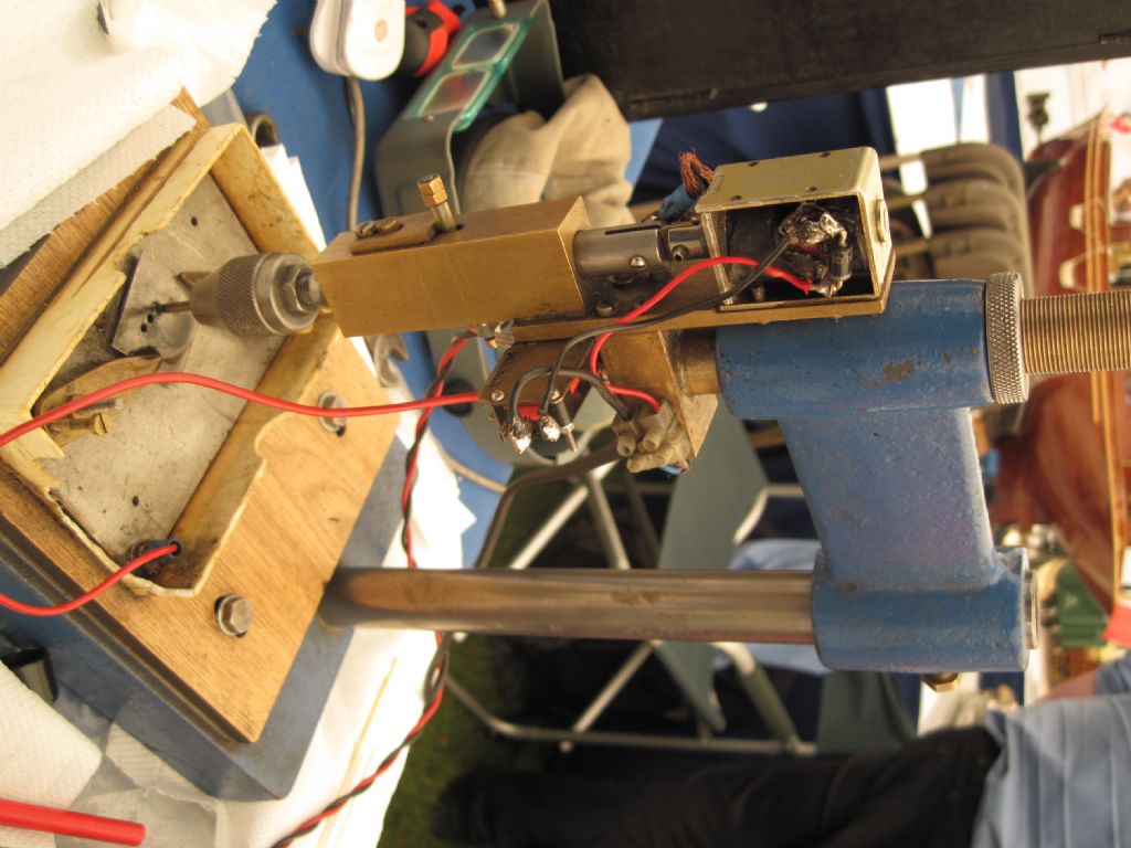

          One way would be to use EDM Chris….
          Regards,
          IanT
          #452581
          IanT
            @iant
            I saw this 'simple' EDM machine at GMES in 2016 – an electromagnet pulls the electrode up when the tip discharges through the work – sorry cannot find the details at the moment – but the gentleman who built it was very helpful and explained it for me. It would also be good for removing broken taps, making holes in HSS etc…
            Perhaps someone else will know more detail of the design…
            ( Is there a way to rotate photos? )
            Regards,
            IanT

              looks rather like the one that Maurice Fagg of SMEE used to exhibit, I know it was at Guildford for 2 years as I was also there and had to explain it to a couple of people in Maurice’s absence – works very well, will even ‘burn’ its way thru carbide – there might well be a write up in a SMEE journal

                          In toolmaking the dies for punching are wire eroded to size an a hole is spark eroded through to allow the cut wire to be threaded. They can cut through up to 6 inch of hardened steel where I worked. You should look for someone with that capacity to spark through it dosn't take long. Look for die and toolmaker.

                                        DIY EDM
                                        https://www.instructables.com/id/EDM-Electrical-Discharge-Machining/
                                        Robert G8RPI
                                        Edit.This is North American and was connected direcly to the mains supply. If trying this you MUST use an isolation transformer.
