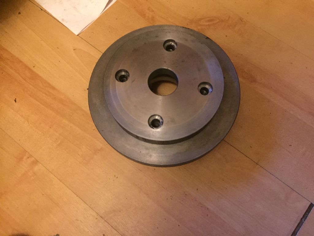

          Robin Graham
            @robingraham42208
            This is how it's ended up.
            Following advice I tried drilling CI at the lowest speed (475 rpm) on my drill press without a pilot – just spotting with a 90 degree bit (wot I had) then going through with the 135 degree 10.5mm split point. No chatter and a neat hole. So learnt something there. Thanks.
            I'd assumed that the misalignment was the result of my inexperience, but I wasn't too happy with working round the problem without understanding where I'd fouled up on my first attempt.
            I put the pieces together again (they are prevented from moving against each other radially by a register), rotated them, and found that the holes actually line up well in one of the four possible orientations. Surely that can only happen if the holes in the bought backplate aren't at 90 degrees to each other. So maybe I didn't foul up, except by taking the accuracy of the commercial product as an article of faith.
            Robin
            Edited By Robin Graham on 21/05/2019 23:52:52
            Edited By Robin Graham on 21/05/2019 23:57:25
            #410339
            Hopper
              @hopper
              Well done. You are learning the meaning of the old saying that a skilled tradesman is not one who never makes mistakes, but one who knows how to remedy/cover up his mistakes.
