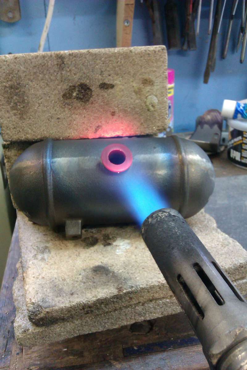

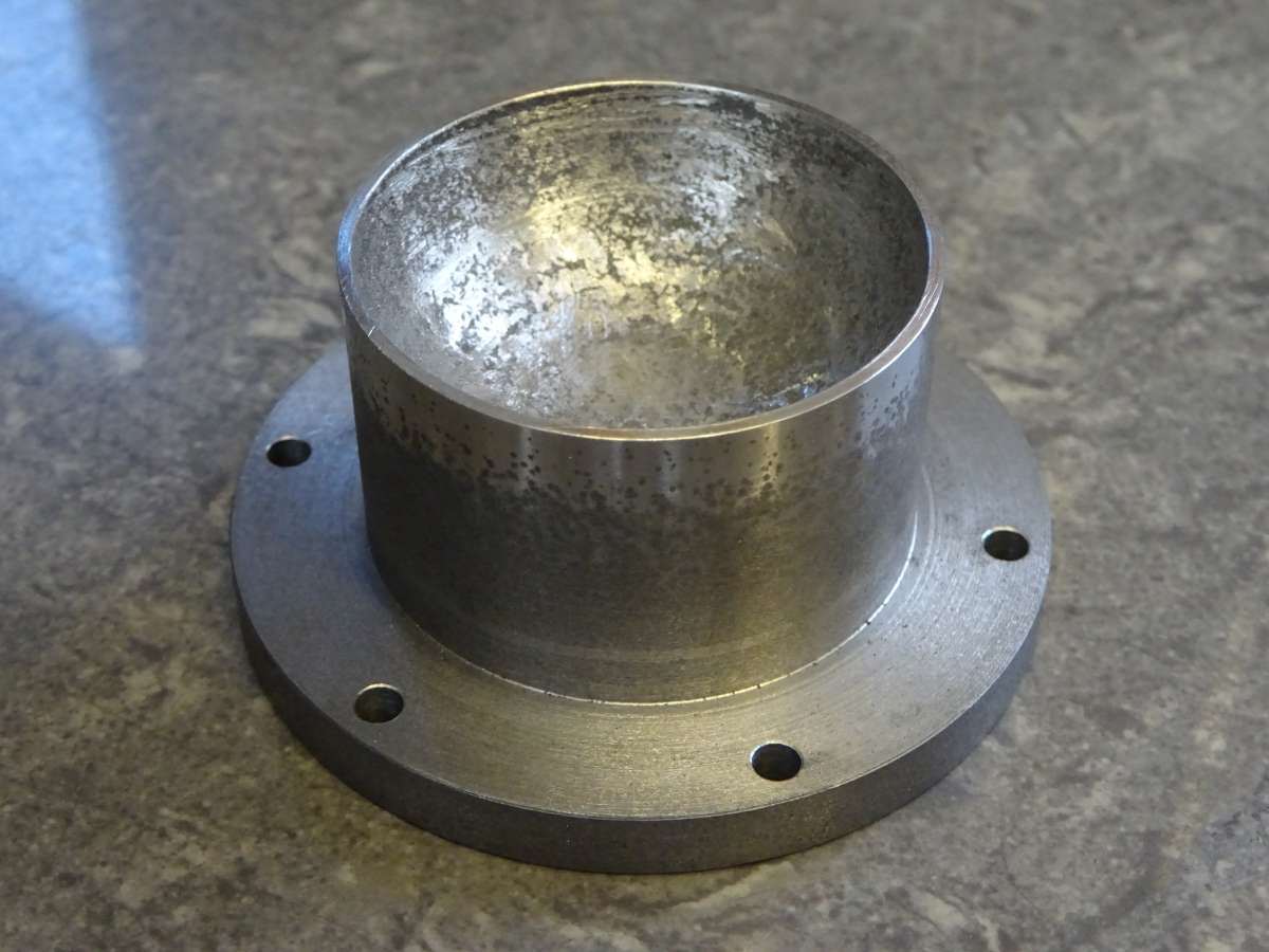

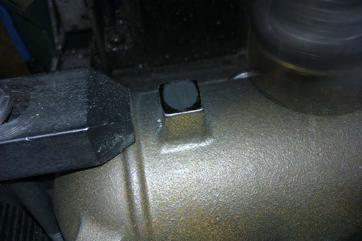

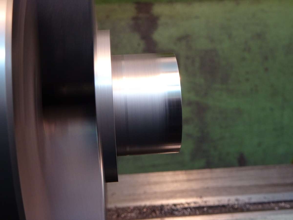

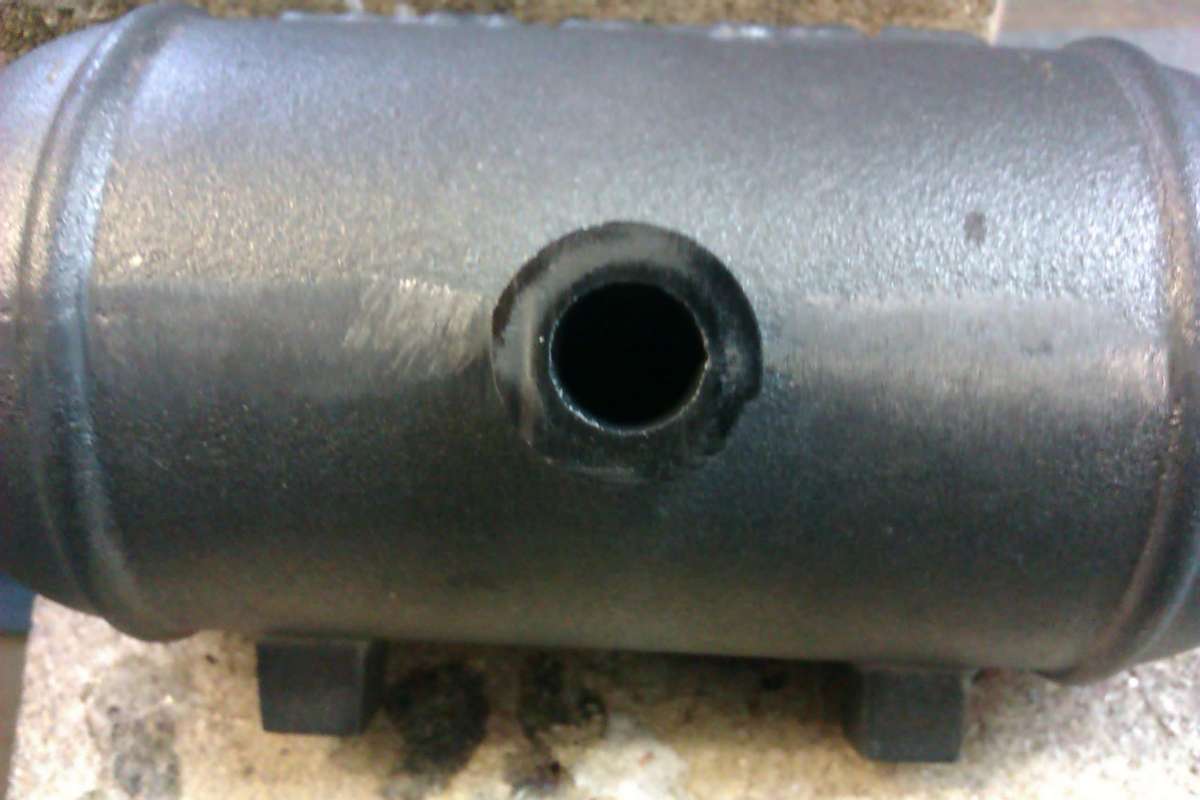

                  Couple of photos to illustrate the problem, the darker areas around the edge and in the corners are where the metal is hard as it is the extremities that cool fast and chill
                  IMAG2108
                  Flange faced with carbide but how to tap it?
                  IMAG2111
                  With the use of heat, soft enough after treating.
                  IMAG2113
                  Another example the hemi head on this cylinder end was chilled around the thin edge, the rest was OK. Just about managed to turn it with GT inserts, swarf was a long string of fine blue swarf not the usual swarf from CT until I got to the non chilled area
                  DSC03170
                  DSC03173
                  If anyone wants to read the science behind it then this post on MEM is quite informative.
