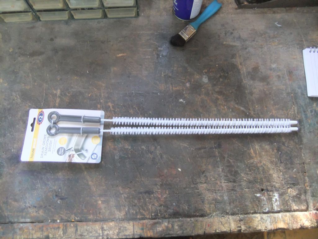

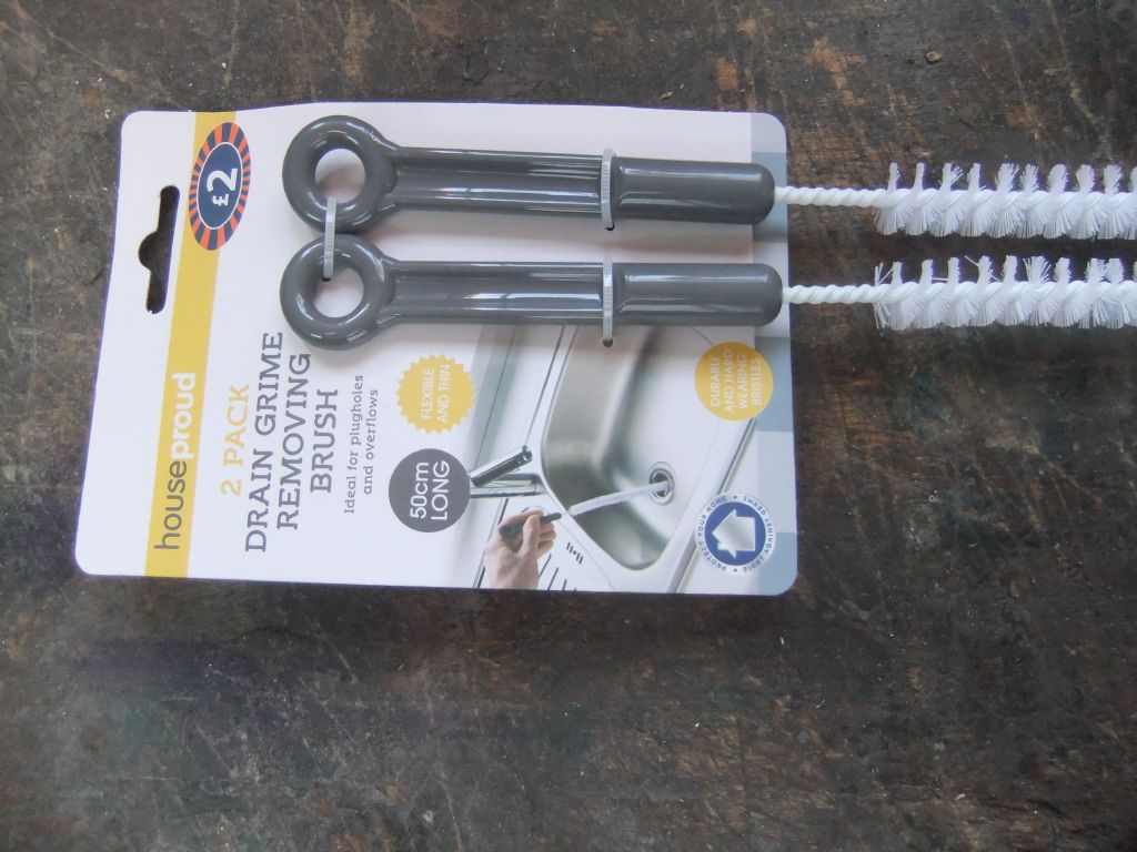

      Whilst shopping this morning I cam across a pack of two drain cleaning brushes and thought to myself (Yes I have done a lot of thinking today) that they would come in handy for cleaning out the through hole of the head stock.
      A bottle brush may do just as well
      I got them from B & M

          I use a 12 gauge shotgun brass or bristle cleaning brush

            Yes I use my 12 bore cleaning kit as well ! The brass brush does a good job !

              I would need a 54mm for My Colchester. And couple of swabbies.

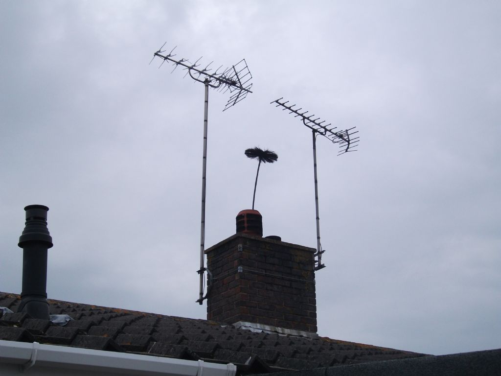

                Oh for the days of coal fires and a Flue Brush.

                        A shotgun barrel brush would need to be for at least a 4 bore for my lathe, and only just ,at that.
                        Those look OK, but I’m mystified why the bristles need to be all the way along them -150mm would be more than adequate? Shotgun barrels are generally between 24” and 32” long and I’ve never seen a gun-cleaning kit with more than a 3-4” brush head.

                          Seek out Radiator Cleaning Brushes, some of which seem to go up to that size, but not all; The one I use is 40mm on the Warco GH1330 with something like a 37mm bore.

                            Seeing that photo of the chimney being swept reminded me of my father sweeping the chimney where we lived and he kept adding canes. The brush managed to bend down level with the gutter. He was very lucky to get the lot back down the flue without breaking the chimney pot.
                            I have a set of the small mixed sizes from ebay, the smallest is about 1/16" and the biggest is 1".
                             The Smart & Brown model A has a 63/64", 25mm spindle bore. A brush would work best if it could be pulled right through from the right hand end and then cleaned before repeating.

                              +1 for one of these, they all seem to have a threaded end to attach a rod of your desired length to pull through the headstock bore. 12 gauge seems ideal for the 2 morse taper on my Myford . The self ejecting tailstock taper is more of a problem at it tends to push any debris up the taper which either needs the shop vacuum or the barrel removing to clear out the rubbish.
