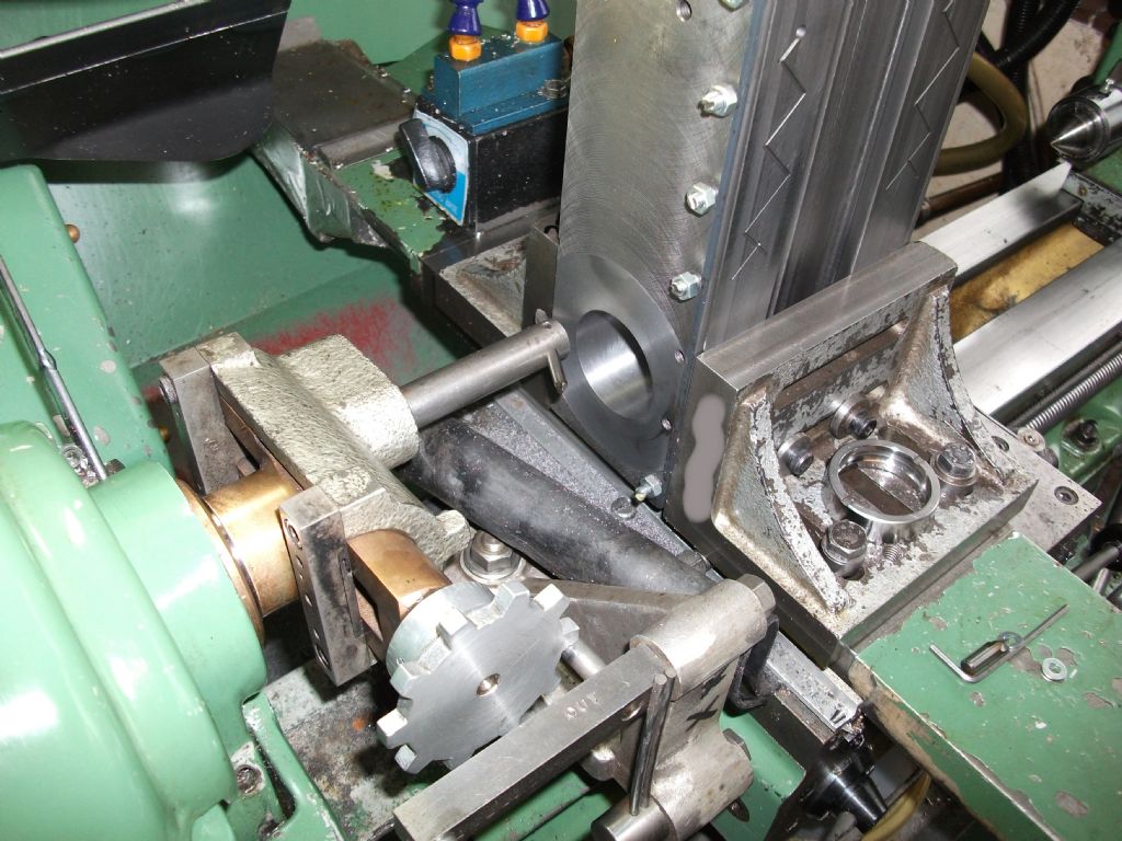

          Hi
          I guess this is what you have ,there is not too much needed in setting
          up, the bracket holding the pins should be central around the star wheel.
          Usually best to revolve the machine by hand to see the pins engage
          cleanly with the wheel. I use mine on the Myford 7 only on the 2 lowest
          back gear speeds ,if you try to go too fast the pins knock out of
          engagement ,useful bit of tooling.

                    Hi Colin ,
                    The two parallel bars are piano wire and provide some spring pressure to bear against the square bar that holds the driving pins,the tension is adjusted so the boring head moves and when the head reaches its limit of travel the spring is overcome and the drive knocks off.

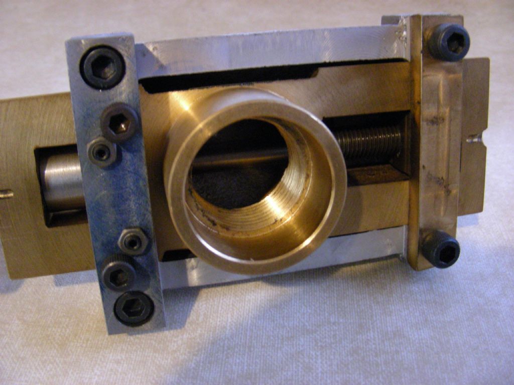

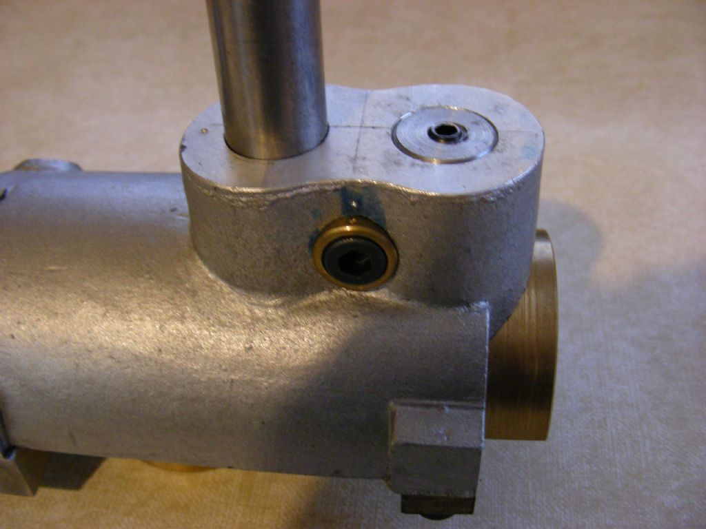

                          Thanks for the helpful photos of the advancing bracket. The GHT mods can be seen here:
                          and here:
                          He was perhaps a little hard on the Dore design and, justifiably, proud of his own precision boring head. Arnold Throp's idea was to produce a slide that could be made without milling facilities and the kit came with the bronze casting already screw-cut for the lathe spindle.

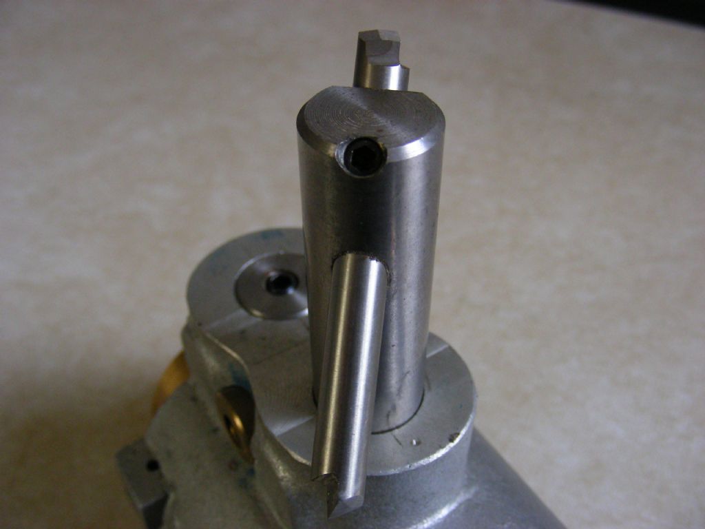

                            Speaking of helpful photos, thanks. Having seen these, you tantalisingly left out any image of your boring bar…? I have details in drawings, but wonder what you are actually using?
                            Cheers, Colin

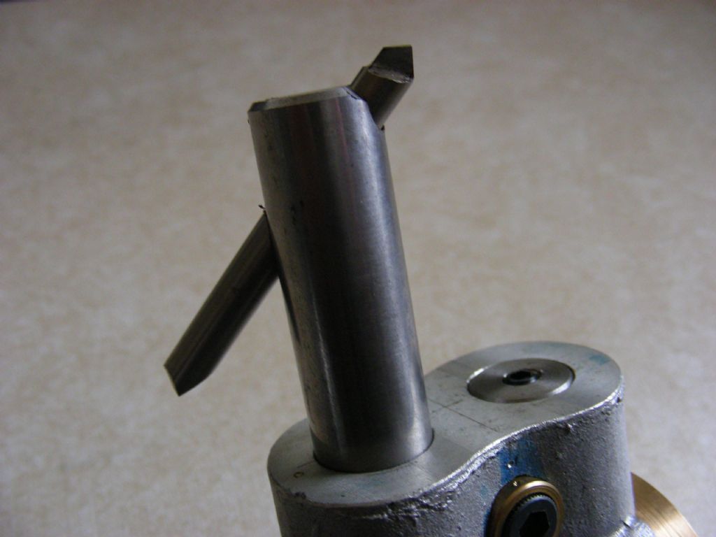

                              In the earlier photos there was no cutter in place so for the purpose of the photos below I have just picked one out at random and installed it. The bar and cutter are entirely straightforward and made to GHT's words and music.
                              BTW, I am not sure that ETW had anything to do with this; the DW mill was, of course, a development of ETW's work and something of an ME milestone.

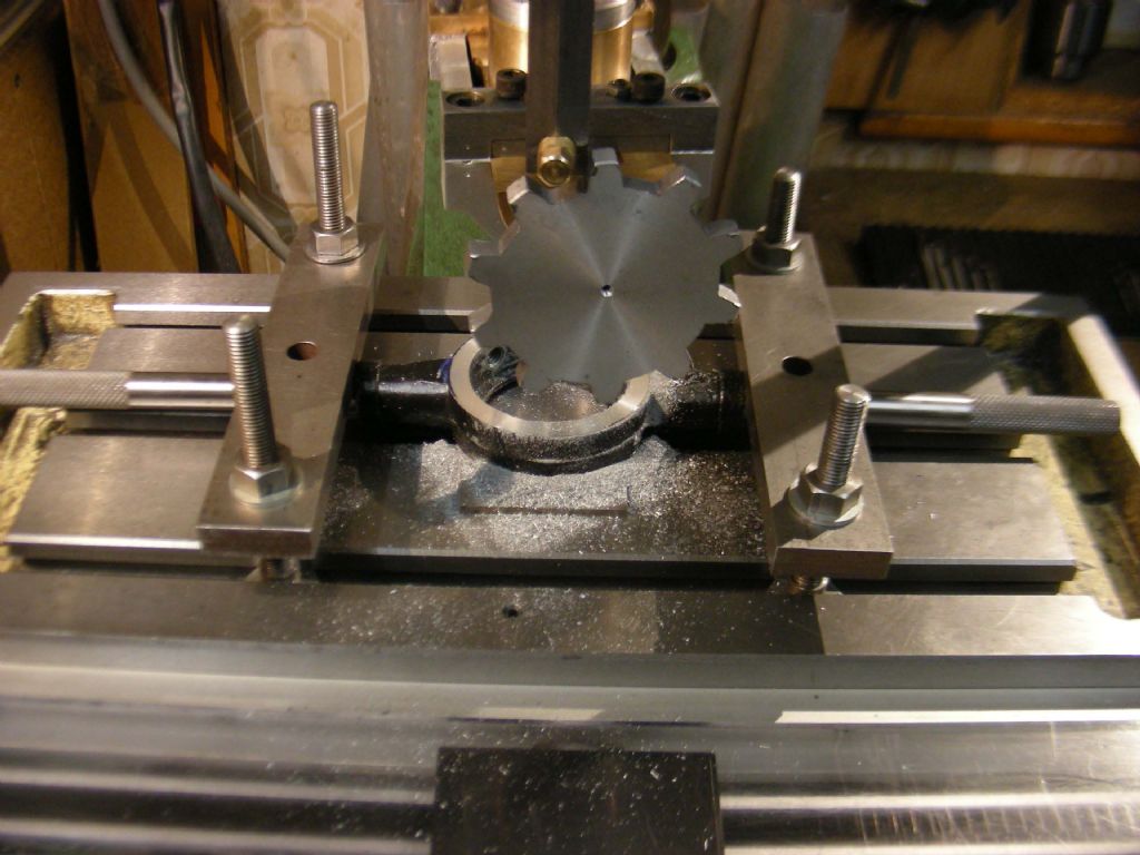

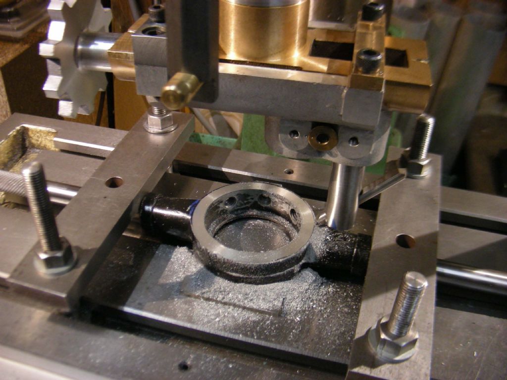

                                  Hillclimber:
                                  Did you get your Dore BFH done?
                                  I had an opportunity to use mine recently in the mill/drill:
                                  I am facing the rough casting of a pair of die stocks with a view to adding a pilot to aid square threading. All seemed to go well until I loosened the clamps and found that the die-cast body had cracked across one of the screw holes! I had originally thought to use a large, thick washer and bolt in the body but, being wary of single point clamping, had opted for the setup shown. In hindsight, I should have used the bolt and washer but with stops either side of the handles.
