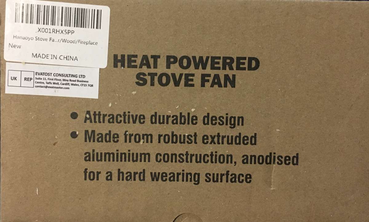

                            If we are actually considering a circulating fan for a heating stove in a small room, then the obvious choice would seem to be something like this:
                            IMG_0373
                            Edit: __ I bought one to play-with [sometime]
                            A fancy extrusion supports a small electric motor that powers the bladed fan
                            Electricity is provided by a Peltier element so, when the stove is up to temperature it is self-sustaining.
                            A more substantial version should be a nice project.

                                        Thanks for finding the example, Michael.
                                        My son and DIL have one of these atop the wood stove in their living room.
                                        They’ve had it a few years now.
                                        It starts automatically as the stove heats up, works well at distributing the heat and AFAIK has given them no trouble.
