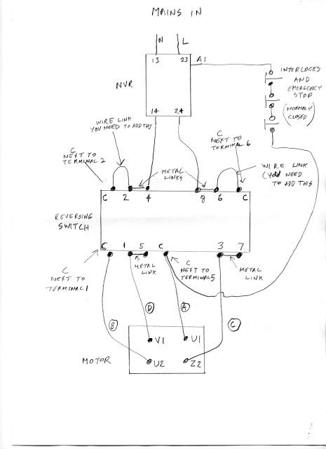

            Les Jones 1
              @lesjones1
              Hi Kevin,
              Before you wire the switch as in the diagram below confirm the following.
              1 That there are no links on the opposite side of your switch to the one in your picture of the switch
              2 That the connections between the "C" contacts are between the (C next to terminal 1 and the C next to terminal 2) and (C next to terminal 5 and the C next to terminal 5) Also confirm these contacts are only closed in the clockwise and anticlockwise positions and not in the middle position.
              3 Confirm there is no contact between the "C" terminal next to terminal 1 and the "C" terminal next to terminal 6 in any position of the switch
              You will need to find a way to connect two wires to the "C" terminal next to terminal 5 You may be able to use an eyelet connector on one of the wires on the screw for that terminal or use a piggy back push on connector.
              If there is anything on the diagram you don't understand ask. If you don't understand the diagram would you like it in the form of a list of instructions. If you would like a higher resolution scan of the diagram than can be put on this forum then PM me with your email address and I can send it to you
              Make sure you do not disconnect any earth wires and if you mount the NVR switch and/or the reversing switch in a metal box make sure it is earthed.
              Les.
              #186734
              Nicholas Farr
                @nicholasfarr14254
                Hi Les, I did a diagram last evening, using the information from Ketan's and Kevin's photos, which has the same result, albeit wiring it a different way, but I may have the F/R positions the opposite way round, although swapping a couple of wires will put it the same. I haven't included the interlocks or the A-D wire designations that you have as I gathered you would set it out in a way that Kevin should be able to follow OK. You can see my diagram here if you wish **LINK**. I've only done it to see if I could get much the same result as yourself.
                Regards Nick.

                #186749
                Les Jones 1
                  @lesjones1
                  Hi Nick,
                  I agree. There are a few variations that could be done to achieve the same result. I think we have both got forward and reverse the way Kevin wants it. (If it was for myself I would not bother working it out. I would have just reversed two wires if it was wrong.) I was wrong in my post on the 16th at 12:20 when I said that I thought the new switch only had one pole to isolate the main winding. It is a strange coding system with four terminals being labelled "C" I have taken the live feed to the maintainer coil in the NVR via one set of "C" contacts so if the reversing swtch is moved through the centre position it will cause the NVR to drop out. I did think of suggesting that Kevin labelled the switch end of the motor cable with A to D but decided it might cause confusion in the future with someone thinking wire C should go to terminal C.
                  Les.

                      #186766
                      Nicholas Farr
                        @nicholasfarr14254
                        Hi Les and Kevin, Les I think it is very prudent the way you have connected the maintainer coil and I think I would have done it in much the same way, because although the new switch can handle the electrics, I don't think the new switch is physically robust enough for the constant use that the lever would put on it and it may not stand the starting load for very long when used in the same manner as the original one.
                        I have purchased the other switch that Ketan showed in his photos, it is pre linked the same, although the switch on mine is still working, my machine is getting on a bit and now I have a replacement if it should fail.
                        As far as mounting the new switch, it would be possible to mount a box to hold the switch and the NVR, where the lever is fitted, but due to the length of the switch it will be a bit sticky out. I think it would be better to fit it in the original hole and make a plate for the new switch big enough to pick up the bolt holes that held the lever in place, but then Kevin would probably have to mount his NVR in a suitable box and mount it in an appropriate place. He may be able to fix the box somewhere close to the new switch, but will have to be a choosey where to drill new holes for fixing it.
                        Regards Nick.
                        #186796
                        kevin large
                          @kevinlarge76611
                          Hi les
                          I was just wondering if the NVR has an emergency stop and I don’t have the interlocks do I need the wire c to a1
                          kevin
                          #186797
                          Les Jones 1
                            @lesjones1
                            Hi Kevin,
                            You need the wire from C (Next to terminal6) to A1 for the NVR switch to remain on after pressing the start button. Anything that breaks that connection caused the NVR to drop out. At the moment just wire in the emergency stop button. (The contacts on this will be closed until it is pressed) You can add any number of interlocks in the future. If you do not even want to wire in the emergency stop button then just link from C (Next to terminal6) to A1 for the NVR switch
                            Les.

                            #186854
                            kevin large
                              @kevinlarge76611
                              Hi les and nick you will be glad to know lathe is working perfectly thanks guys could not have done without you thanks again just have to master cutting threads on it next
                              kevin

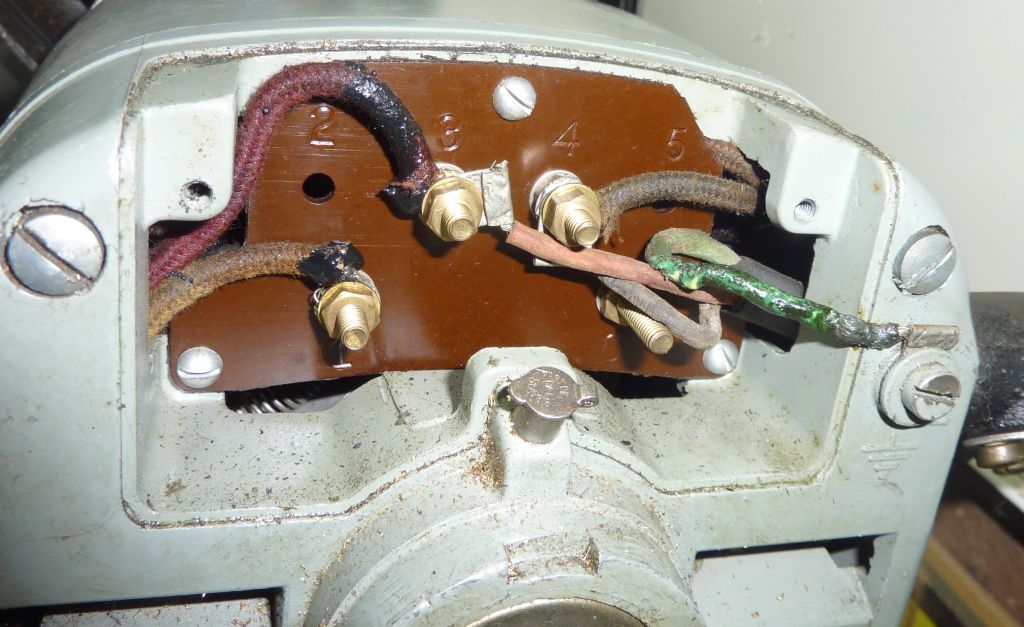

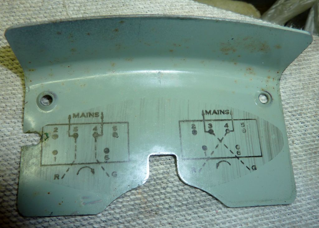

                                    #187026
                                    Raymond Sanderson 2
                                      @raymondsanderson2
                                      Just following this as I have an ML7 reveres switch NOT usual type but similar to fit and considering maybe sourcing a newer type more compact and easier to fit…….maybe.

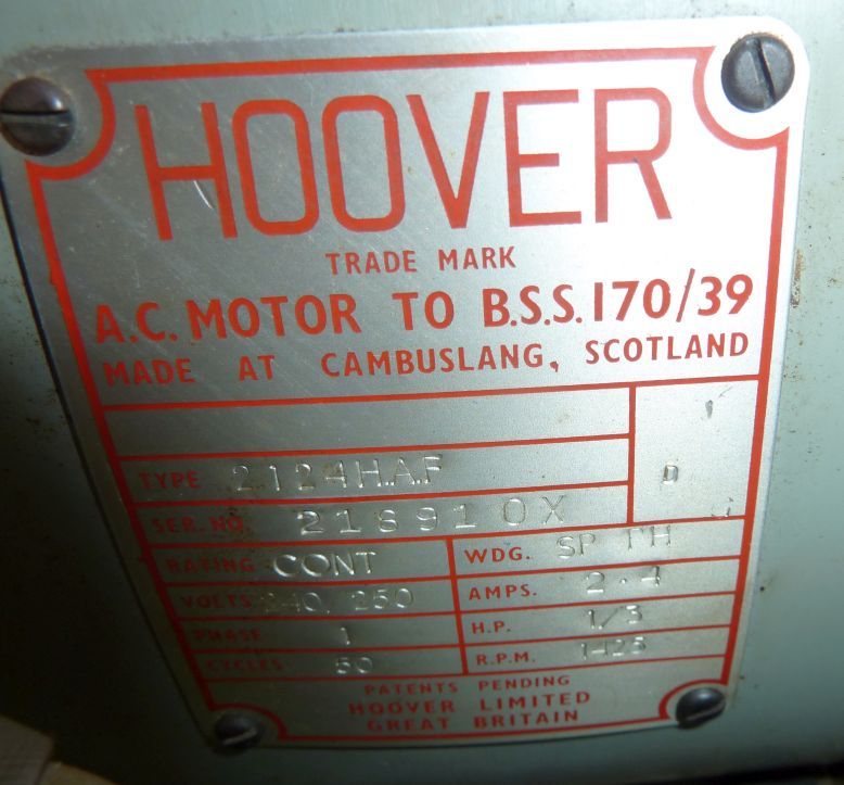

                                        #187175
                                        Raymond Sanderson 2
                                          @raymondsanderson2
                                          Posted by Les Jones 1 on 20/04/2015 09:18:09:
                                          Hi Raymond,
                                          A Myford owner admitting to having a reversing switch other than a "Dewhurst" I thought that was against their religion or some unwritten law. (I'm sure JS will know the details.) Back to being sensible. Although the two switches That Arc Euro Trade sell are suitably rated they may possibly not be suitable for switching under load as seems to be the case on a lot of Myfords. They only seem to have the reversing switch. I would recommend fitting an NVR switch or proper motor starter for stopping and starting the lathe and just operate the reversing switch when the motor is stopped.
                                          Les.
                                          Hi Les
                                          Yes i should hang my head in shame I know but at $25 it was a bargain having seen them on ebay at $150+ ouch. It wa suggested a NVR switch be fitted by the President of Hornsbey Model Rail club after he did work out wiring set up for the switch and motor I have fitted which was on the lathe when I purchased it.
                                          To me the NVR will be the better install for my use and space.
                                          Here are photos of the switch (I'll take one with it open latter) the motor and info on it.
                                          If I am hijacking this thread I apologise happy to have it moved.
