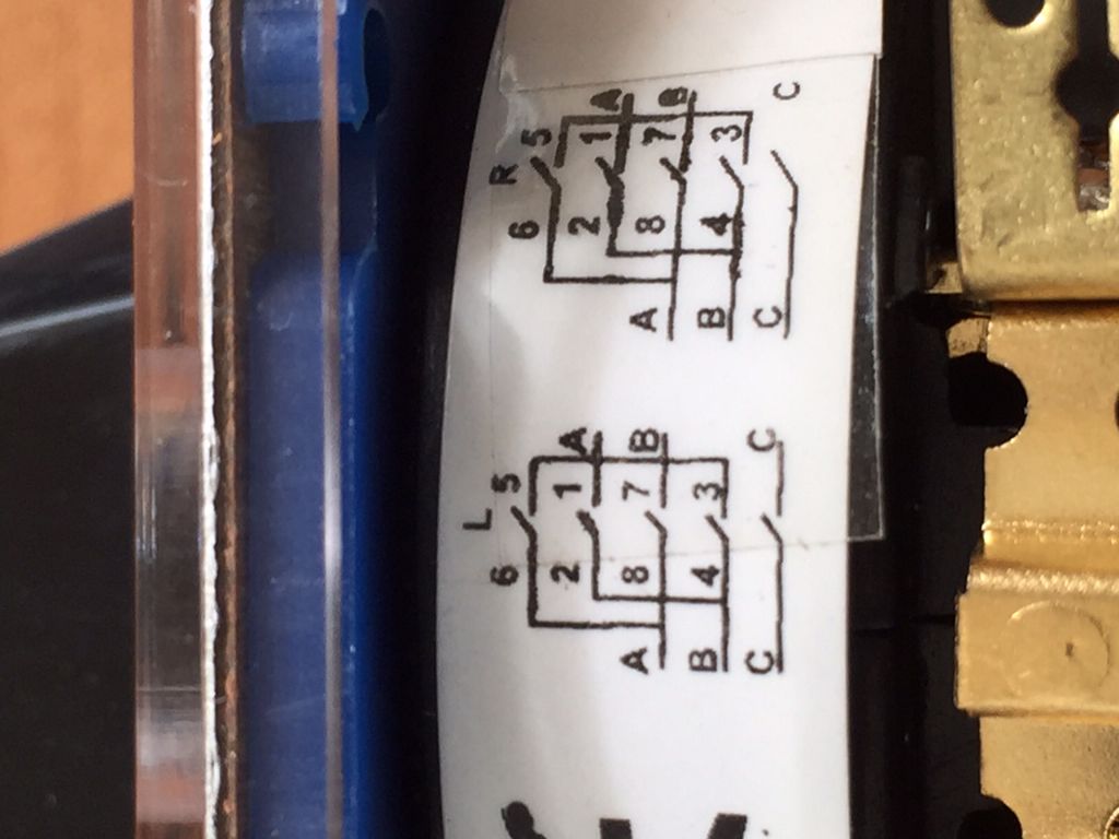

      Hi Kevin,
      If 200 ohms is the lowest resistance range then use that. The readings I expect are less than 1 ohm. NOTE in my last post I initially said to set the switch to reverse. I should have said forward. Is the switch behind the big lever on the headstock as shown on the picture that Nick posted of the Warco 220 ? If it is then it will probably be difficult to get a switch that can be used with this lever.
      Les.

        Les Jones 1
          @lesjones1
          Hi Kevin,
          The problem with the switches on ebay is they do not give full details of the contact arrangement so it is not possible to be sure they are suitable. As I do not even know which country you are in I do not know which suppliers to suggest. I suspect you could fit a new switch in the same place as the original by just making a new mounting plate but you would only have a knob on the switch rather than the lever.
          Les.

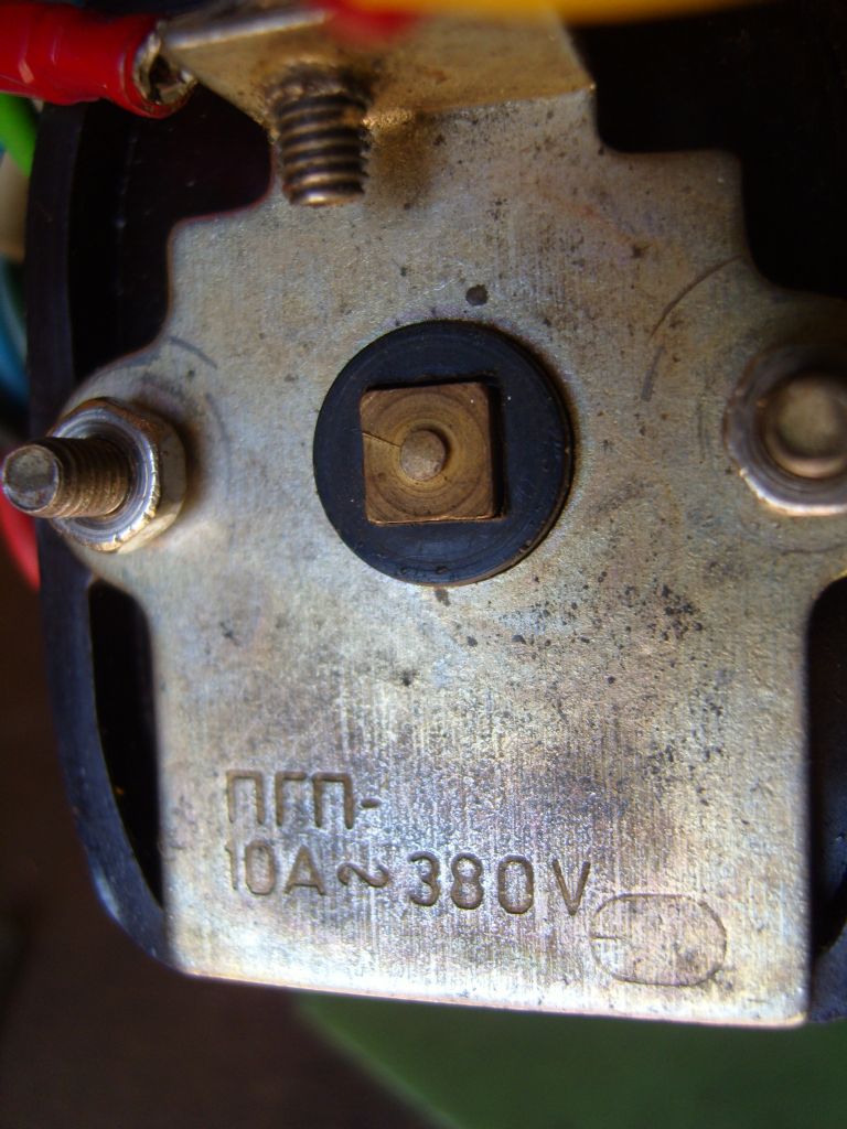

              #186439
              kevin large
                @kevinlarge76611
                Hi led
                A. L 20 N 2.5
                B. L 3.8. N 12.
                C. L 4.5. Ñ 125
                D. L NC. N. NC
                hope this helps again with the switch out I can get forward and reverse I do have to wiggle the lever for it to work sometimes
                I've looked at the switch you recommended I will contact them today to see if I can find out more about it
                Kevin
                #186445
                Les Jones 1
                  @lesjones1
                  Hi Kevin,
                  Your results confirm that the switch is faulty. The contact on the switch between terminals 7 & 8 is totally faulty. The resistance of the other contacts is a bit higher than I would expect. (I should have asked you to check the resistance of your meter test leads so that value could be subtracted from the readings.) Although Ketan and the others staff at Arc Euro Trade are extremely helpful I would not expect them to be be able to supply the information about the switch. If you were using it to replace the switch on A Seig C6 It would be just a matter of swapping the wires over from the old switch. I have managed to find some wiring diagrams for the C6 but non show the the labelling of the switch connections. They do show that the switch is functionally the same as your switch.
                  Les.
                  #186452
                  kevin large
                    @kevinlarge76611
                    Hi les
                    I took a look inside the switch it just fell apart lots of broken bits
                    I have telephoned about the the switch you said about and they confirmed what you said about diagram I will have a search and see if I can get 1 with diagram if not will try the 1 you said about
                    kevin

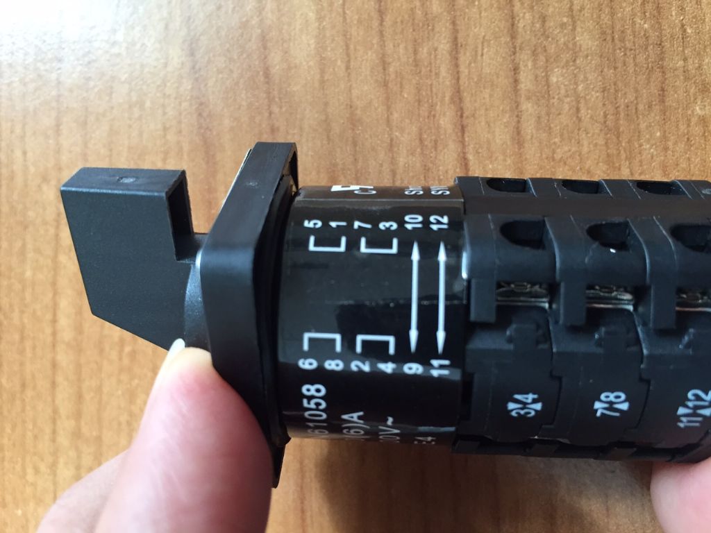

                      #186462

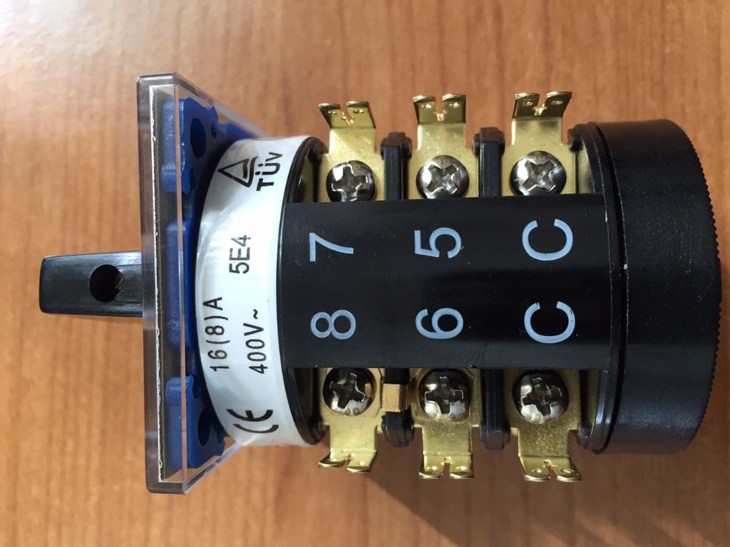

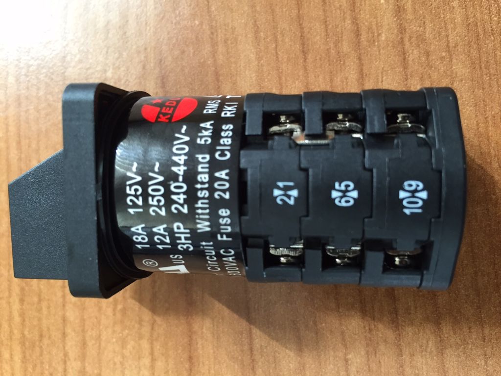

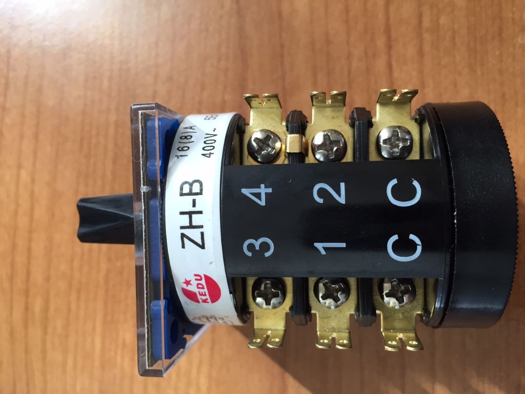

                      Ketan Swali
                        @ketanswali79440
                        Kevin and Les,
                        Came in a little late to this thread. Our Ian has informed me of his conversation with Kevin. Here are some close up pictures of parts C3-181 switch and C6-205. Don't know if they are of any help. They are also in the album, if you cannot see the details more clearly as part of this thread.
                        C3-181:
                        C6-205:
                        Ketan at ARC.
                        #186463
                        Les Jones 1
                          @lesjones1
                          Hi Ketan and Ian,
                          Thank you very much for going to the trouble of taking the pictures. Both switches would do the job but the last picture of the C-205 switch shows exactly how it works. This will save trying to talk Kevin checking the switch with his multimeter. (Kevin has very limited electrical knowledge.)
                          Once again an example of your superb customer service.
                          Many thanks again
                          Les.
                          #186465
                          Les Jones 1
                            @lesjones1
                            Hi Kevin,
                            As you can see from my last post to Ketan the C6-205 switch will do the job without you having to do a lot of testing on the switch. The only functional difference to your existing switch is that it only breaks one pole to the main winding. This is not a problem. While you are making these changes it would be worth fitting an NVR switch.As well as a safety feature this will extend the life of the reversing switch as it would not be operated under load. It would also allow you to connect the interlock switches and emergency stop button. (With the right type of NVR.) I have found this one on ebay that would allow the use of the interlocks. I could not find any listed already mounted in a box that would allow the use of interlocks.
                            Les.

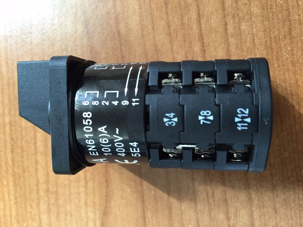

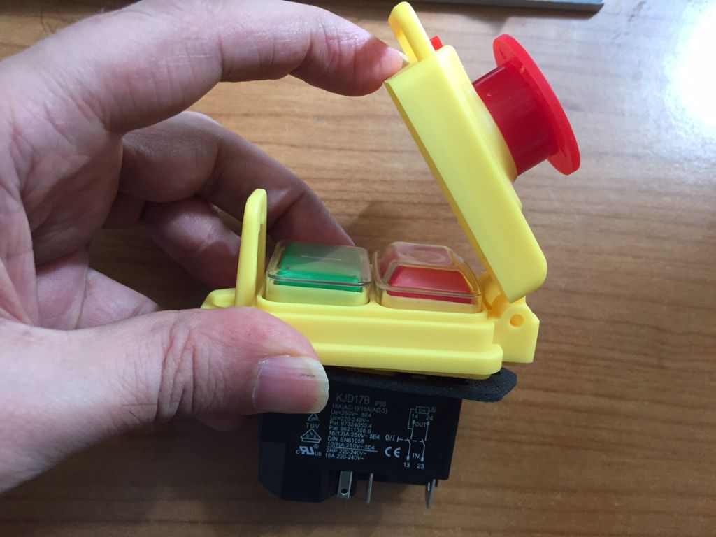

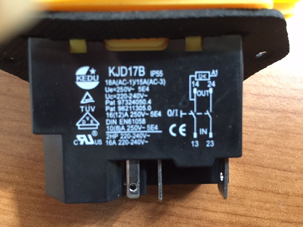

                            Nicholas Farr
                              @nicholasfarr14254
                              Hi Kevin and Les, I agree either of the switches that Katan has shown should be OK, as the original one is rated at 10A 380V these are easily capable of carrying the required load.
                              Switch Rating
                              Warco do an NVR containing an emergency stop button also, all contained in a box ready for mounting. **LINK**
                              Regards Nick.

                              #186470
                              Bazyle
                                @bazyle
                                If you are left handed you might want a switch that is the other way round cool
                                Also helps for modern people who are too stupid to work out what the big red button is for.
                                #186474
                                Nicholas Farr
                                  @nicholasfarr14254
                                  Posted by Bazyle on 15/04/2015 12:46:20:
                                  Hi, and almost £10.00 cheaper to boot.
                                  Regards Nick.

                                    #186482
                                    kevin large
                                      @kevinlarge76611
                                      Thanks all switch and nvr ordered
                                      kevin

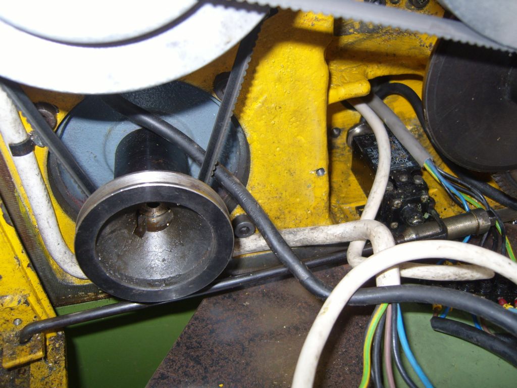

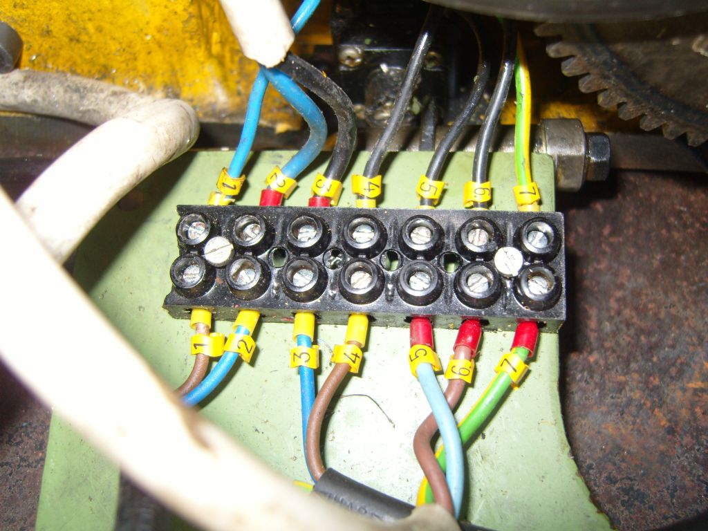

                                        #186528
                                        Nicholas Farr
                                          @nicholasfarr14254
                                          Hi Les and Kevin, Les your mention of the interlock switches has prompted me in thinking that my original belief that the flex on Kevin's lathe that went into the original contactor box has been changed, because looking at his second photo down of his F/R switch and the connection block, there seems to be a lack of wires connected into it. It seemed to be a bit empty compared to mine but nothing has dawned on me before, my connection block has all the interlock wires connected into it and the flex coming from the contactor box is a five core one, containing three black wires, one blue and a green/yellow.
                                          Wiring Connection Block
                                          On the top row Nos. 1 and 4 are the interlock wires that trip the contactor, Nos. 2 and 3 are from the emergency stop at the tailstock end of the lathe bed, Nos. 5 and 6 are live and neutral from QF1 and 7 is earth.
                                          On the bottom row Nos. 1 and 2 are the chuck guard switch, Nos. 3 and 4 are the gear/belt cover switch and Nos. 5, 6 and 7 go to the F/R switch. In the photo below can be seen the switch that is operated by opening the gear/belt cover acted by the rod that runs along the bottom and is anchored in the bracket of cover at the left hand side. The black flex behind the V belt goes up to the chuck guard switch,
                                          Gear Cover Interlock Switch
                                          I don't know if Kevin's emergency stop actually works, but if it does, it probably only cuts the live side and if it is reset without the F/R lever returned to the stop position, the lathe will restart straight away, which is very dangerous. I don't see any evidence of a chuck guard of gear/belt cover switch on Kevin's lathe, so interlocking will be very limited, might be a good idea if Kevin checks for any switches of any kind.
                                          Regards Nick.
                                          Edited By Nicholas Farr on 15/04/2015 18:39:53

                                                    #186663
                                                    kevin large
                                                      @kevinlarge76611
                                                      New switch arrived today fantastic service from arch if les or nick would be kind enough to tell me what wire goes where with a little diagram maybe good
                                                      The var is on the way I guess that just goes in in between the switch and the plug ?
                                                      Kevin
                                                      New switch
