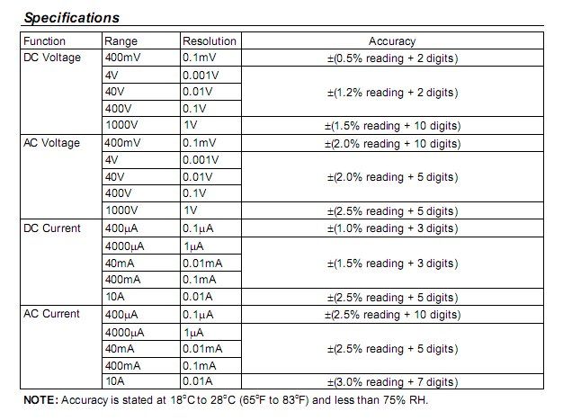

                                Those figures don't match their catalogue Neil
                                **LINK**
                                My AVO used to get checked regularly Neil along with a lot of others. The error used to be added to a label on it on one range. The scales are organised to get round the low deflection errors.
                                Andrew does have a point after a fashion. Analogue multimeters are arranged to measure with a certain resistance per volt so the input resistance varies according to the range that is set. DMM's have a constant input resistance usually 10 meg ohms what ever range they are in. That makes them much more prone to picking up noise even via the leads. However some meters clearly take steps to get round that. On modern day electronics the current drawn by an AVO when it's measuring voltage is often too high as it interferes with the reading. The old way of getting round that problem was to use bridge circuits adjusted so that there was no current drawn when the voltage reading was taken.
                                angelClearly we all need to use £17 quid Drapers as some Flukes don't meet that spec.

                                    Well, the figures I gave agree with the manual http://www.drapertools.com/products/manuals/60792ins.pdf
                                    Fluke's meter cleaning wipes cost more than a cheap multimeter!
                                    Their low accuracy models (3%) seem to be the auto-ranging ones, 0.5% is pretty much the de-facto standard for cheap DMMs; even the A2D inside an AVR chip has a basic accuracy far better than that so I don't doubt that it's easily achievable for cheap consumer items.
                                    Truth is, hobbyists got by fine on analogue meters inferior to the AVO8 (I have an Eagle K1400), and I very much doubt anyone outside a lab really needs the accuracy digital meters offer.
                                    But I last used an Avo 8 nearly forty years ago, so what do I know?

                                        The idea that a hand held(?) DMM with flying leads could meaningfully measure anything to 0.1% or better is fanciful. I suspect the published "accuracy" numbers are just lazily calculated from the number of bits in the ADC. 12-bit would be 0.024%, 11-bit would be 0.05% and 10-bit would be 0.1% in this mentality.
                                        Even for a high quality bench instrument or embedded ADC, getting the last bits of a 11 of 12 bit ADC to behave is pretty tough. As for calibration of these meters, who here actually gets their DMMs calibrated each year and what possible hobby activity would require that?
                                        Back to the original question, you don't need a "proper" yellow thermocouple socket as long as the connections are at the same temperature and of similar metals. But same question – what possible requirement is there for deadly accuracy – and how would you know if it was correct anyway?

                                            The figures I found quoted ranged from 0.5 to 2% +/- a digit or two, which I'm happy to believe for a 10-bit DAC.

                                                Yes, that's a bit more realistic. Apart from the resolution, you have to allow for the tolerances, ageing and temperature coefficients of the reference, ADC, various potchains etc – and the actual calibration itself. And that's before you think about noise.

                                                  The spec's vary in content as well. This is for the one I bought
                                                  It gives a temperature range for one and accuracy varies in the same mode. As would be expected. In some ways it's worse than some 2000 count DMM's but it's a 4,000 count so really that depends on what is being measured. It's common for digit error to be larger on high count ones. It's true RMS so another bit in the way. More bits add errors so that wins in some respects and looses in others. !0A isn't too good really. That range usually uses a separate shunt. Difficult to fit one in a small meter. I have a 100mv / amp one and it's about 4in long and heavily built to minimise heating effects. I used to need that sort of thing at home.
