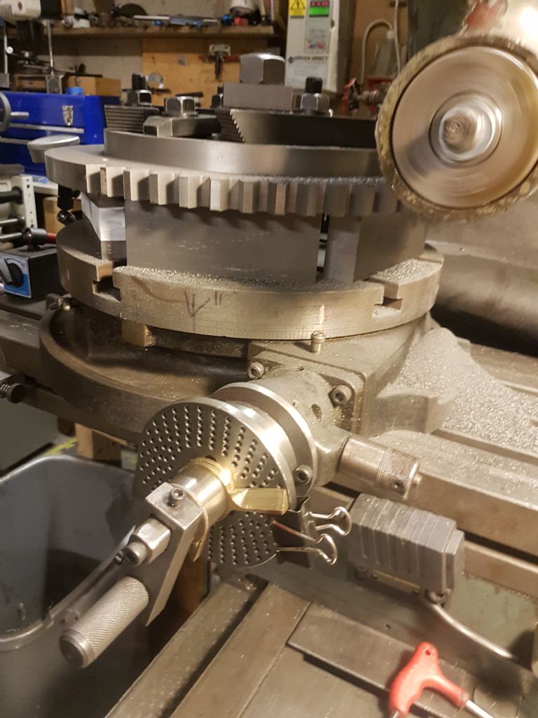

                              These final drive gears have 72 teeth, so each increment is a handy 5 degrees, although I still needed a spreadsheet as one rotation of the handle is 4 degrees.
                              As John says errors are reduced by the ratio of the worm. One complete turn of the handle (360 degrees) only turns the table 4 degrees. Let's look at the maths. My gears are 72 teeth and 5DP do the PCD is 14.4", giving a circumference of 45.239". Consider a position error of 5 thou on the circumference. There are about 9047.8 5 thou arcs on the circumference. Each 5 thou arc represents an angle of 0.0398 degrees. On the handwheel that is represented by an error of 3.58 degrees (multiply by 90). I would think that is doable. But 0.0398 degrees is about 2.38 minutes of arc. I doubt my no name rotary table accuracy is much better than that anyway.
                              There is at least 5 thou backlash on my final drive gears, but I suspect that is more related to slight over cutting of the tooth depth. When I got back to the original cut the cutter went through with barely a sound, as one would expect.

                              #395361

                                Anonymous
                                  Posted by Emgee on 08/02/2019 22:25:12:
                                  Andrew, does the mill have a powered knee or did you have to crank all of those cuts ?
                                  Nope, all done by hand. I actually cut six gears, four for my two engines and a mate who is building the same engine just 'happened' to have his two blanks ready at the same time. That makes 432 teeth; 12 turns down and 12 turns up for each tooth. That's a lot of handle w**king. I could do about half a gear at a time before needing tea and biscuits.
                                  Andrew

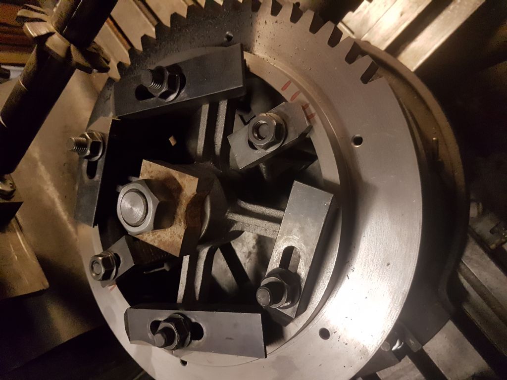

                                        Mark Simpson 1
                                          @marksimpson1
                                          Quick progress update…
                                          I found that the dividing plates from a 6" table had a big enough bore (22mm), so made a mounting for them on my 14" table, made a new handle for it and it seems to work fine. Stepper motor route would perhaps have been better in the long run but I already had the plates for the 6" and decided to go for it (and not spend 100+quid)
                                          Then had to lift the gear blank off the table, and after investigating the price of 4 off 2" tall parallels I bought 3' of 2"x1" mild steel bar and added 5 thou of shim in 2 places (it's a one off setup after all). Added 6 clamps and a 1" whit stud and started cutting teeth
                                          It seems a very solid setup, and have been able to cut the 4DP, .539" deep teeth in one go
                                          as Andrew mentioned, it's a lot of handle winding, but very satisfying
