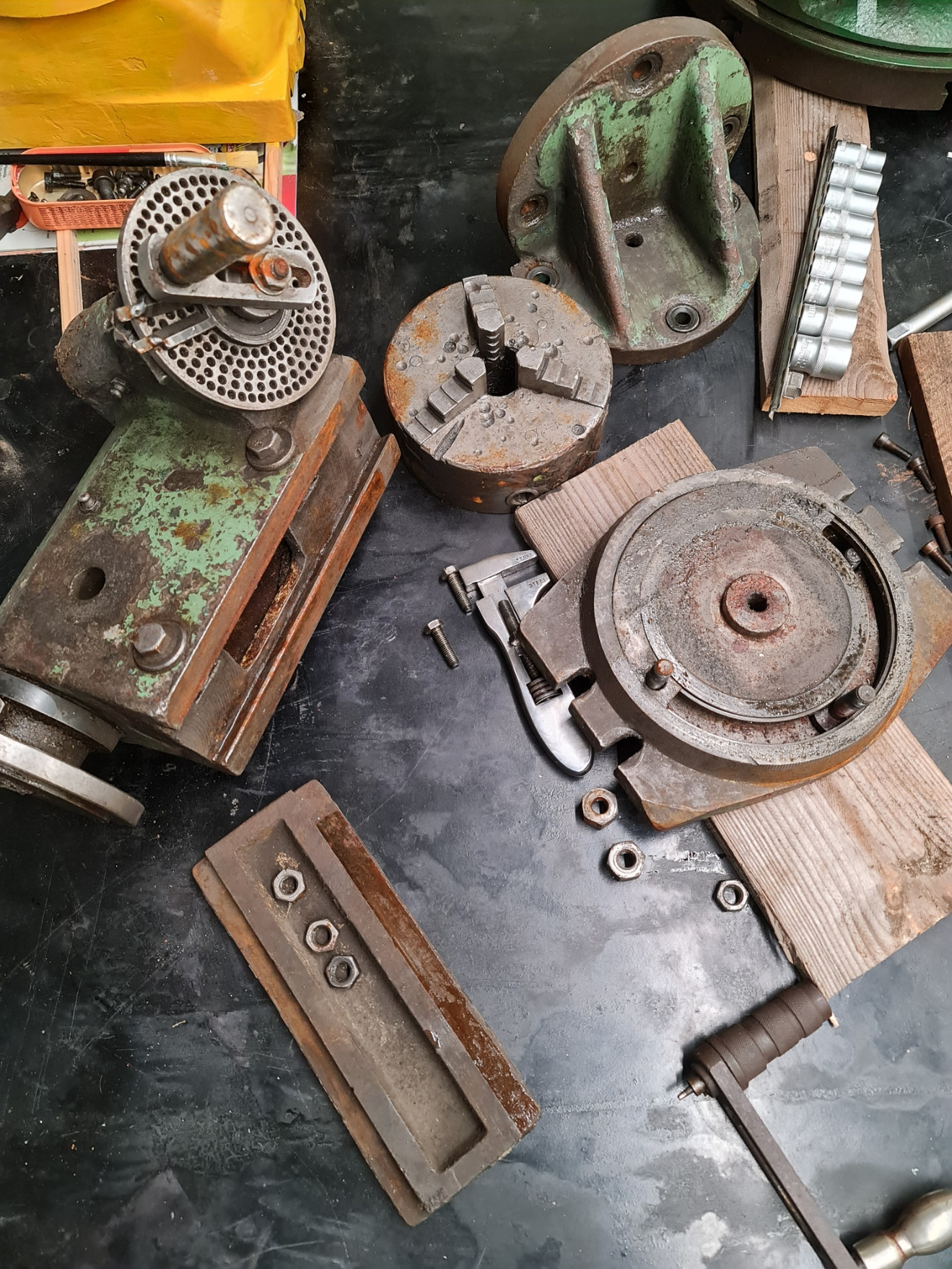

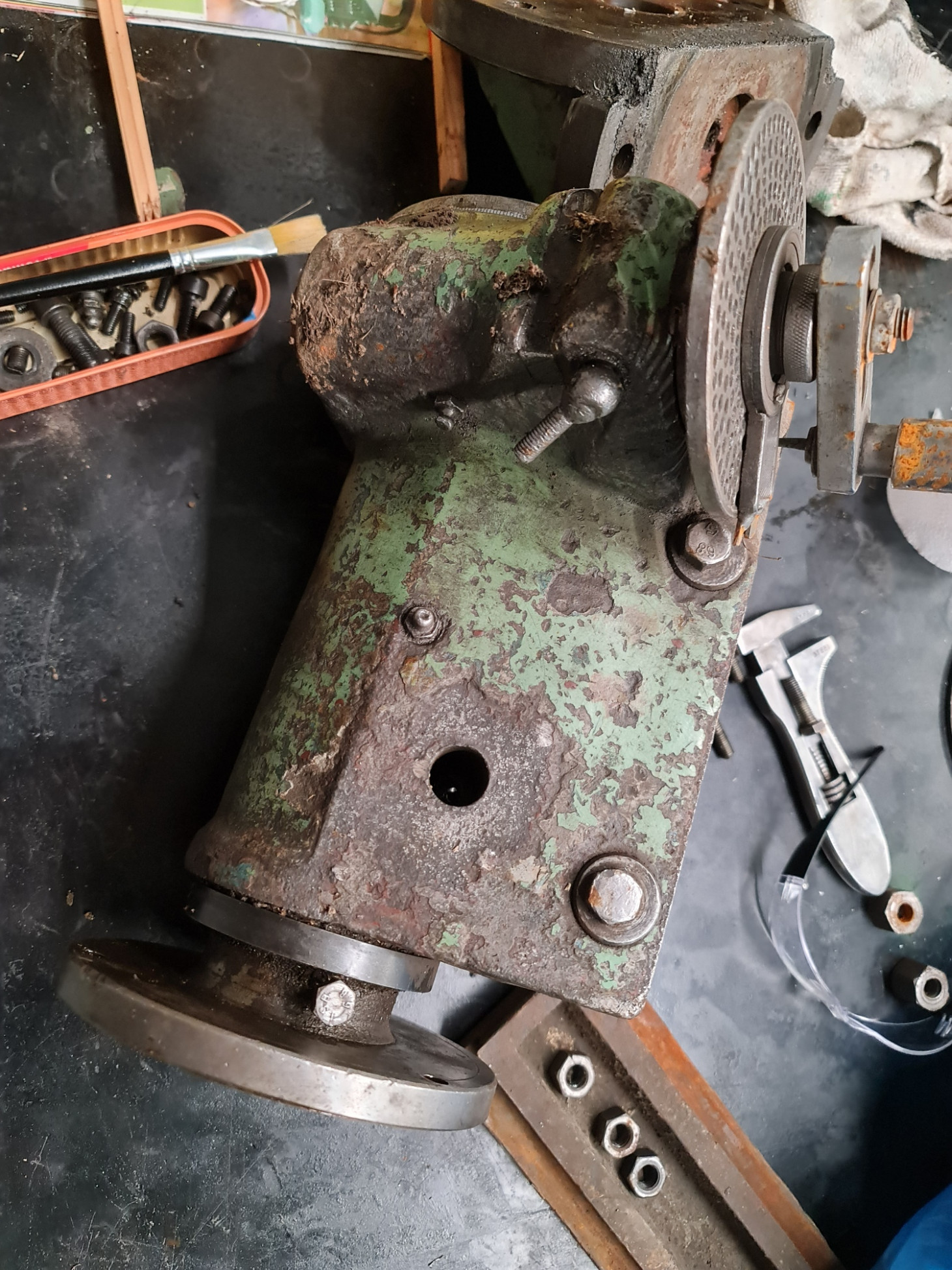

      I have a dividing head that is in very bad shape. Yesterday I decided to disassemble it. It is a nice project for evenings when I’m too tired to do more serious work. This thing is very heavy, more than 70kg for sure. It was sitting in the grass where I let it a few weeks ago. Together with the slotting head.
      I removed the chuck, a square piece and a rotating base but was still too heavy. Then it crossed my mind to use a strap. In this way I can lift it a few cm without bending myself. To put it on the workbench was another story. I used a chair to lift it in two steps. I can’t wait to finish the workshop crane. And finally here it is. The chuck doesn’t look nice. But surprisingly it runs smooth and the inner part of the jaws are not too bad. Maybe it was used as a vise for a vertical drill.
      I started with the base. I removed the old grease with paper tissues and then with cotton pads soaked in acetone.
      After there was no more grease I put some Autosol metal polish and I used a drill with a wire brush. The result is very satisfying:
      Autosol is a great product! And you have to use only a little. As a bonus the surface remains covered with some kind of transparent vax. Next I started to disassemble the main body.
      There are a lot of things inside. Of course there is a worm gear. But no bearings. I suppose this make sense. The gear doesn’t have many teeth. I was expecting more from a precision device. That long tube has a Morse 4 taper inside.
      I bought a box of calcium grease to replace the old one. But it is very thick. After some research in the world of lubricants I enlighten myself. Every grease has a consistency number, NLGI. Mine was 3 that is like “vegetable shortening”. I ordered some SKF grease with NLGI 2. According to Wikipedia this should have a “peanut butter” consistency.

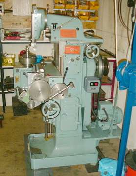

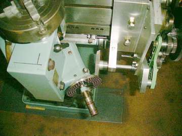

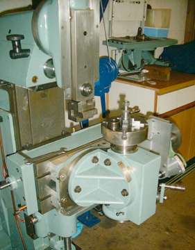

                                These dividing heads can be coupled to the mill table with a bit of inginuity. This is mine set up for gear shaping with Sunderland cutters.
                                Alexander_Miller_Set_Up_For_Gear_Shaping_03
                                Alexander_Miller_Set_Up_For_Gear_Shaping_05
                                Alexander_Miller_Set_Up_For_Gear_Shaping_02
