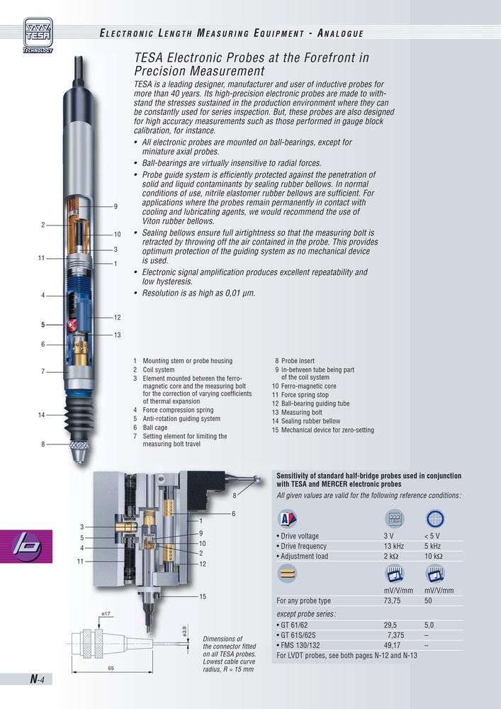

                            #130847
                              Posted by jason udall on 27/09/2013 18:06:08:
                              Must say I find remote reading handy..and by moving dial/display to other end of wire , this makes probes much more compact.
                              Edited By jason udall on 27/09/2013 18:08:58
                              Jason,
                              Here is "an oldie but a goodie" for your appreciation.
                              None of that nasty digital stuff … just incredibly good engineering.

                                #130859
                                  Posted by Stub Mandrel on 27/09/2013 20:08:23:
                                  Michael,
                                  When a screw is labelled as "mechanical device for zero setting", you know you are paying for quality
                                  … and when you consider that the axial probes are typically 8mm diameter, you know you are getting what you pay for.
                                  MichaelG
                                  #130863
                                  jason udall
                                    @jasonudall57142
                                    that device looks like a LVDT.. linear voltage displacement transducer..
                                    use mercer 493 probes all the time.. with air gauges.
                                    but the 493 is just a linear probe.
                                    when used with the micro columb (simulates the manometer style display).. you get a 300 mm high bar graph and 7 digit digital display..
                                    493 gave in linear mode 1/10th micron resolution.
                                    thoughly recomend them
                                    Edited By jason udall on 27/09/2013 23:49:56
                                    #130867
                                    Anonymous
                                      Errr, when I was designing the drive and sensing electronics for LVDT devices I thought it stood for:
                                      linear variable differential transformer
                                      Andrew
