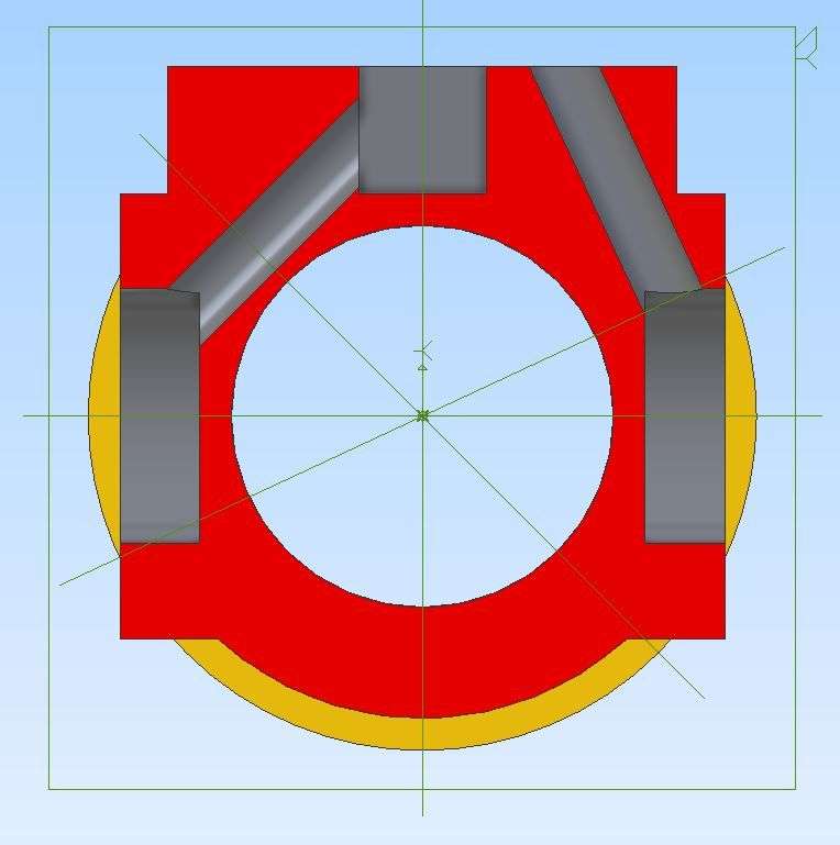

        While waiting for the castings to arrive I quickly drew up the engine in Alibre to my often used 24mm bore which was an easy conversion from the models 3/4" bore using the ratio of 1/32" = 1mm and was able to determine a couple of missing dimensions and check that it all went round and round as it should. I may make one of my own at some time but will probably go for 18 or 20mm bore as the 24mm is a bit big unless I want to start adding more detail.

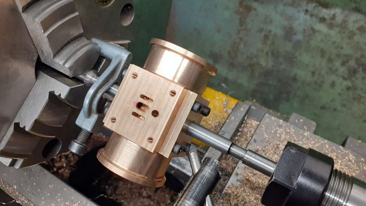

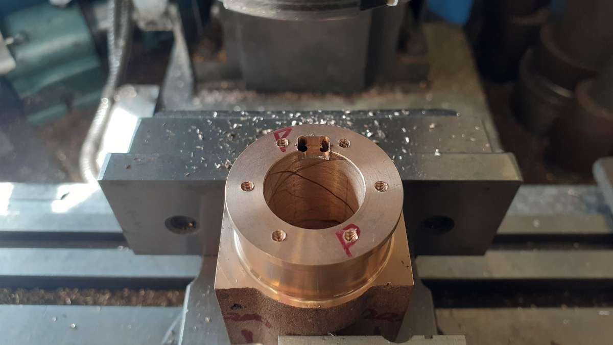

                      #679825

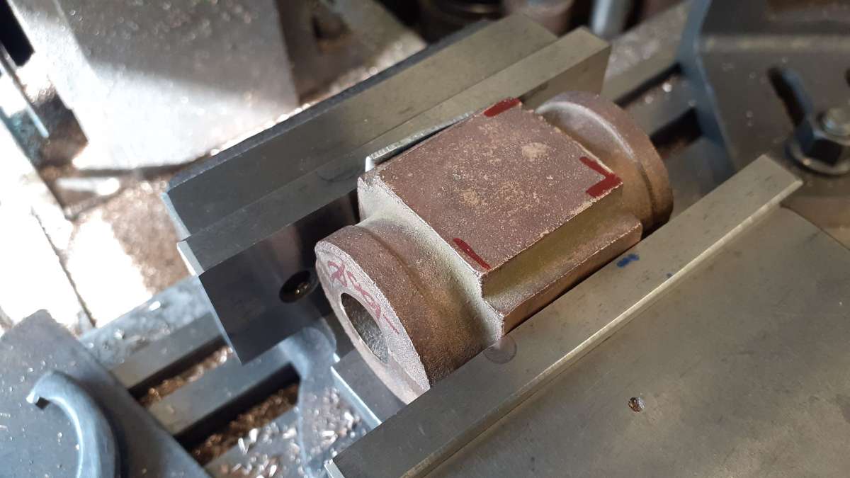

                        The main challenge with the cylinder casting is getting the location of the trunions that fit either side exactly in line and at right angles to the bore, I hatched a plan to do the cylinder and then fit the part machined trunions to that before final machining and almost came a cropper but first lets look at the cylinder.
                        Like the other castings I took a skim off the flat surfaces first those being the port face and the two trunion mounting faces either side. Here you can see I have at least 0.100″ to play with at the ends and the red lines roughly show the extent of material to come off around the port face.
                        20230828_085701[1]
                        After skimming these faces I had three flat and true surfaces to go against the 4-jaw chuck’s jaws and used an aluminium packer on the curved underside. After facing off and boring the OD of the flange was turned which was actually smaller that the rest of the cast body of the cylinder so to add a bit of shape a round ended tool was used to reduce the area between flange and portface/trunion mount by 1/8″ in diameter, you can just see the generous amount of metal left on the curved surface under the ali packer. The other end was then treated the same.

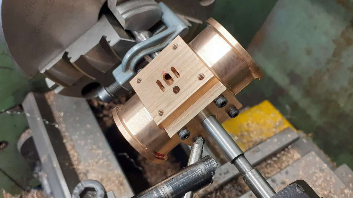

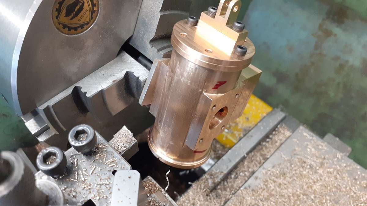

                        To aid in holding the cylinder casting for some further machining I made one of the end covers at this stage, it was the one with the gland for the piston rod, the boss of which was left over long at this stage to give me more to grip.
                        20230828_141931[1]

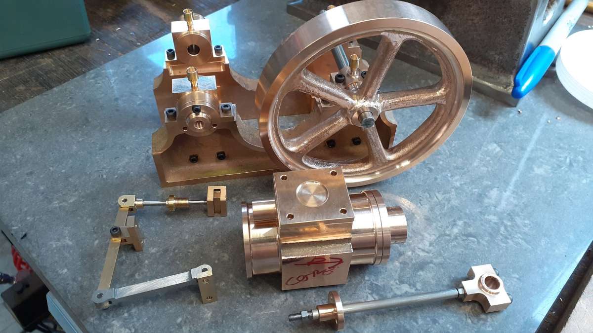

                        This group shot shows the current state of play.
                        20230828_143704[1]

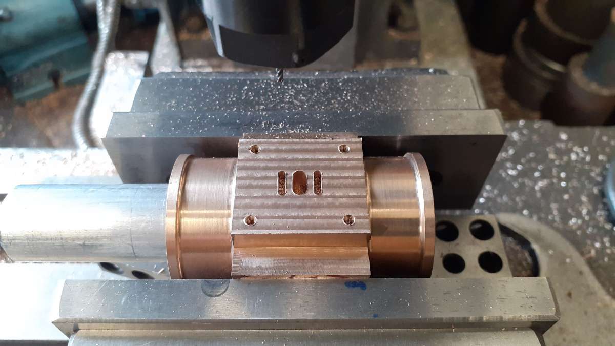

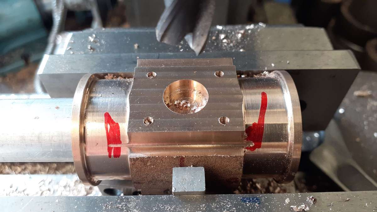

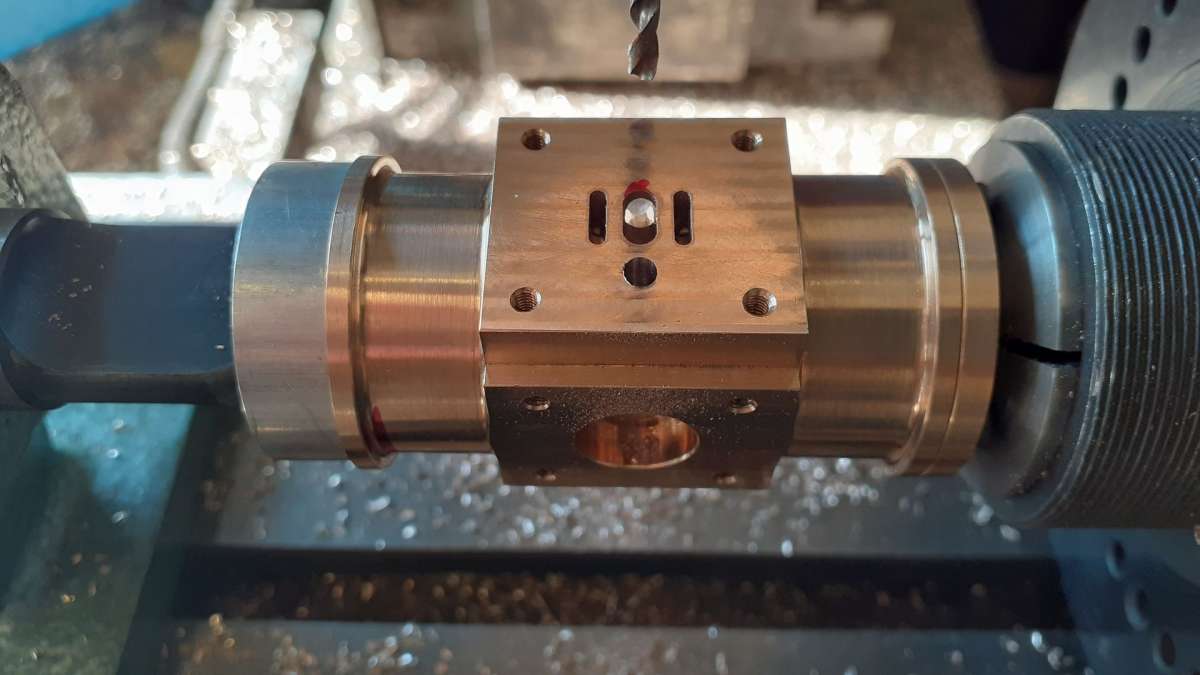

                        Next was to drill the two 2mm dia holes to where the inlet ports will be and also the six M2.5 holes for the cylinder cover studs and finally mill a notch so the steam passages connect to the cylinder. This was repeated at both ends.
                        20230902_120905[1]

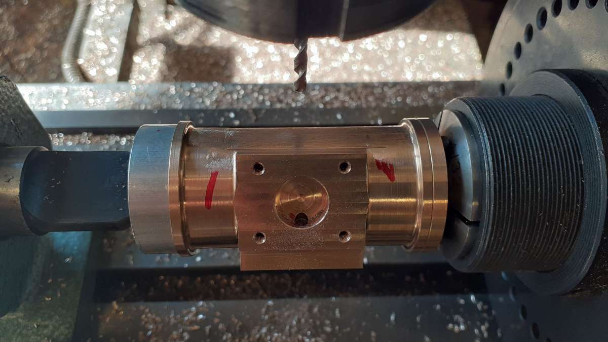

                        Using some bar in the bore the casting was centered and the port face milled to the correct height above the bore. The width was done at the same setting taking the cut sdown to form the top edge of the trunion mounts Most of the material was removed with the facemill then the final finish cuts with a new carbide 3-flute 6mm cutter using a 4mm stepover. The inlet and exhaust ports were milled at this same setting.
                        20230903_090011[1]
                        The two trunion mounting surfaces were then milled in a similar way. A 5/8″ x 5/32″ deep hole is required to locate a spigot on the trunion so these were plunge cut working up through sevaral sizes of 3-flute cutters actually finishing with a 16mm one as the size is not critical and I’ve more sharp cutters in that size than 5/8″.
                        20230903_131849[1]
                        To mill the curved underside to size I screwed on the end cover and held that in the 5C indexer adding tailstock support to the other end with the addition of a quickly knocked up plug. I also used this setup to drill the steam passages from the trunion recesses to the valve cavity and exhaust port. The angles and hole positions were taken from a section of my cad drawing, there is not much metal to play with.

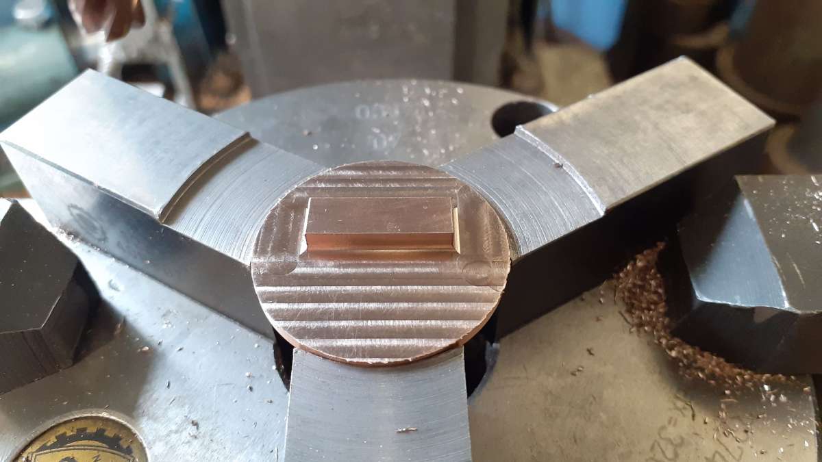

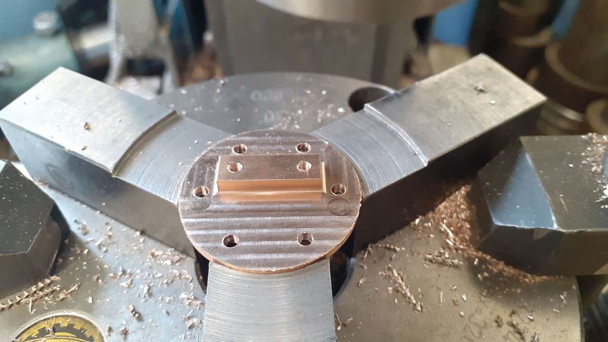

                        #684053

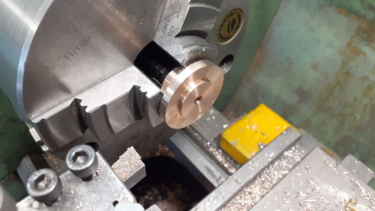

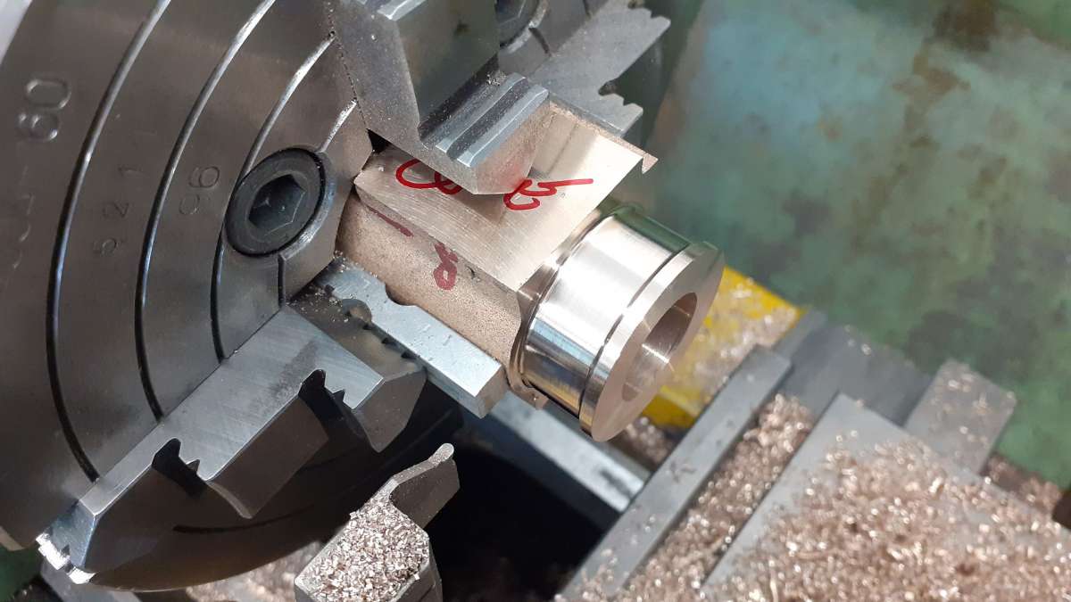

                          The other end cylinder cover was faced and turned to diameter and the spigot formed to fit the cylinder before transfering to the mill where the face mill was used to bring the block for the valve rod bracket down to final height.
                          20230831_142434[1]
                          Then a 6mm cutter with 1mm convex corner radius was used to both size the block and face the rest of the cover down to 3/32″ thickness leaving a nice internal fillet.
                          20230831_150012[1]
                          Finally the six stud holes were drilled 2.5mm and the two that secure the pivot tapped M2.5
                          20230902_083916[1]

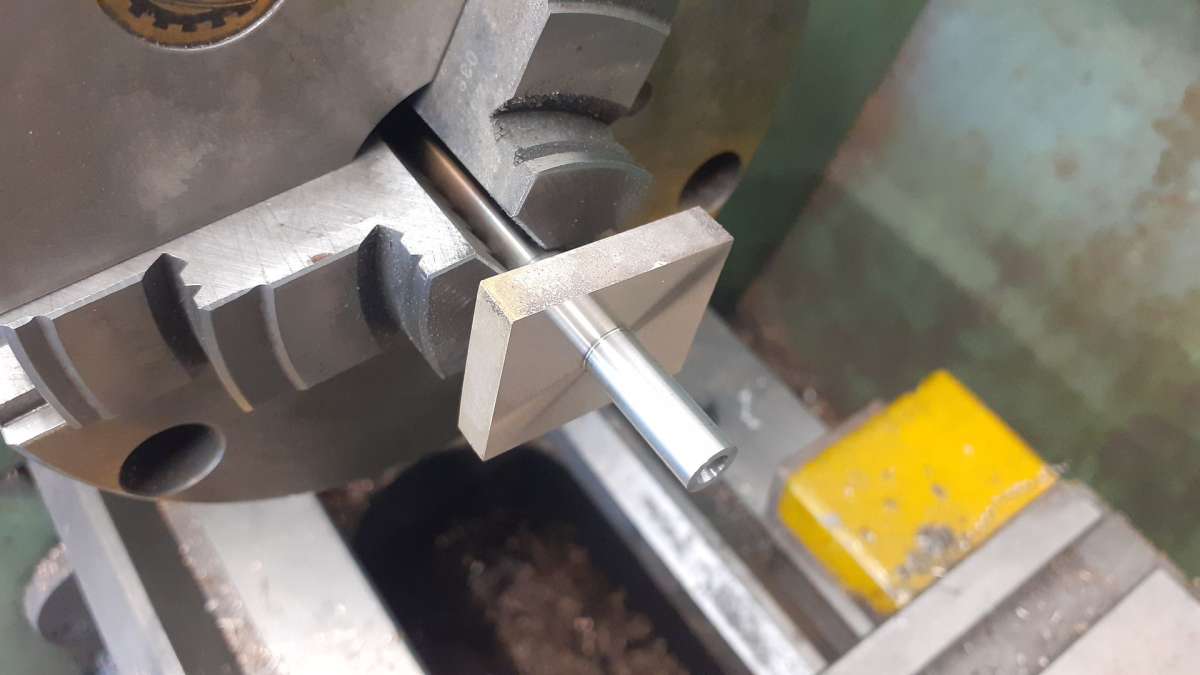

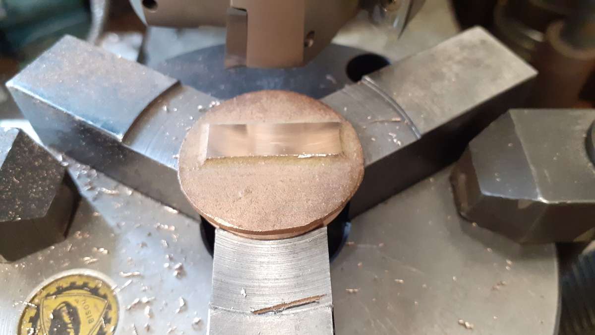

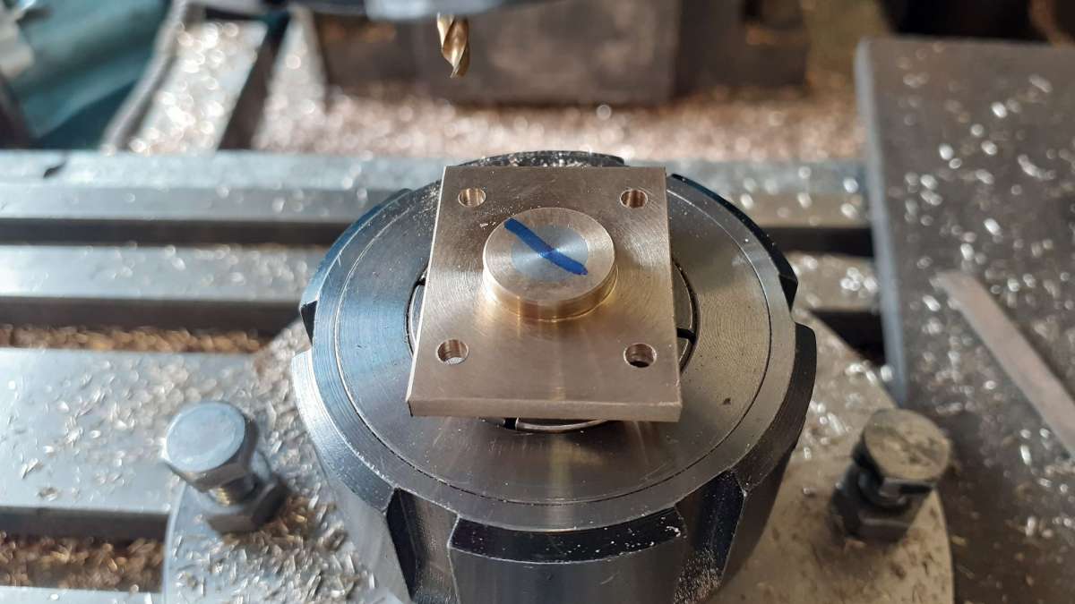

                          The drawings call for the trunions to be fabricated from a flat piece of brass and some stainless rod. I started out with two pieces of 8mm dia 303 stainless and reduced a suitable length down to 7mm and added a deep ctr to the ends and part drilled 1/8″ dia. Two oversize rectangles of 1/4″ thick brass were drilled 7mm and then silver soldered to the stainless rods. Once cool They were held by the remaining 8mm dia so that the face of the brass could be turned true to the shaft and a light skim taken off the 7mm dia just to clean it up.
                          20230906_094406[1]

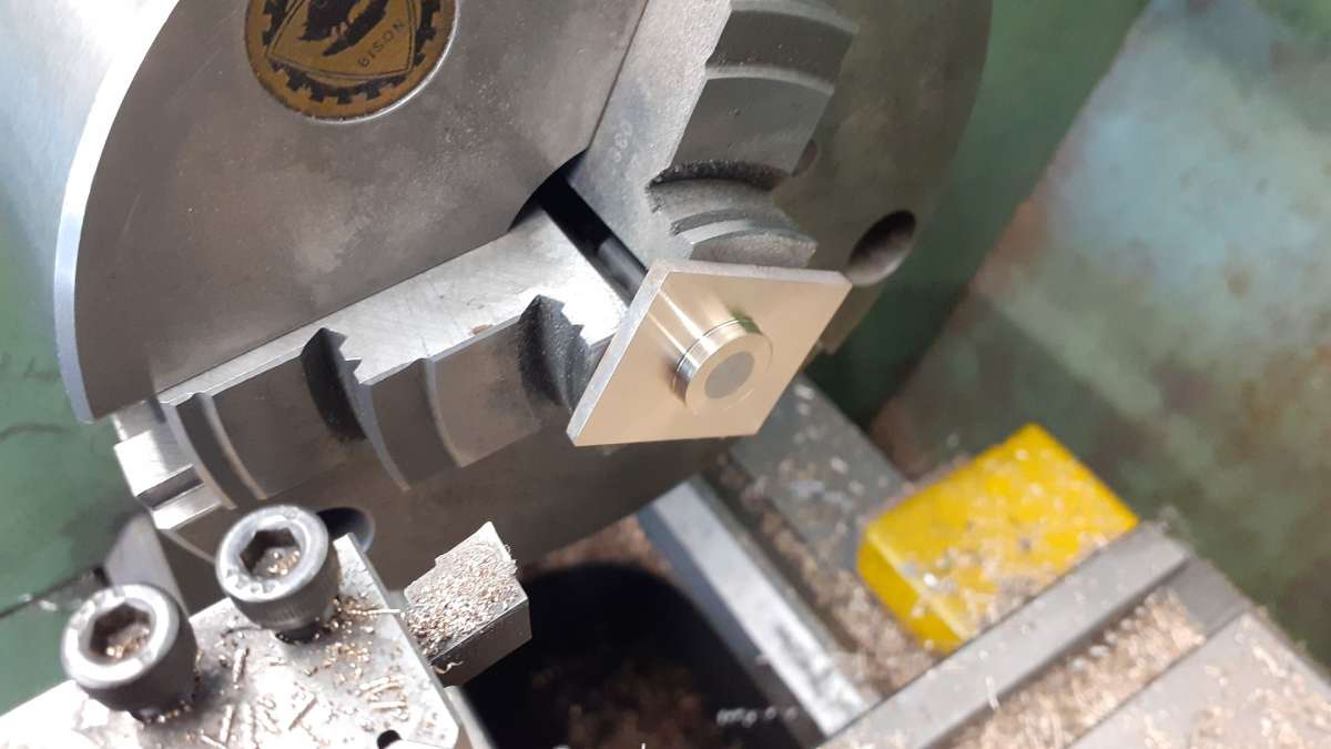

                          After sawing off from the 8mm bar the inner faces were machined along with the spigot to locate into the holes in the side of the cylinder
                          20230908_093334[1]
                          Here I have used the cylinder to gauge a firm fit of the two parts as I don’t want them to loose there positions when taken apart after the final insitue machining.
                          20230908_093344[1]
                          After this the rectangle was milled to the final overall size and the mounting holes drilled
                          20230908_105042[1]
                          The cylinder and it’s trunions were then assembled with temporary cap head screws so that the trunion shafts could be turned to final 1/4 “diameter between ctrs. I almost came a cropper here as it was difficult to get any turning tools in without either hitting the tailstock ctr or catching the screw heads, In the end I managed with a home made 6mm dia dead ctr held in an ER16 Collet chuck to support the work and a  boring bar and bit to do the actual turning.
                          20230909_080911[1]
                          20230909_080919[1]

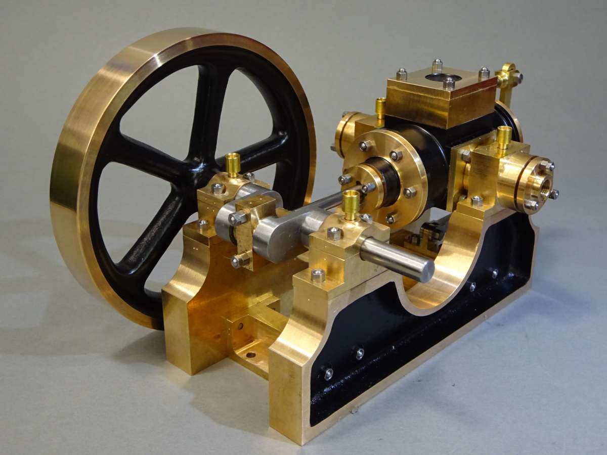

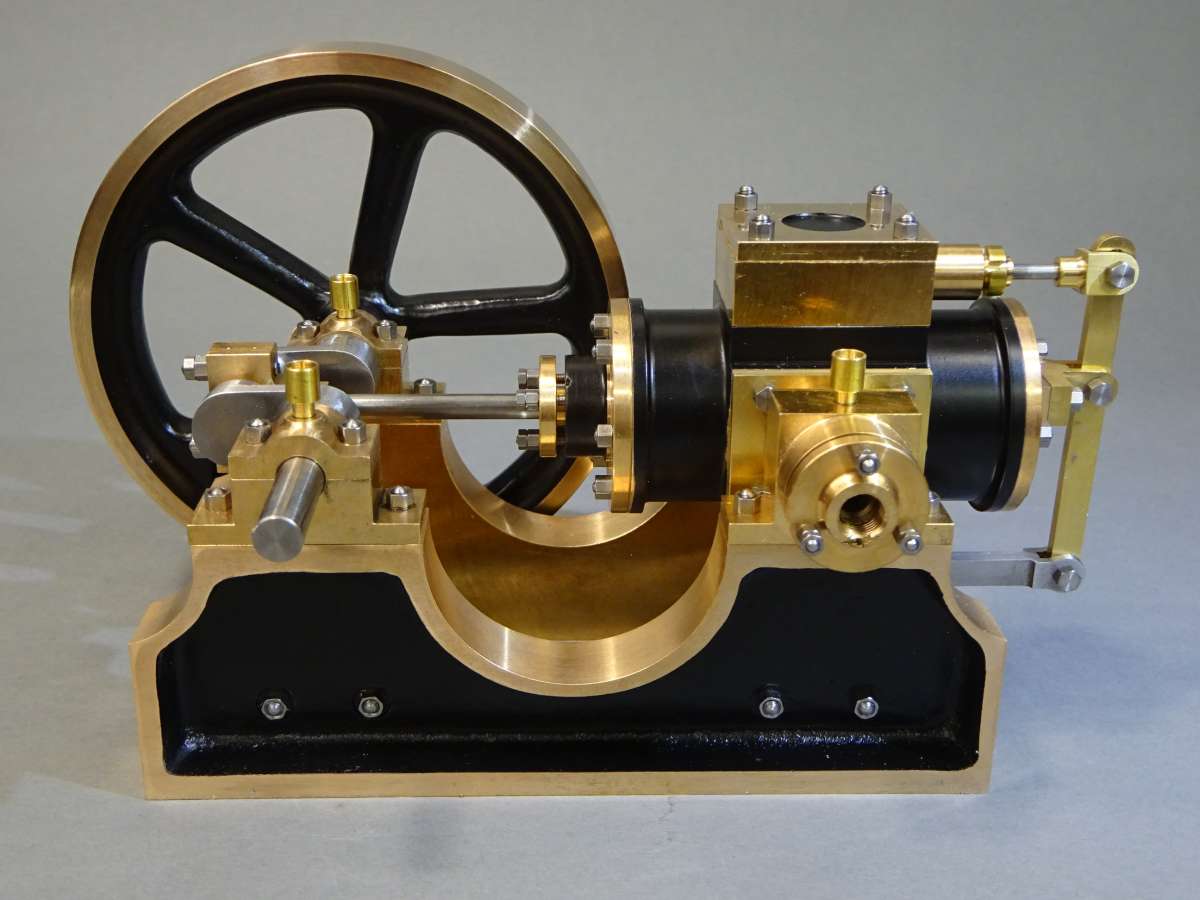

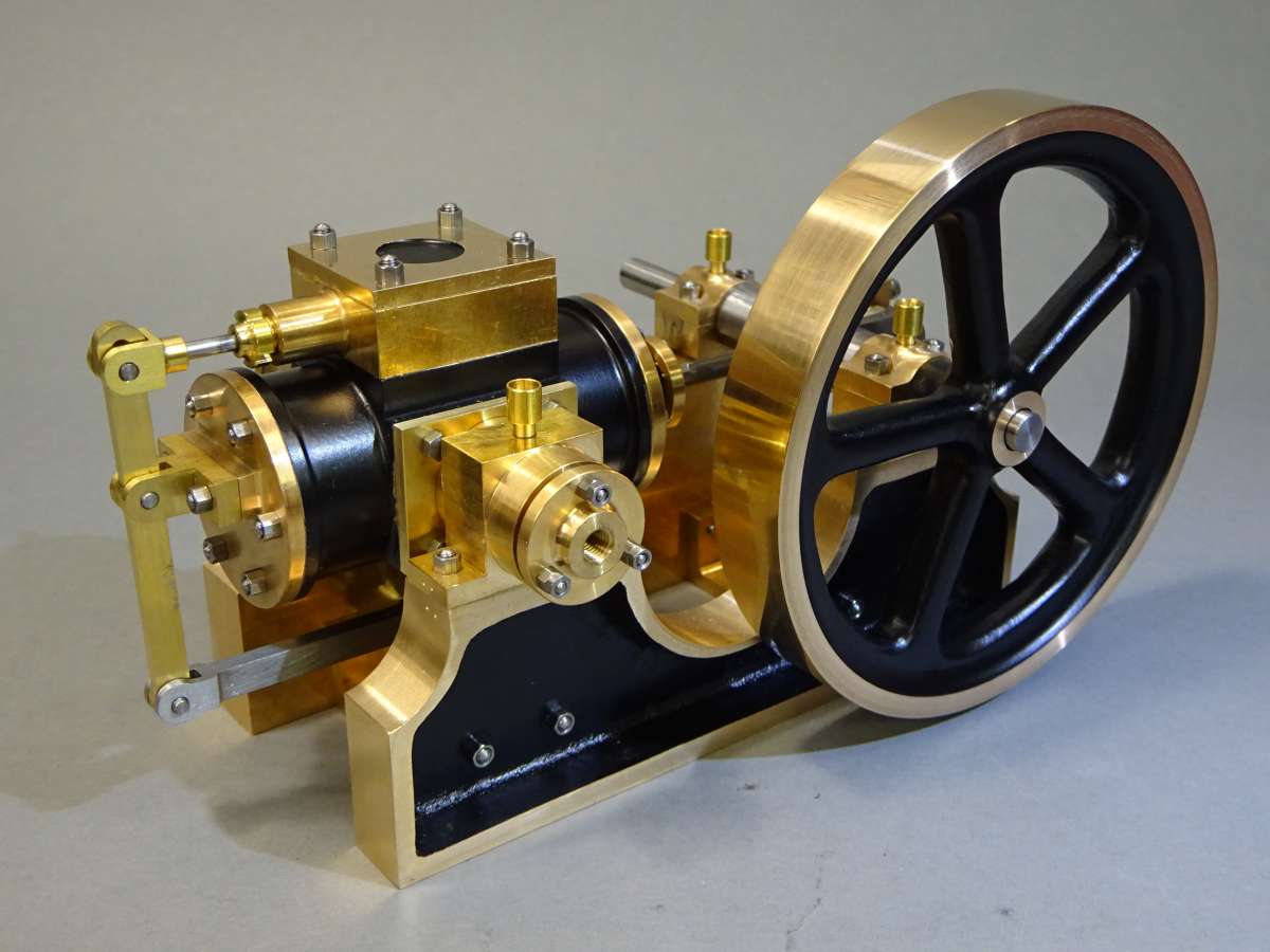

                              To finish of this thread here  are some pictures and a video of the finished engine. As I said a bit more bright metal than I would personally go for but quite happy with how it looks, the satin black sets off the bright metal well which is almost all straight off the machine no additional buffing or polishing except the flywheel rim and rear cylinder cover that got a bit of emery.
                              I’m still none the wiser as to why they called it “Digger” If I get round to making my own I think it will be called “Shaker” as the cylinder reminds me of a cocktail shaker not because it jumps about even at speed – all that heavy bronze keeps it quite firmly planted.
