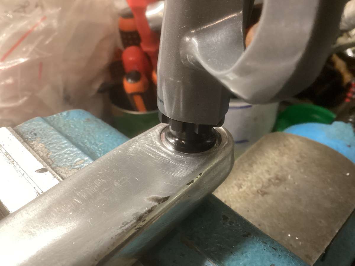

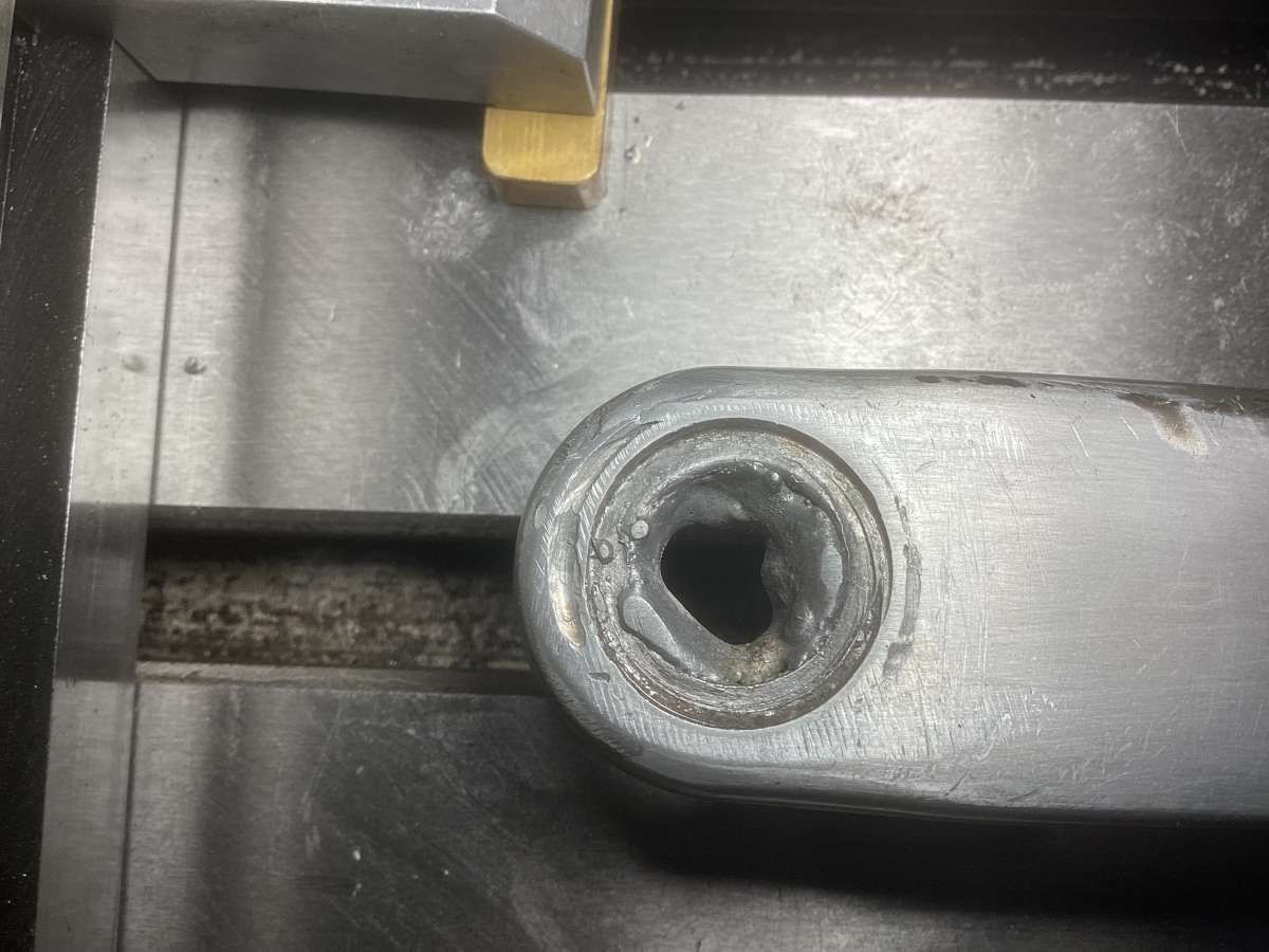

              I’ve spelched in a good quantity of Alusol, after cleaning out the bore and brushing it thoroughly with a stainless wire Dremel wheel.
              The Alusol wetted the parent metal very well indeed and a lot less heat was needed than the guy in the video was using. My only reservation is the softness of the solder, which is unlikely to make the repair as durable as the original aluminium. If it fails, I will go the bushing route next time.
              A pair of 9/16”x 20 taps have been ordered from Ebay. I just need to think about the final drill size before tapping. I’ve got a 33/64” jobber, but no 13.2mm.
              Photos show the soldered bore, and the set-up I plan to use on the mill to ensure drilling and tapping are perpendicular to the crank. Not shown is the toe clamp I intend to put near the end of the crank in line with the “jack” you can just make out underneath.
              IMG_0891IMG_0892

                Probably better to bore the hole as a drill will want to follow the welded hole as well as not being the size ou want

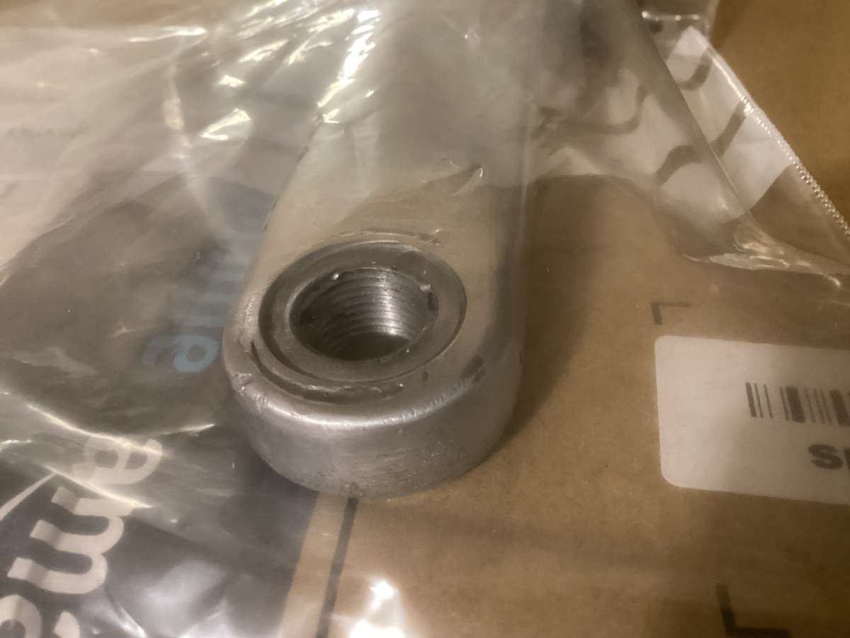

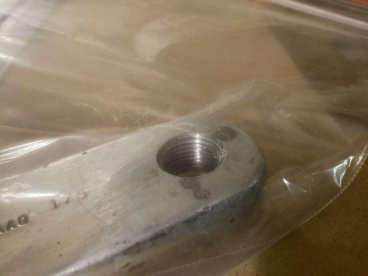

                                    I ended up plunging down (carefully) with a half inch slot drill and then drilling out to 13mm. Thankfully, there was no drama.
                                    The taps I received are marked “9/16×20 UN” and “HSS”. My only criticism of them is that they are practically plug taps with almost no taper, which could make keeping things straight difficult if you were freehand tapping.
                                    If the present repair fails, I will resort to plan B, which is to use Durafix rods. A dozen or so test solderings with Durafix of large holes drilled in aluminium plate tells me it makes for a pretty strong thread repair.
                                    IMG_0905IMG_0906
                                    IMG_0904

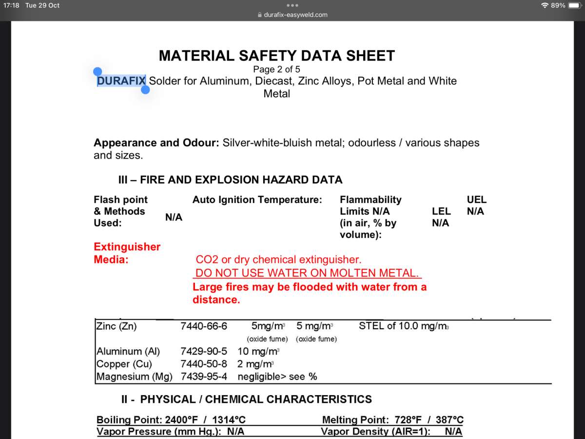

                                            I mentioned in my last post that I’ve been experimenting with Durafix aluminium soldering rods believing it is probably a stronger repair for aluminium than Alusol, which is softer since it contains a lot of lead.
                                            Just a heads up about Durafix: not all rods sold as Durafix are equal. Until today most of my experimenting with Durafix had been with rods bought from Oxford Welding Services. These have been excellent in that the filler metal flows way below the point at which the parent aluminium does and of course it bonds well with the parent metal too.
                                            Today I received, from a different Ebay seller, a package of something described as: “Weld with Ease Using Good Welding Effect Durafix Aluminium Welding Rod”.
                                            These work, in that they bond well to the parent metal and form a strong repair, but their flow temperature is considerably higher than the Durafix from OWS. The temperature needed to reach the flow temperature (I’d estimate 100 degrees C higher) means it’s difficult not to bubble and pit the parent aluminium by the time the job is finished.
                                            Thankfully they were only £6 for ten rods.

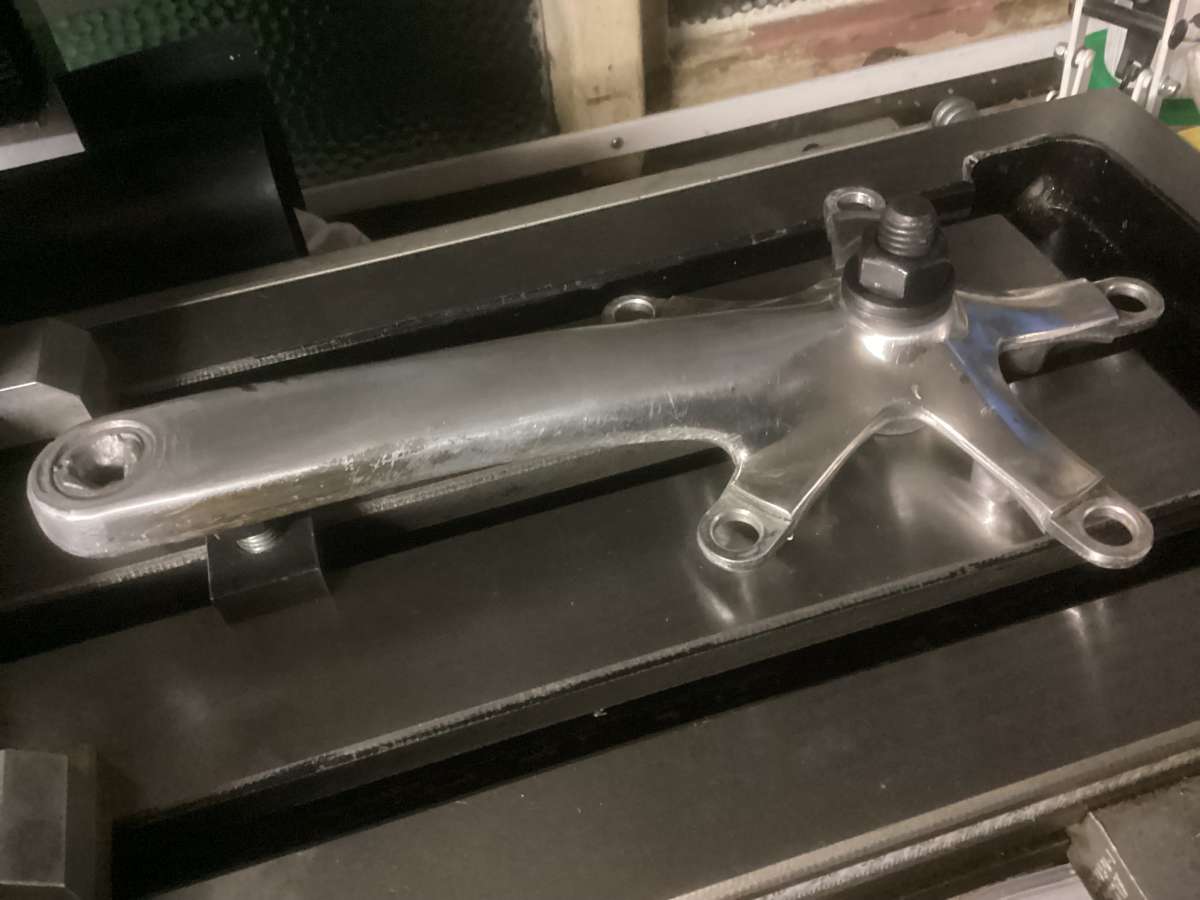

                                                An update: I’ve now done (i.e. today) six test pieces, three using Durafix from OWS and three using the mysterious new stuff. I drilled 10.5mm holes in 1” square pieces of 1/4” thick 6082 aluminium, and filled the holes with melted rod. I then drilled to 5mm and tapped M6 in the centre of each filled hole.
                                                To test the strength of the thread I tightened a grade 8 cap screw into the hole using a 125mm long 5mm hex key.
                                                In the case of the OWS Durafix repairs I stopped tightening when the hex key started to bend. The thread and the bond of filler to parent metal were not visibly affected. In the case of the new mystery rods the threaded holes stripped out with ease, long before the hex key started to bend.
                                                So I must revise my earlier statement that the new rods produce a strong repair; evidently they do not, even if they bond well to the parent metal.
                                                I’m not sure what accounts for the weakness and higher melting point in the new rods. The composition of Durafix is suggested in the picture below. Given the differences in behaviour, if any metallurgically savvy people can tell me what the likely difference in composition of the new mystery rods is (more zinc? less zinc? more moldy cheese?) I’d be interested to hear from them.
                                                Perhaps this thread should now have a dual title: the one it’s got already and “The difference between Durafix and Durafix”.
                                                IMG_0915
