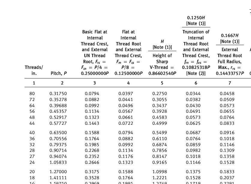

            9/16 20 UN, is not a UNS thread size, that is for different pitches (14 and 27 tpi), info below on 9-16 20 UN-

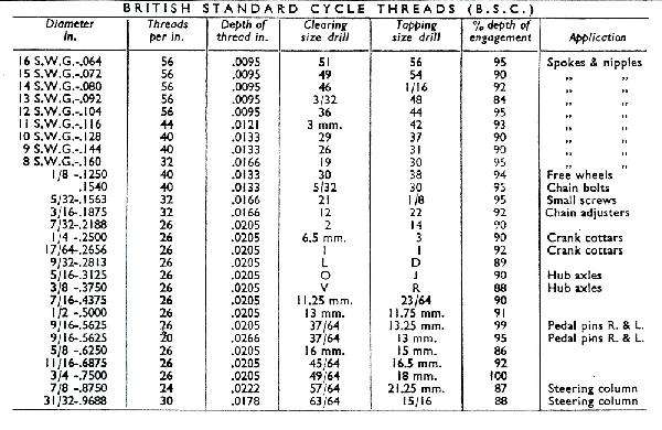

            The only info I have on cycle thread is-
            Screenshot 2024-10-18 025636
            Based on the above, I’d just use the cheapest option.

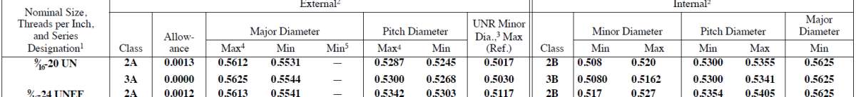

                        As far as I can find out, 20UN has an external root rad of 0.007″, whereas 9/16th 20tpi has a root rad of 0.0083″.
                        Screenshot 2024-10-18 155804
                        Screenshot 2024-10-18 160658
                        JimB
