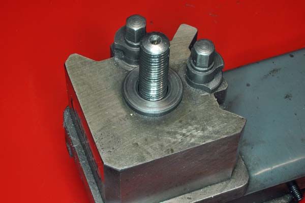

      I have just purchased a used Myford Super 7 that included a Dickson tool post that wasn't installed. The post on the cross slide is considerably smaller than the bore of the Dickson. How is this usually handled. Do I need a different post? Is there a sleeve for the post that I haven't located?

          You just need a stepped washer thats a good fit over the topslide post and the bore of the toolpost.
          **LINK**
          Or they do a shaped washer that self centres the toolpost, easy enough to make your own
          http://www.myford.co.uk/acatalog/info_1816.html

            I suspect that the toolpost you have was intended for a larger machine so first check that you can get the required adjustments in tool height . If that's OK just make up a sleeve – a quick and easy job. If you are fussy, and once you have a good fit, loctite the sleeve into the toolpost.

              I have located the washer that is used with the standard tool post and have tried that. I also will look for the stepped washer as that might be around in the tooling that came with the lathe.

                My first job on my new Myford was making a stepped washer for the Dickson. I probably used the plain washer as a stopgap.

                  Just so you know what your looking for, here are some pics from my album.
                  Not difficult to make if you can't find it.
