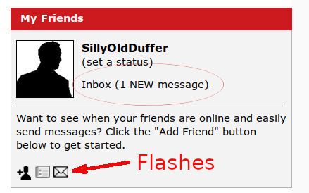

                                          Posted by David Smith 48 on 30/03/2022 20:50:17:
                                          Hello John,
                                          If you sent me a PM I did not receive it.
                                          Welcome to the forum Dave. The arrival of a Personal Message is signalled by a flashing envelope in the "My Friends" box top right of the screen, also shown is the number of PMs in the Inbox. To read the message click on the 'Inbox (1 NEW message)' link. Another way is to click 'Inbox' between 'Settings' and 'Friends' in the green banner top left of screen.
                                          You don't have to 'Add Friend' to receive or send PMs.
