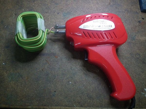

                                        I made a very crude demagnetiser for my three jaw chuck jaws using an old instant soldering iron:
                                        It took five minutes to make and did the job. Much quicker than buying one!
                                        Russell
