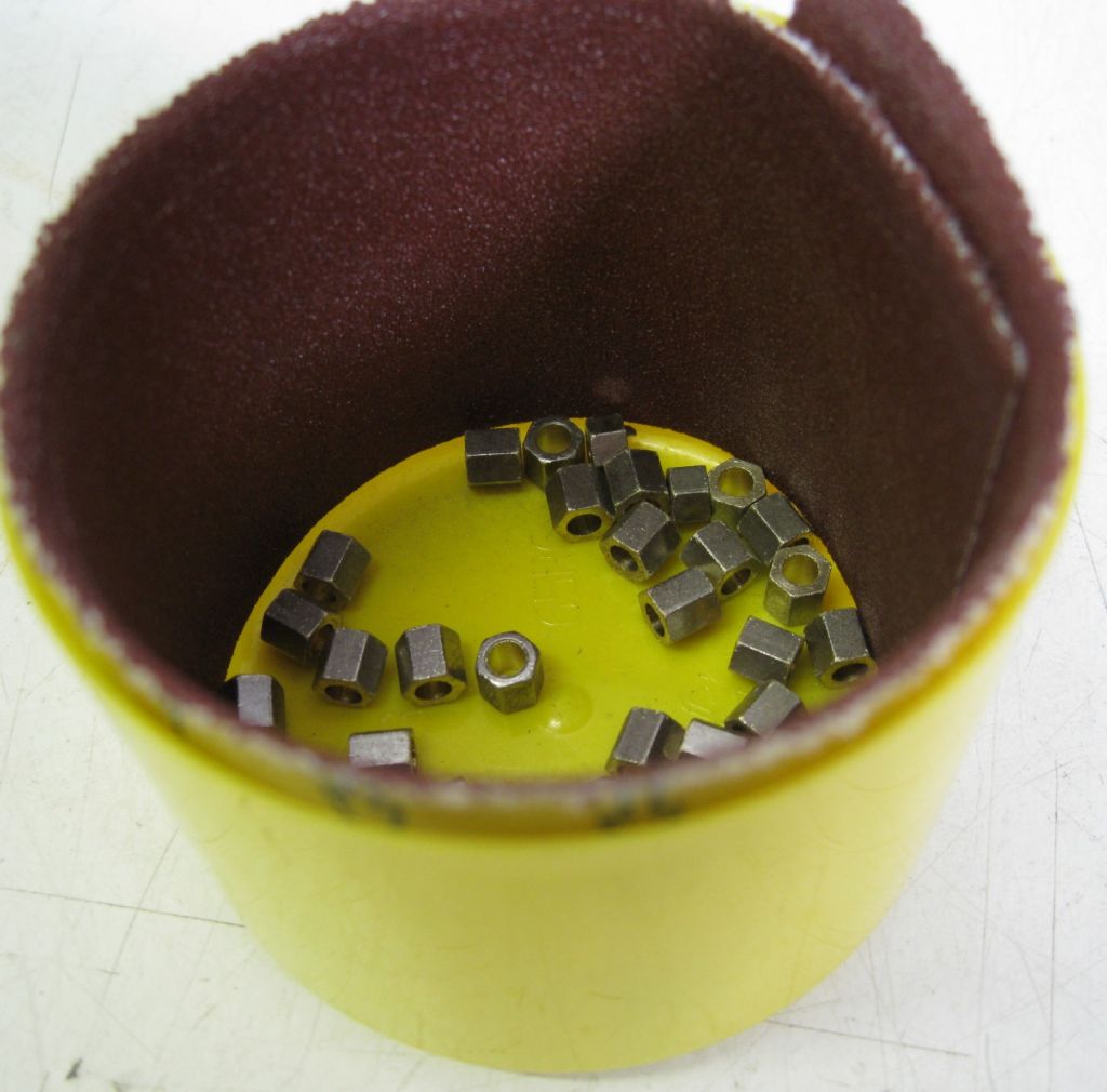

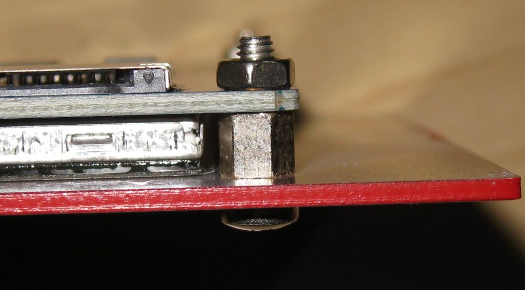

        I required a handful of 5mm long spacers to fit an LCD to the front panel of an electronic box I developed. I have a few 5mm long hex standoffs, too few, but have many 40mm long of the same stuff, so parted off a bunch of 5mm sections. This left a nice sharp edge burr at the part face and it was too much effort to reset each in the chuck, and clean the corners up – I had to do 40 off them…

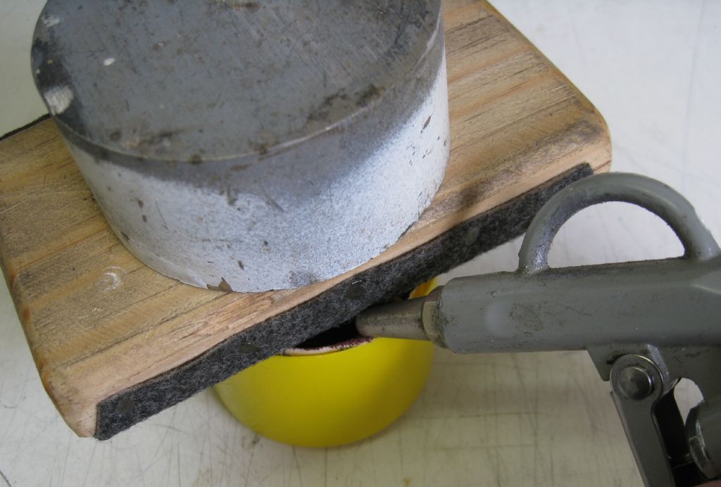

        So, tear a strip of fine emery paper, the width equal to the height of an aerosol can snap-on lid. Fit the emery inside the lid, against the sides, with emery inwards. Dump the bits to be deburred inside, top off the opening, leaving a small gap – insert the nozzle of the compressed air gun into said opening at an angle and pull the trigger, hold for 2-3 minutes, and the bits are all nicely deburred!

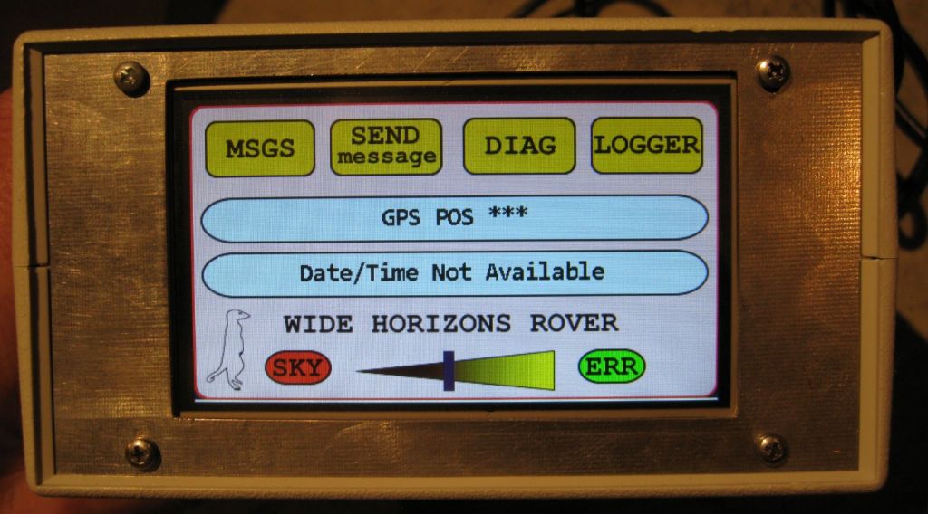

        The spacer between the LCD and the rear of the front panel of the box of tricks:
        LCD viewed from front.
        Emery in the container
        CLose off the top and blast with the air gun..

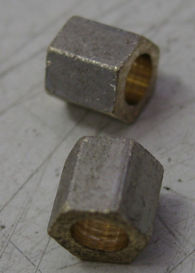

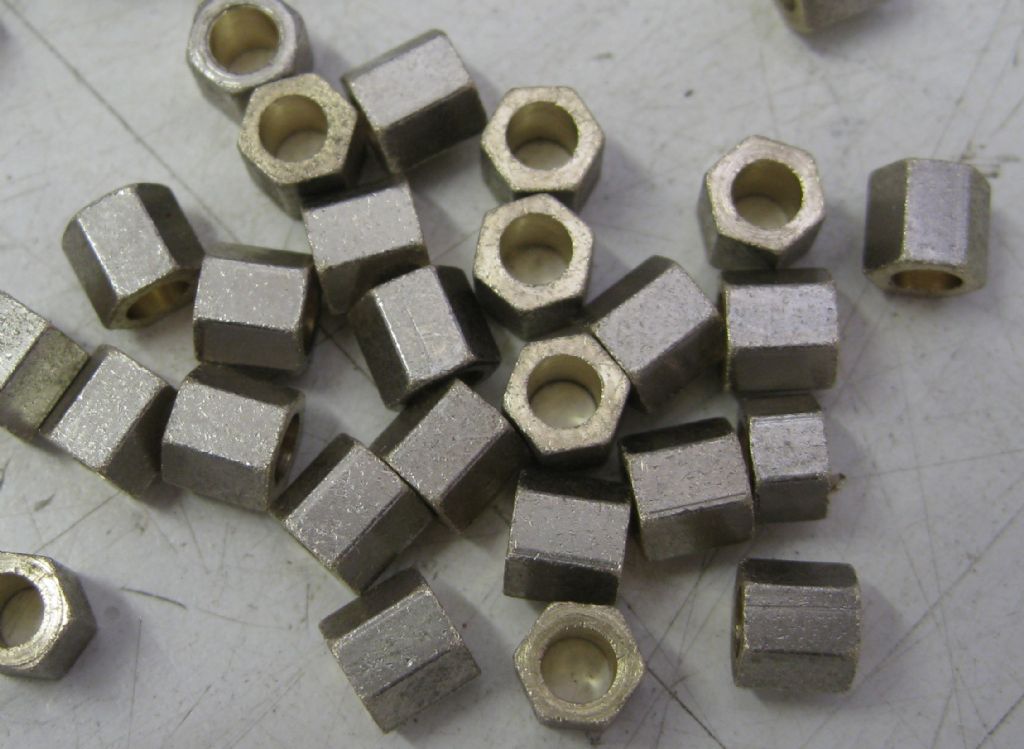

        Nicely deburred, matt finish.

              That's a really neat trick! Ideal for one off jobs, plus a lot quicker than the vibrating abrasive machines.

                              You got it Alan!
                              By the time John Reese is busy with step 7 for the 19th time, I have 40 parted and deburred spacers already fitted to the display panel…Not to mention the hour spent grinding a parting tool with skew lead and 45deg chamfer…
                              No worries Alan – when folk are doing better than me, I'll step down..
                              Also, lots of mention of tumblers, etc – yes, they obviously do work, if you are happy to wait an hour or 6…
