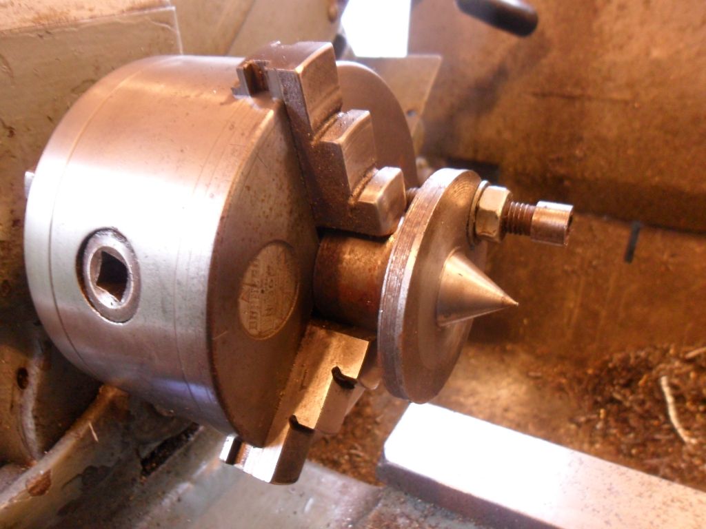

                          Hi
                          I always turn the dead centre in the head stock before use. That way I [know] it is perfectly concentric.
                          Just a light trim cut.
                          Soft dead centres are easy to make; often I just pop a small end of parallel sided steel I use as a centre in the three jaw. skim the point to make it concentric and use.
                          It saves time compared to removing the chuck and fitting the nose plug and a centre, although that method has less overhang.
