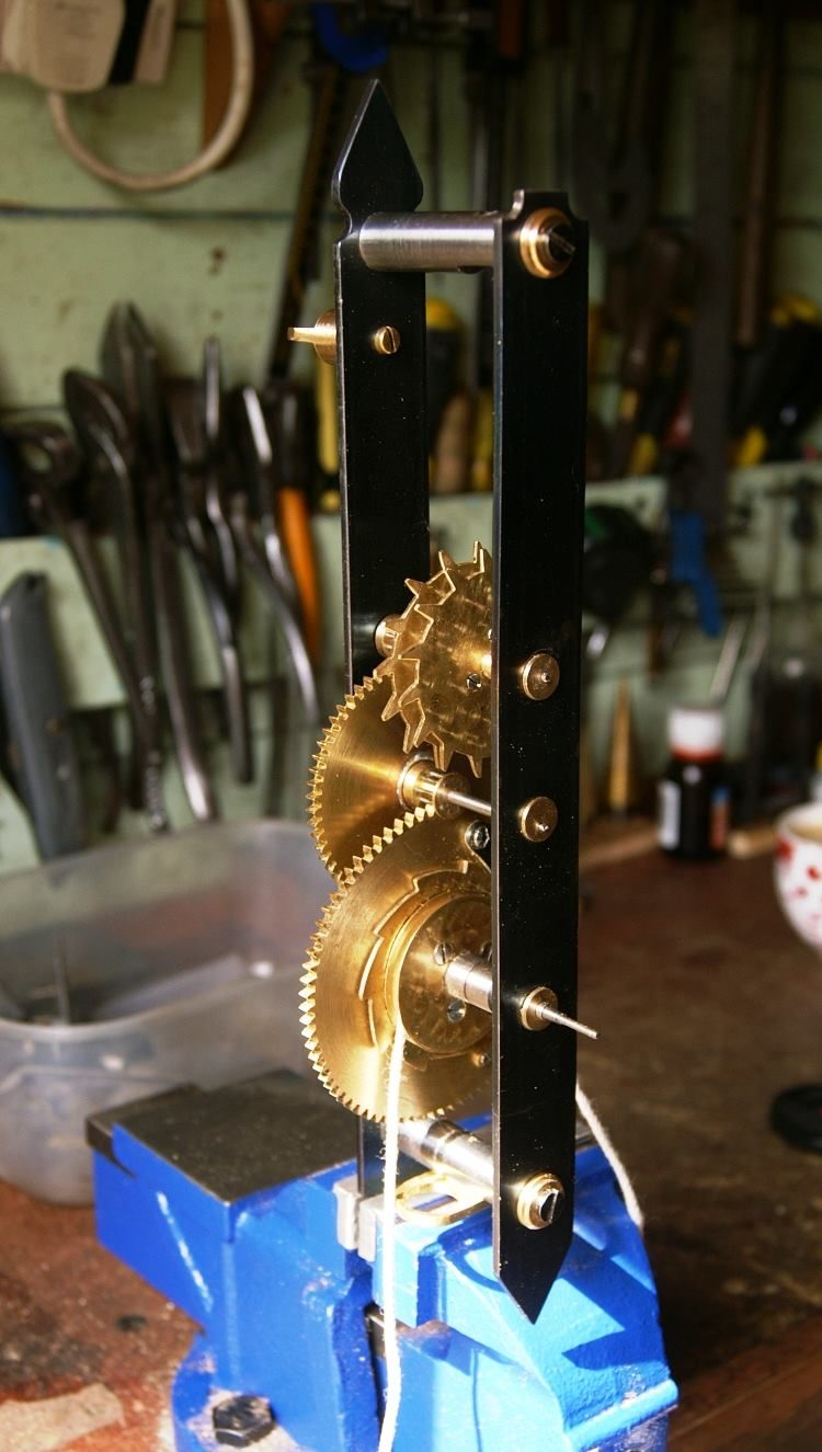

          john carruthers
            @johncarruthers46255
            It's coming along John thanks, I planted the train today and it runs with a piece of brass tied to the cord as a weight.
            Next some tidying up, then the verge/foliot.

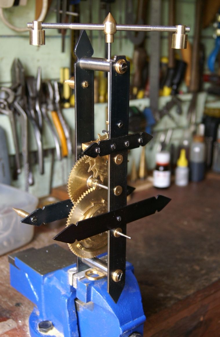

                john carruthers
                  I have to make hay while the sun shines Neil, might be back on the morphine tomorrow party
                  #245538
                  john carruthers
                    Today I made the foliot and it actually ticks.
                    A bit erratic yet but quite encouraging.

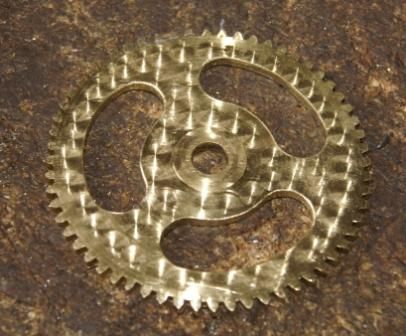

                            john carruthers
                              The minute wheels…

                              Ajohnw
                                @ajohnw51620
                                Posted by Neil Wyatt on 09/07/2016 12:17:56:
                                Posted by Ajohnw on 09/07/2016 09:40:20:
                                Interesting thought John. At one point I wondered if an electric drill motor could be adapted for a small milling spindle but found that they don't contain "complete" motors that can easily be removed.
                                I fitted the planetary gearbox from a portable drill into a steel casing that clamps in my toolpost. Works OK for light milling & drilling, but rarely used now I have a mill.
                                I always have the thing I can't do at the back of my mind Neil – cylindrical grinding. If a spindle can't do that as well as mill not of much interest.

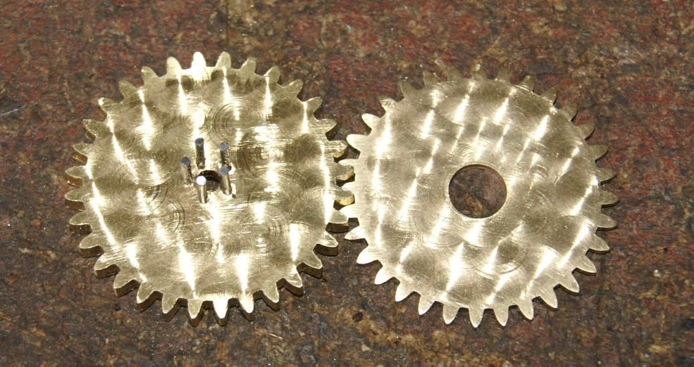

                                            john carruthers
                                              This morning's effort, the hour wheel.
                                              I also made the minute wheel stud and marked out the hands ready for tomorrow.

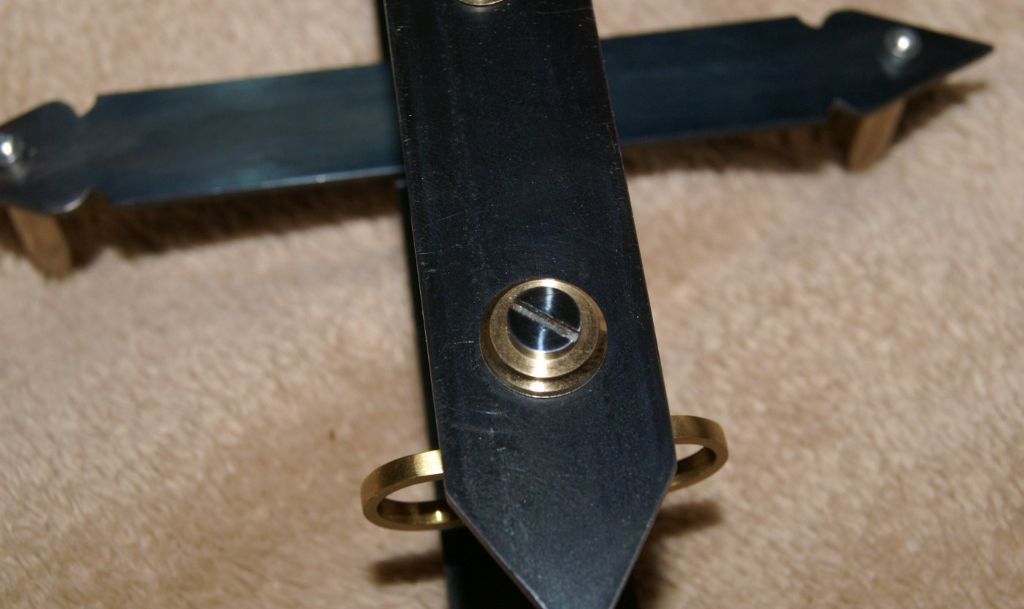

                                              John silver
                                                @johnsilver78232
                                                My humble efforts so far (My 1st metalwork project)
                                                Quite a way behind you there John, but getting there very slowly
                                                All the best
                                                Edited By John silver on 10/07/2016 12:52:03

                                                  John silver
                                                    @johnsilver78232
                                                    Cheers John
                                                    I'm no so 'crisp' with the fret saw though I think I'll do the cross members next (I have turned the pinions but not drilled them. For this I'll make a mandrel and use my rotary table)
                                                    All the best (another) John
                                                    #246420
                                                    John silver
                                                      @johnsilver78232
                                                      A quick question on the verge cross arm clamp.
                                                      As this is the same width of the front main plate ie 25mm and the hole spacing is 19mm, is the intention to have slotted holes in the main plate so that the whole verge plate etc can be slide up and the down the front main plate as required to get anything aligned correctly??
                                                      Cheers
