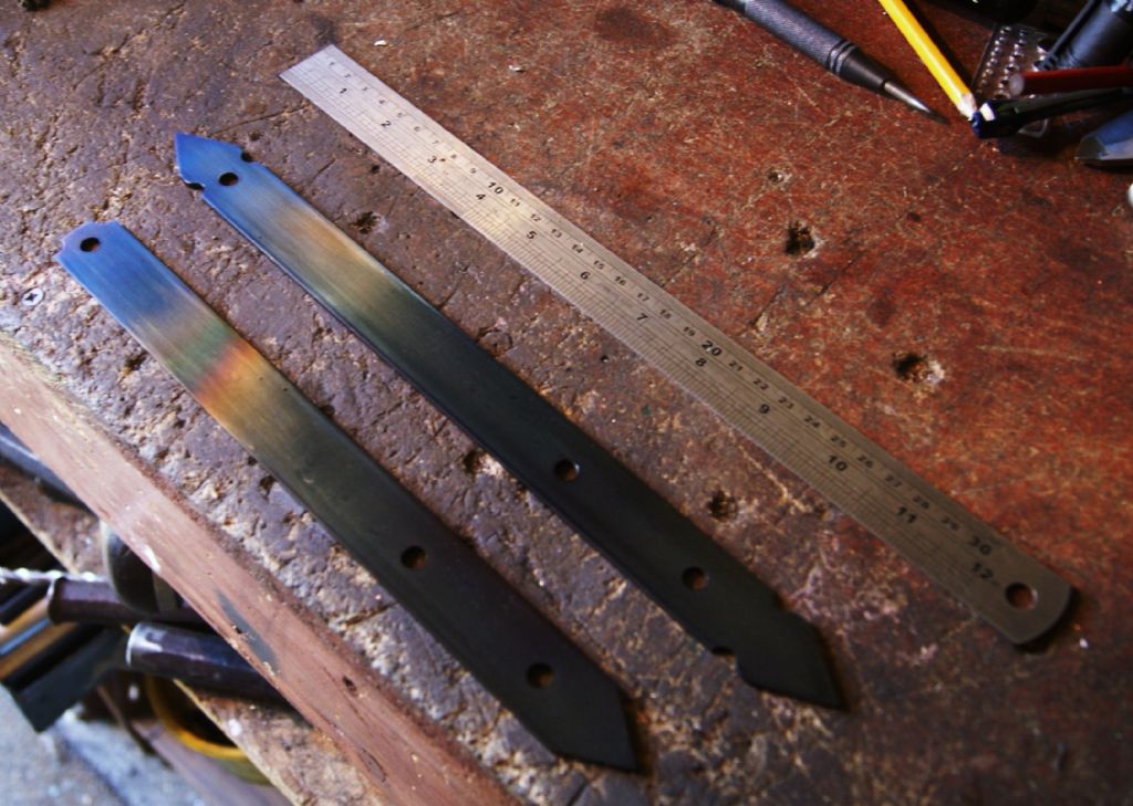

          john carruthers
            @johncarruthers46255
            This morning I made the front and rear plates, it's a start.
            Next I shall have a root round the scrap bins for some 12mm connectors to make the milling attahment.

                          john carruthers
                            I just refer to the pdf on the shed 'puta and print drawings as necessary.
                            The files do cover all the parts and how to make the tooling, plus Brian gives backup as required.
                            Day one, the plates ….

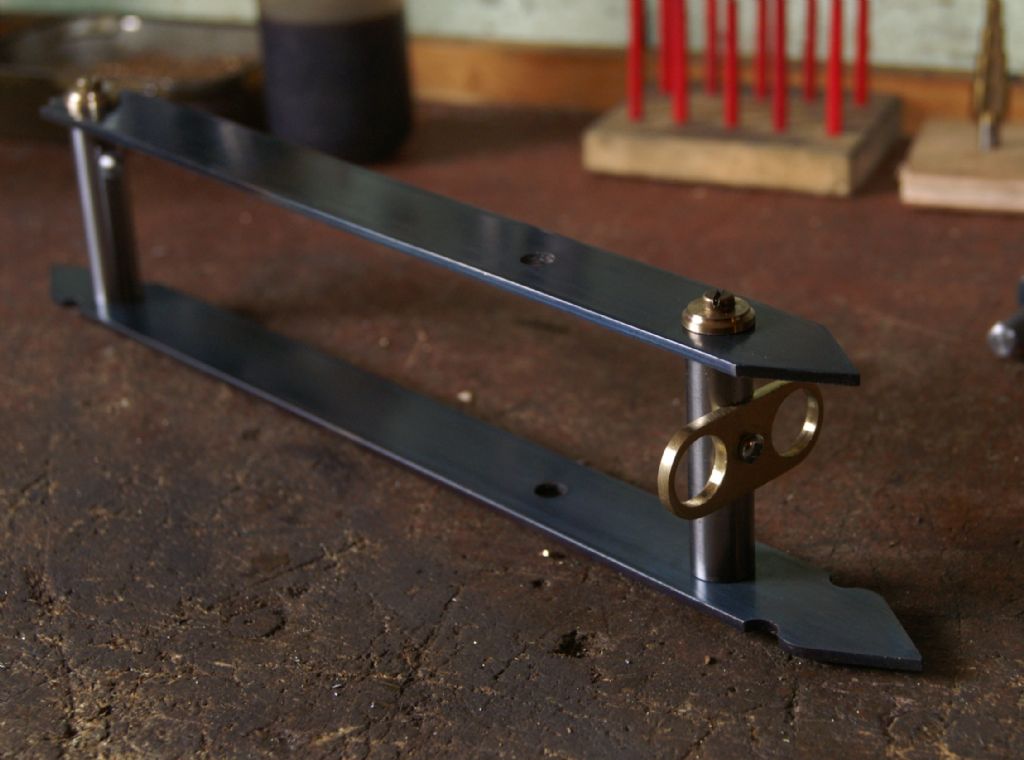

                            #237193
                            john carruthers
                              Today it was the pillars, washers and cord guide.
                              I milled the flats on the pillars rather than filing.

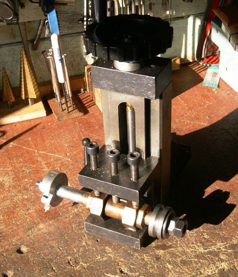

                                                  john carruthers
                                                    The home brew milling spindle for cutting teeth and slitting.
                                                    It needs a small motor and belt.
                                                    #237569
                                                      Hello John,
                                                      That's wonderfully practical. Would you like to do a short ewrite up for MEW that's as functional and to-the-point as the tool itself?
