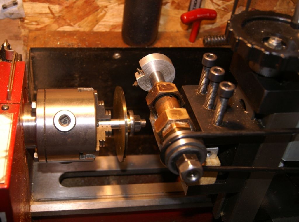

          Posted by john carruthers on 05/05/2016 08:09:13:
          The home brew milling spindle for cutting teeth and slitting.
          It needs a small motor and belt.
          John,
          I plan to build a similar spindle and put a request out on Freecycle for an old sewing machine motor. I was offered, quite promptly, two fully-functioning sewing machines to dismantle. It may be worth a try if it can save you a few pounds and reduce someone else's waste.
          Regards,
          James.
          #237939
          john carruthers
            @johncarruthers46255
            I found a small motor so now I just need a stretchy belt ~ 12" circumference / 3.8" dia.

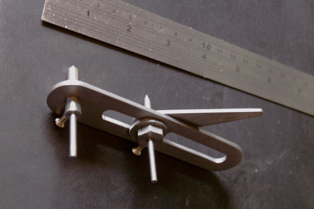

                #238751
                john carruthers
                  The Mk 1 depthing tool.
                  I shall fit a screw adjuster to make life easier,
                  #238755
                  Russell Eberhardt
                    @russelleberhardt48058
                    I made one like that and made the mistake of using a bit of brass bar for the body that I had hanging around the workshop. I then found that it had a slight curvature so the axles didn't remain parallel as it was adjusted. angry Remade it using gauge plate (without hardening).
                    Russell.

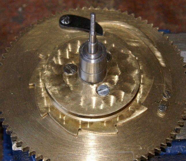

                                    #241580
                                    john carruthers
                                      I found treasure in great store, 1/8" brass plate, 28mm dia bronze bar…. laugh
                                      I then started rigging a flexy drive from the drill press to a tool post drill and thought ' this would be a better drive solution for the flycutter spindle' . idea
                                      So I know what I'm doing today.
                                      Click and spring roughed out, needs some better blued cheesehead screws and the spring hardened.

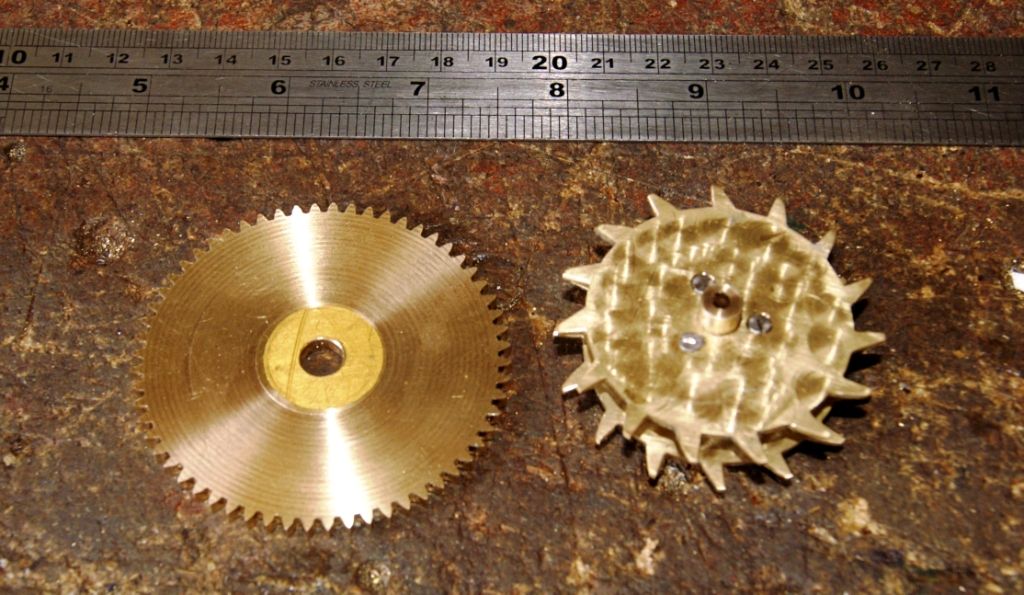

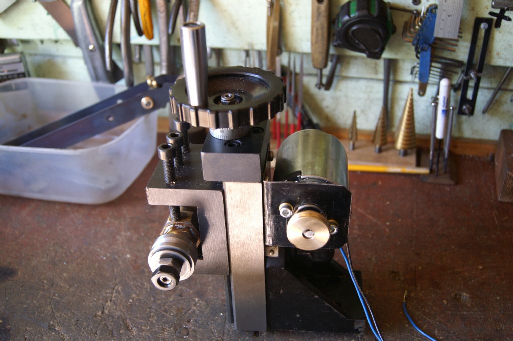

                                      #242957
                                      john carruthers
                                        The flexy cable drive wasn't so good, first load applied and it writhed about like a constrictor, ok for small drilling and polishing maybe.
                                        Luckily I found a discarded sewing machine in a layby and now have the motor from that driving the spindle via a belt.
                                        I'm making better progress now all is secure, the wheels look right.
                                        Made the escapement wheels and hub yesterday, looks like arbours and lantern pinions today.

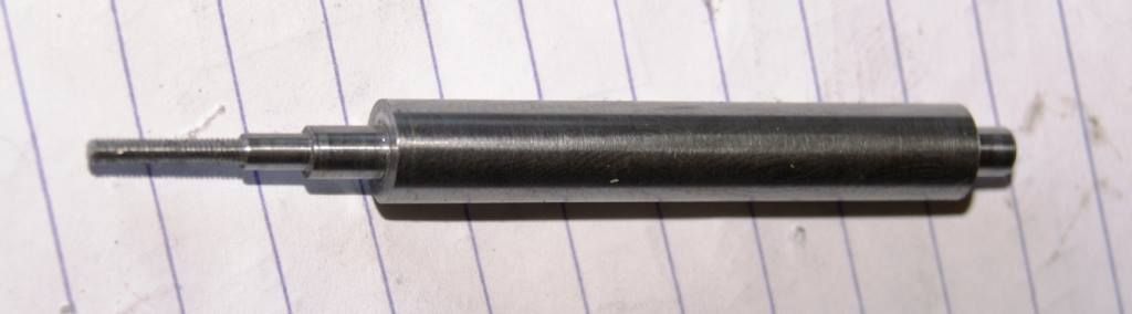

                                            #243241
                                            john carruthers
                                              I made a start on the minute pinion today.
