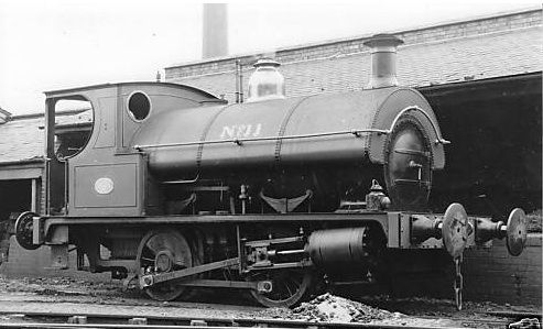

                    I’ve always had at the back of my mind an idea of building a brewery loco from Burton on Trent. They were nearly all 0-4-0 saddle tanks. This series will give me an idea of how to build the tank and secure it to the boiler.
                    #51305
                    Eric Cox

                        Eric,
                        I remember seeing an 0-4-0 shunter without a boiler, just a big reciever for high pressure steam. was it at the Bass Museum (AKA Coor’s Visitor Experience!!) or Coalbrookdale?

                          Neil,
                          Probably Coalbrookdale as the 0-4-0 at Bass Museum is complete.

                            Neil,
                            As you probably know these engines were known as Fireless Steam Locomotives.  The steam receiver would be charged from an existing static boiler in the factory and would operate for several hours before being re charged (depending on usage of course).
                            They were used where a normally fired loco could not be used due to dirt and smoke.  Examples were used in places when cleanliness was important such as food and paper manufacturing (and I presume breweries such as Bass), where the fire of a normal loco was a hazard such as munitions or where there was a copious supply of readily available cheap steam.
                            The last ones were made as late as the early 1960’s.  They had the advantages of being very simple and cheap to build and run, using readily available steam from an existing static boiler. They also had the advantages of steam power, e.g. high torque at low speed, no gearing, flexibility etc and were easy to maintain due to their simplicity.
                            There are several preserved and sometimes run being charged with steam from the boilers of normal locos.
