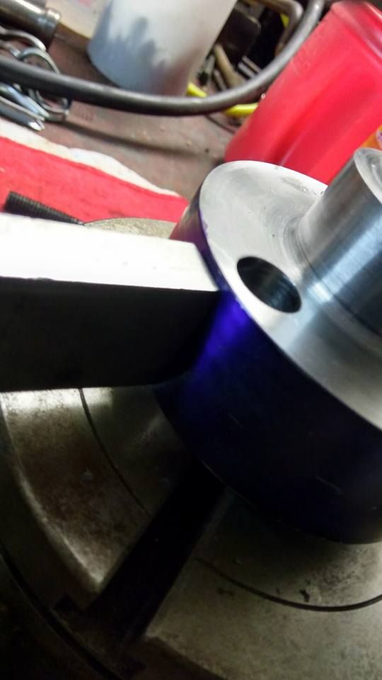

          Sorry to dredge up the dark past here. I joined this site specifically for this post. Hopefully you don't mind helping out an old Yank.
          I have a 1948 Clausing 111, and I despise the threaded spindle nose. Never liked them. This lathe had been relegated to being used for winding coil springs. She was tired and busted up. fortunately the castings were not in bad shape, and the bed cleaned up with a light stoning and mild scrape. The spindle is another matter, as it is bent a little, and the nose threads are worn. Compounding this is the fact that I made a mistake when I was getting this thing working in the first place, and faled to note that the spindle thread was Whitworth, and threaded my backing plates 60 degree USS. Live and learn… Weighing options, I decided that a new spindle with a more modern design would fit the situation best, as I could have reverse in addition to leaving clapping chucks behind.
          I'm at the point where I need to get a precise location for the cams, both axially and radially. I feel like I can perhaps infer the location, but I'd rather be certain. I have made up a 'dummy' which will be used for fixing chucks to the table on my shaper, and the spindle itself is ready for radial drilling.
          I will have to learn how to attach images, as a picture is worth………………
          Thank you in advance,
          Will

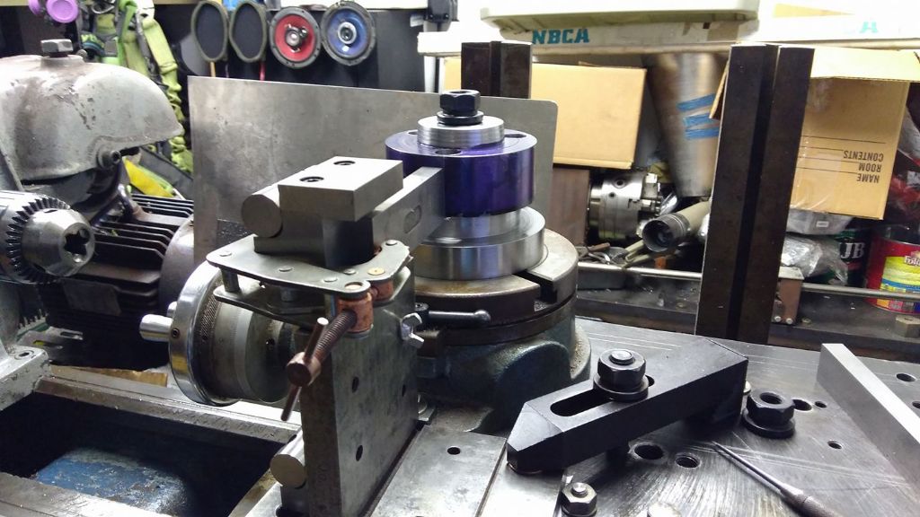

          #288176
          Willliam Powell
            @willliampowell36769
            17191870_10208141685047700_7650288234243121325_o.jpg17203020_10208132477737523_1780570570220283929_n.jpg16716344_10208016258352111_290591600877917245_o.jpgOk, Pix's.
            #288210
            Tony Ray
              @tonyray65007
              Will,
              That's looking good. I'm sure I have a copy of the drawing somewhere and will PM it to you over the weekend. For my rotary table fixture project I managed to get hold of a D1-3 nosepiece and used that.

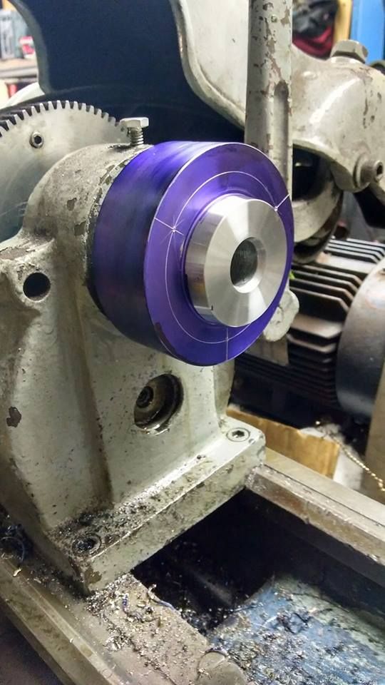

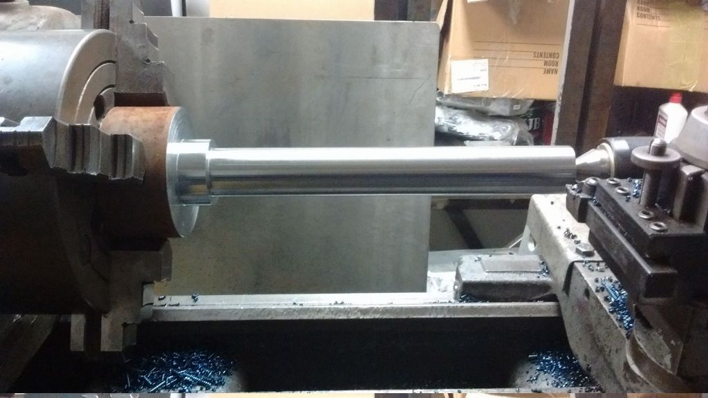

                Willliam Powell
                  Well thank you.

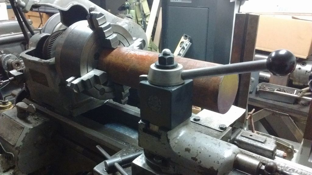

                  I set up the dummy part which will end up being the milling fixture, and have been doing some trial layout and inferences about the position of the cams. I bought a set of cams from MSC, but will make the second set.
                  more photos to come as I get them transferred to the gonkulator.

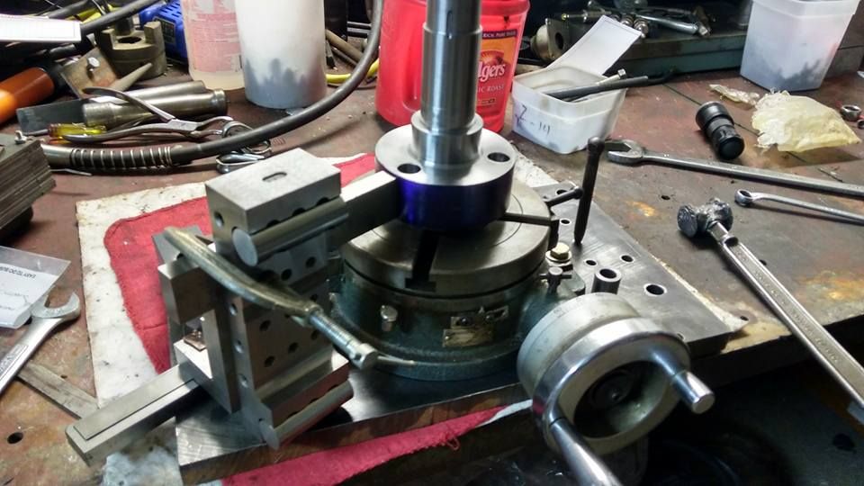

                    Willliam Powell

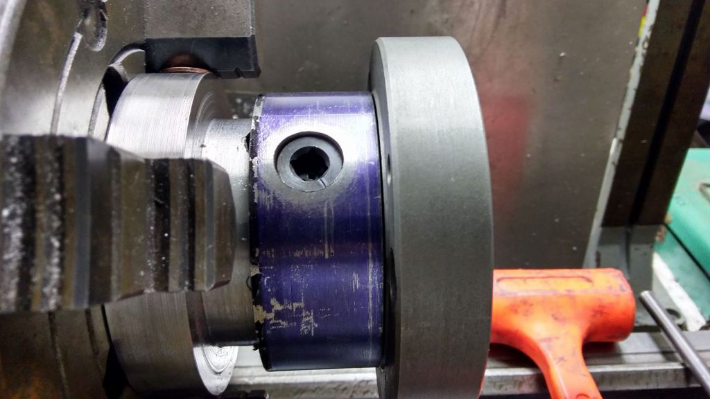

                      Well, I got excited and decided to take a whack at cam placement by inference. by using a set of purchased cams, (Whew – expensive), and fiddling around with them on the backing plate I bought, I got some preliminary numbers and decided to punch out the test fixture. I'm not entirely sure about my angular placement, but it's close.
                      I misestimated the engagement depth, but cheated it by extending the pins by one turn out from the gaging line. It worked.
                      I'm still hoping for real dimensions before I start making chips on the spindle. I could afford scrapping the test fixture, as it was a piece of fall off from my supplier, and I paid a couple of dollars for it.

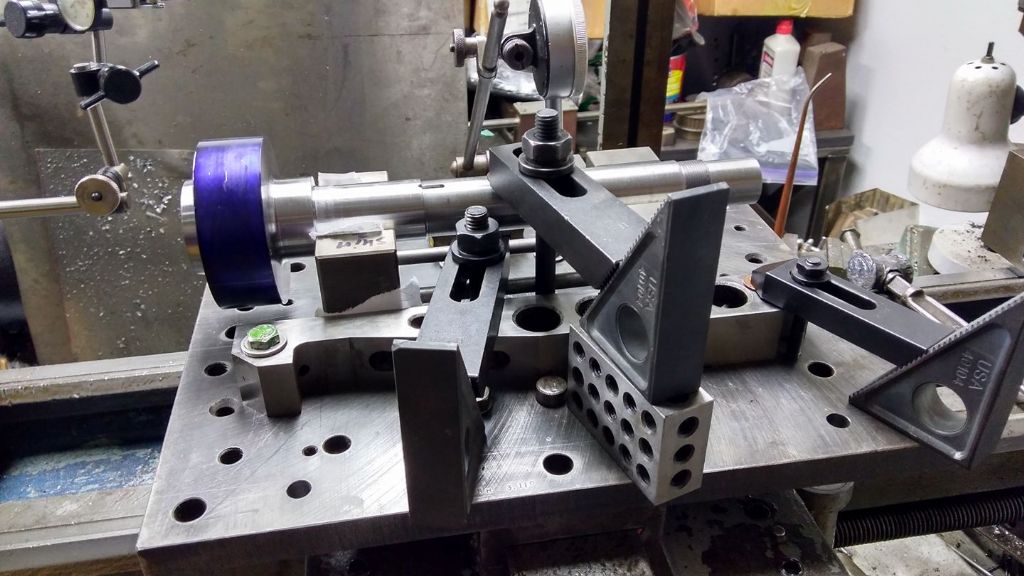

                        #288807
                        Willliam Powell
                          17192472_10208162101278093_4994420313139464473_o.jpg17190486_10208187861922093_3857498094251109166_n.jpgCourtesy of Murray (Muzzer), I have the spindle specs I needed to make this thing right. Thank you sir!
                          my inferred cam position was off by 3 degrees radially and 0.070" axially. It worked anyway, but did not feel right, and as I posted above, I had to extend the pins one turn.
                          I have redone my layout and its back on the platen in the lathe. (I don't have a mill).

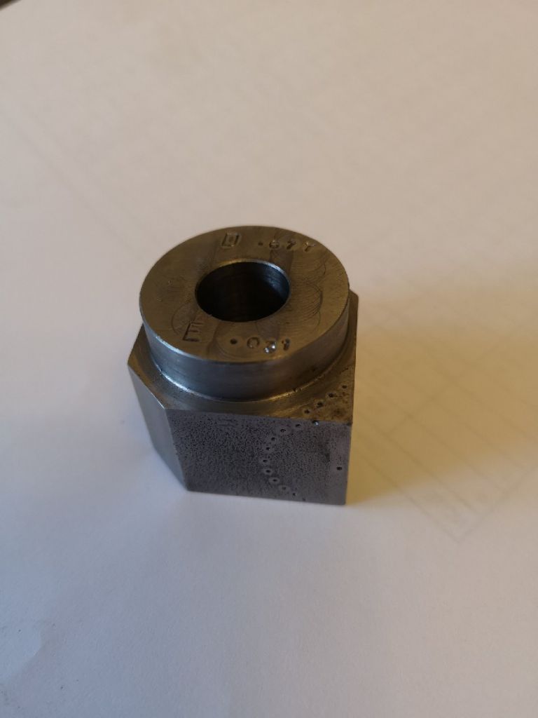

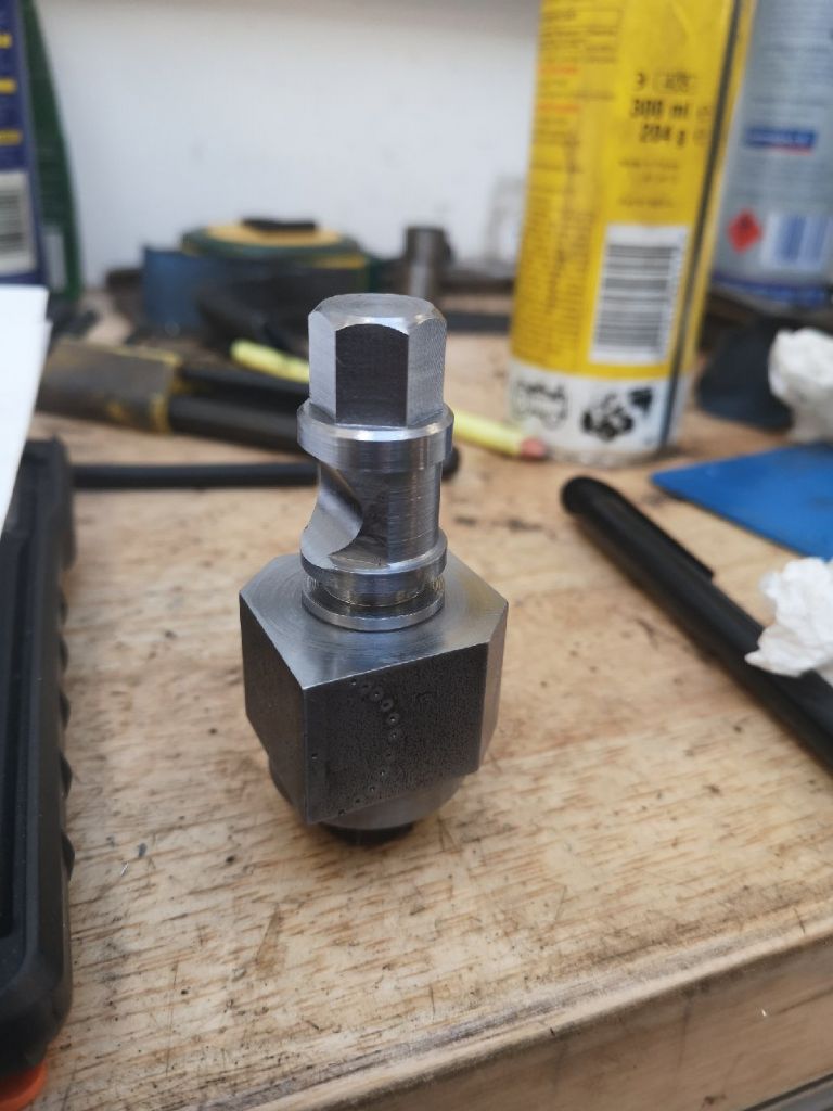

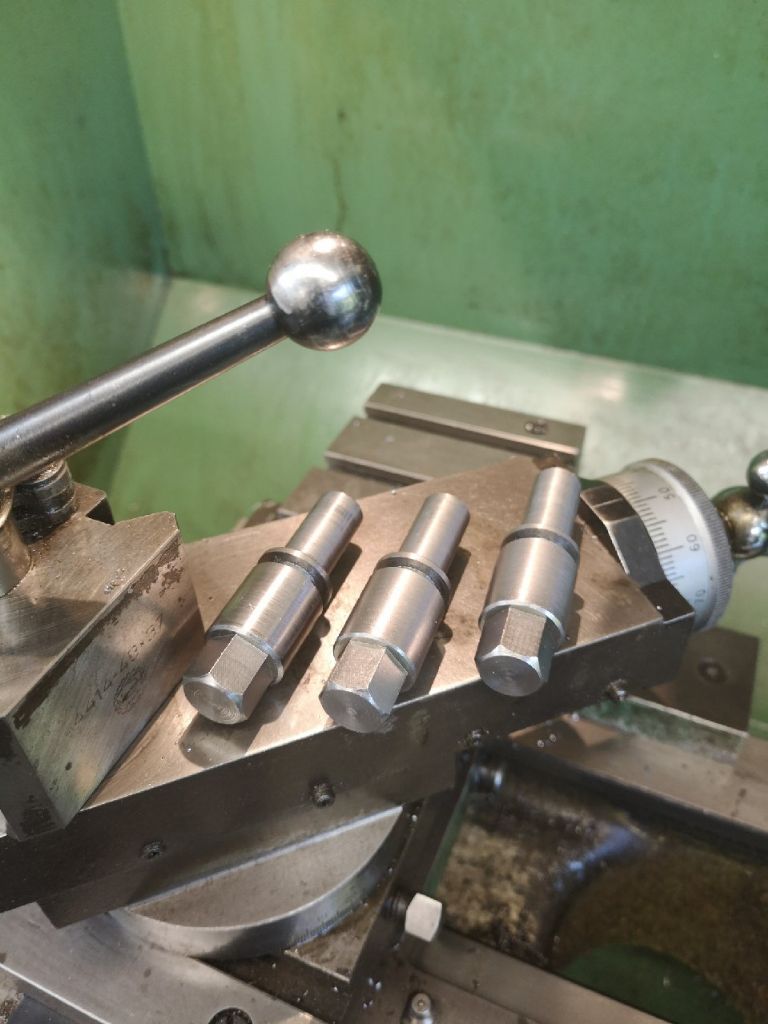

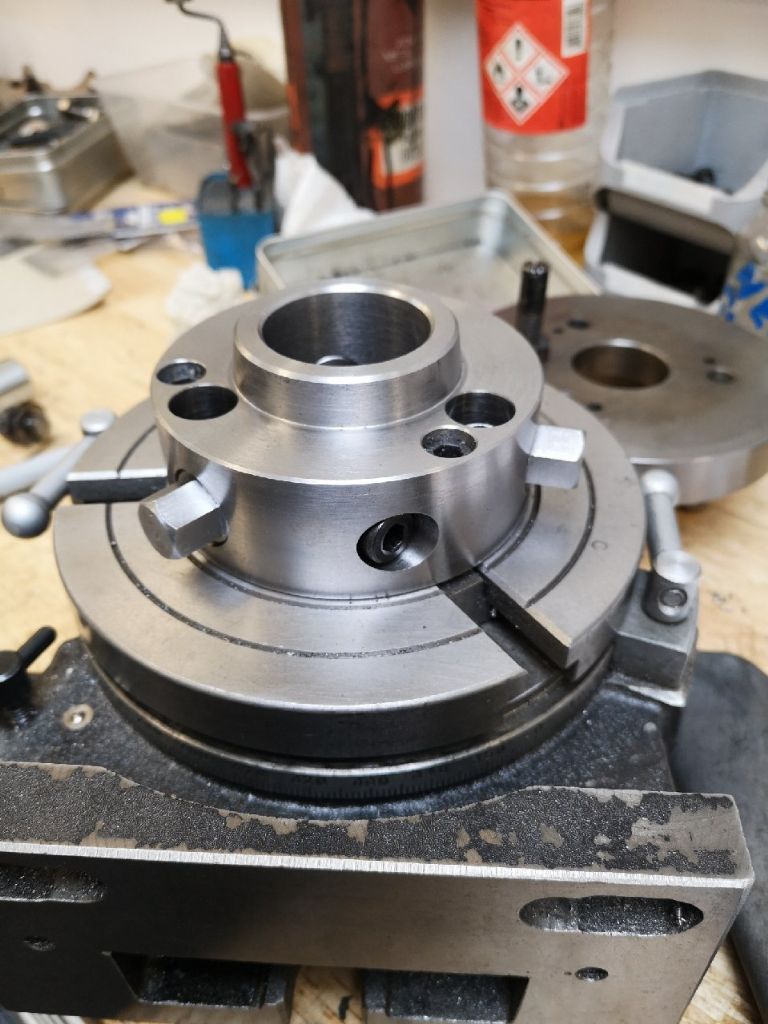

                            Having just bought a rotary table with a controller attached, the idea of being able to move chucks direct from the lather to the rotary table appealed. I read this post and exchanged notes with Murray and set to. My design is based on the standard but differs from Murray's in that my rotary table only has three slots which makes things easier, I also put hexagon heads on the cams but stayed closer to the standard stop bolt orientation to keep the height of the adaptor to a minimum. I did not bother making the spring loaded stop bolt arrangement but could add this later I suppose.
                            The standard is not so easy to use as it gives design detail for the full range of cam lock spindles but you can puzzle it out.
                            I came across another post questioning the design of the cams themselves so I thought it might be useful if I shared my understanding and the method of making them.
                            The first question was about the cam profile and the angle "v" on the standard. I am on the same page as Murray here and believe that the cam profile is in fact a circle – with a bit of geometry you can work out that for the D1-3 cam the diameter of the cam portion is 0.677" and it is eccentric to the body of the cam by 0.031". The angle "v" on the drawing essentially shows that the required cam action occurs over this angle, the dimensions "d" and "e" tell you the extent of the cam action. having made them to this scheme I can confirm that it all works fine.
                            When it comes to making them I started with three blanks featuring a chucking piece on the inboard end of each blank. The outboard end is extended versus the standard to take the hexagon rather then the square hole as specified.
                            I have a smallish 3 jaw chuck with a large hexagon shaped lump on the back in place of a back plate – I use this in the milling machine to put the hexagons on.
                            Next I made up a little jig block that in based on a square but has a hole for the chucking piece through it offset by the required 0.031" eccentricity. It also has a register at the same eccentricity to allow it to be held in the 3 jaw to turn the eccentric cam. I also added flats on the block at 45 degrees to facilitate the later machining of the 45 degree feature.
                            Let me just add a photo of that….
                            #409757
                            IanH
                              @ianh
                              This is then used first of all to machine the eccentric cam, then whilst still in the jog, the cam is trasferred to the milling machine for all the subsequent operations….the cut out to clear the cam lock pin, the 45 degree face and the hole for the stop bolt detent. Note that getting these features in the right orientation to each other is important so I marked up the jig to show this and also made sure that the hexagon was aligned consistently with the other features. I aligned the hexagon anticipating leaving off the detent feature and needed a way to indicate that the cam was disengaged.
                              Here is a cam ready for de-burring.
                              Once de-burred the chucking piece can be machined off and everything fitted together for testing. I added a centre pop on the end of each cams hexagon indicating the position when the cam was fully released.
                              The first picture in the previous post shows the finished item ready to go – maybe I will add the detent, but for now I have to get on with some other things so that will wait for another day.
                              Thanks to Murray for kicking this all off – it is a great idea.
                              Ian
