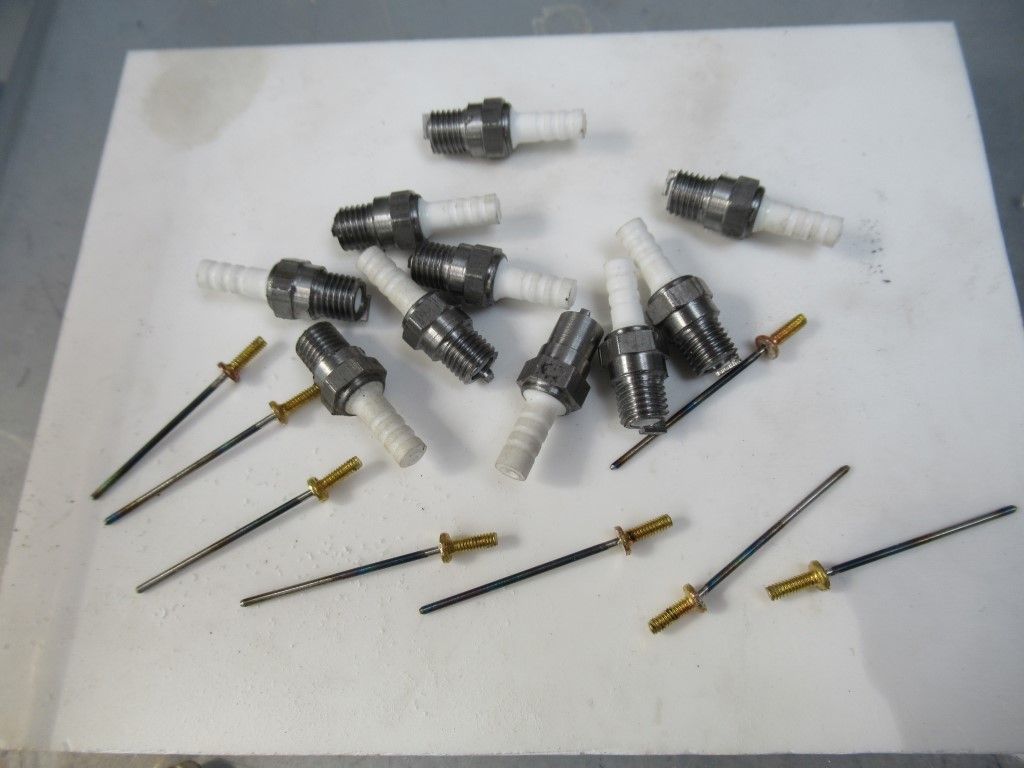

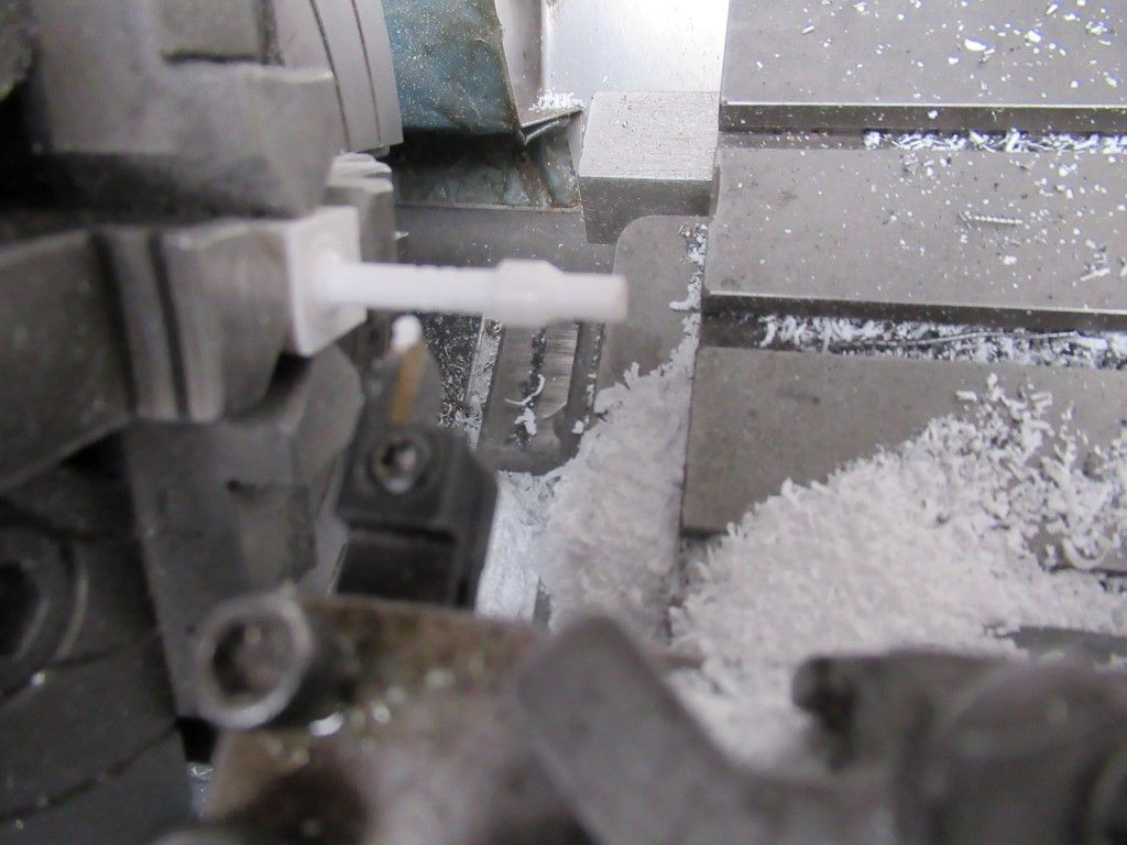

      The Corian being turned to fit the body and drilled through 1mm for the electrode

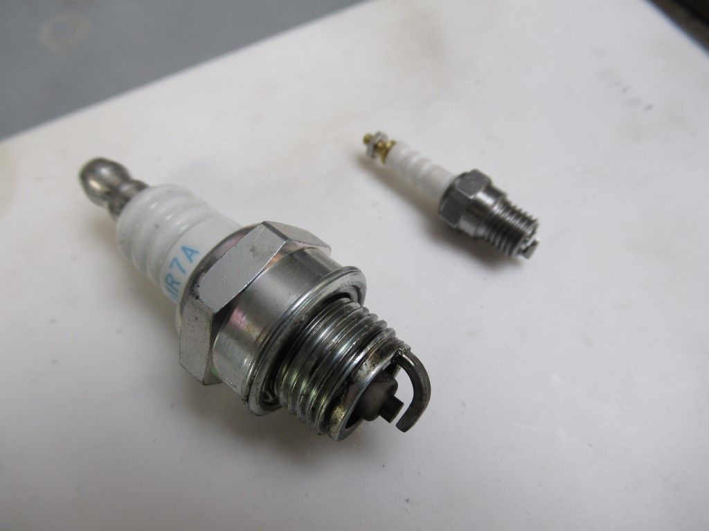

      The insulator is loctite'd in , i also left a slight 'lip' on the top of the body and this was pressed over slightly holding in the insulator. I soldered some brass thread to the tungsten ready for being loctite'd in place
      Finished plug

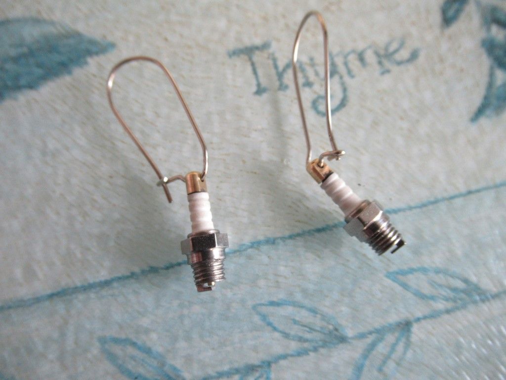

        While i was in the grove i made a couple of even smaller plugs into earings for the Gf.

          Never made spark plugs, but doesn’t Corian start melting over 100c?

              Posted by Russ B on 22/06/2020 18:51:10:
              No idea but researching on the internet it would seem it has been use by others ok.
              If they fail i will get my wallet out and buy some.

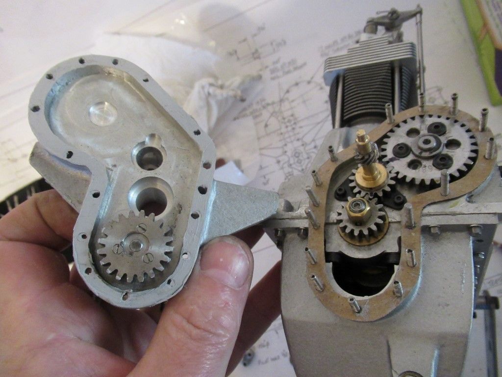

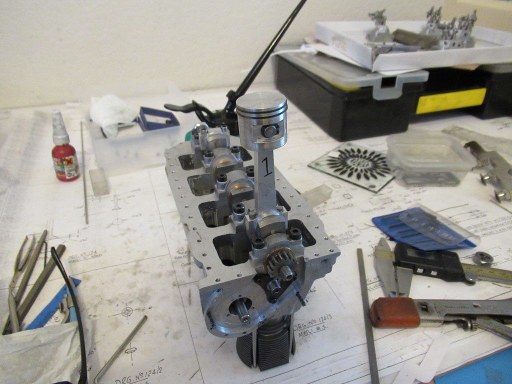

              #483378
              David K
                @davidk77137

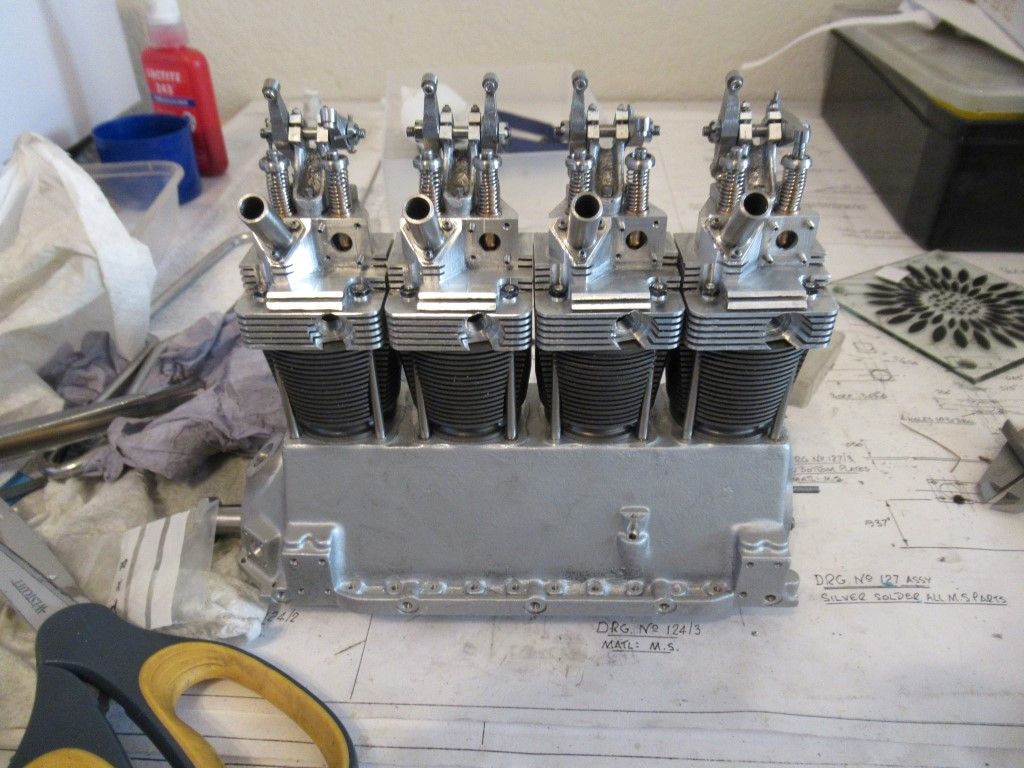

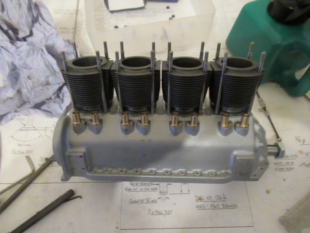

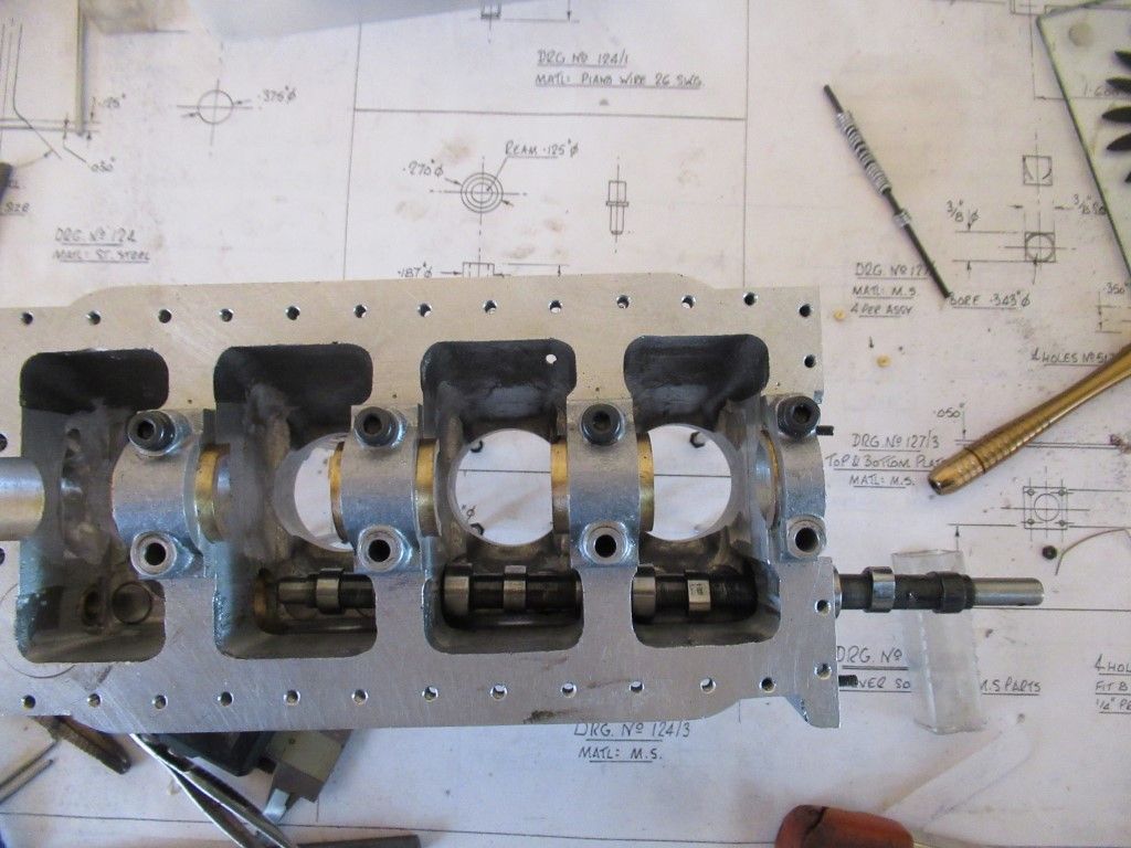

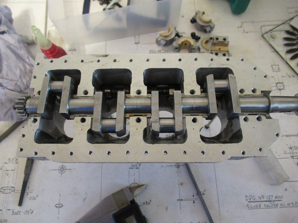

                A few pictures of building the engine up
                Camshaft
                Crankshaft
                Rods
                Barrels
                Heads
                #483381
                David K
                  @davidk77137
                  End case / oil pump
                  Timing camshaft

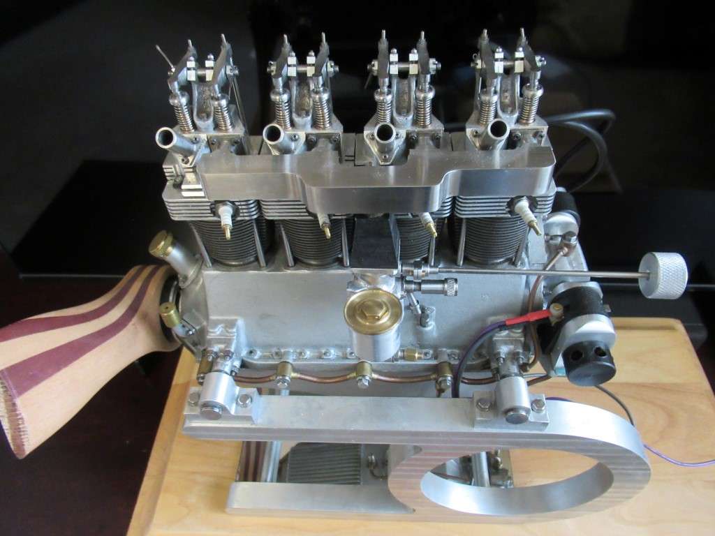

                  #483383
                  David K
                    @davidk77137

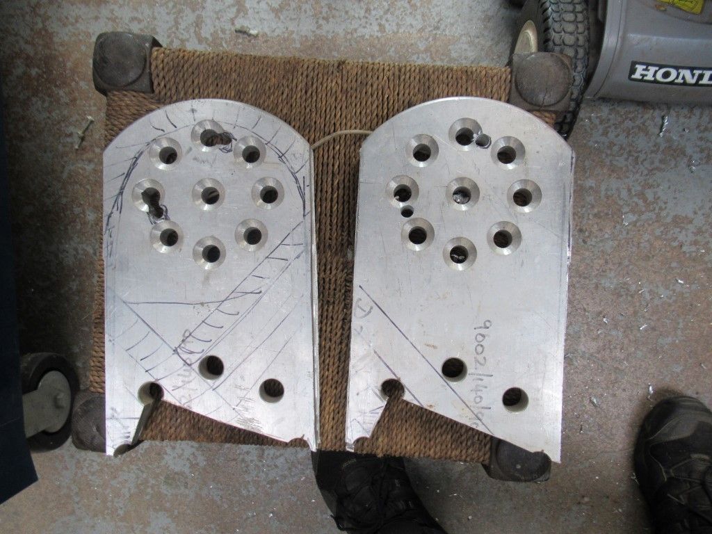

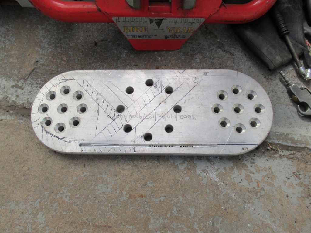

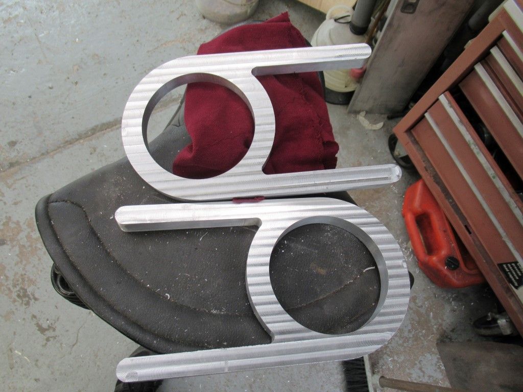

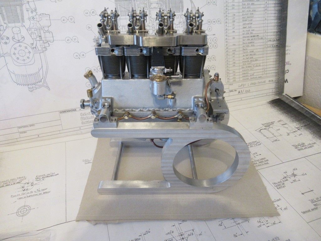

                    Time to make a stand , i was given a chunk of alloy a while back , apparently it was used for securing power lines and i have been wandering what i could use it for.
                    So i cut it in half with a slitting saw
                    Then milled away to form the stand sides
                    A couple of cross braces and engine mounts and i now have a stand . A bit unconventional but i like it.
                    #694700
                    David K
                      @davidk77137
                      Been a while since i last posted, unfortunately my health let me down so my time was taken up with getting myself better rather than standing in the garage.
                      Managed to finish the engine and give it a quick run, so happy when it fired into life even though it could do with a bit of fettling.
                      IMG_4968 (Medium)
                      link to video of engine run;
                      https://youtu.be/GXLUaQq-_zs?si=N6cBMBOcRxEDFWeE
