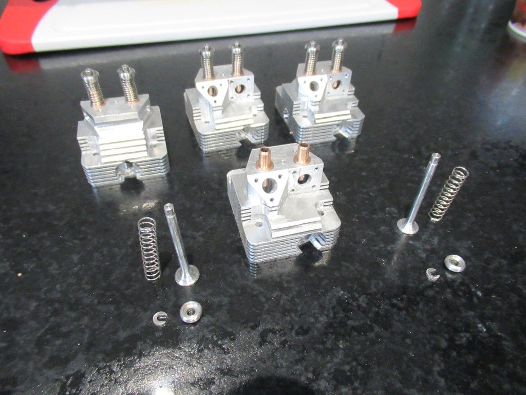

                    @davidk77137

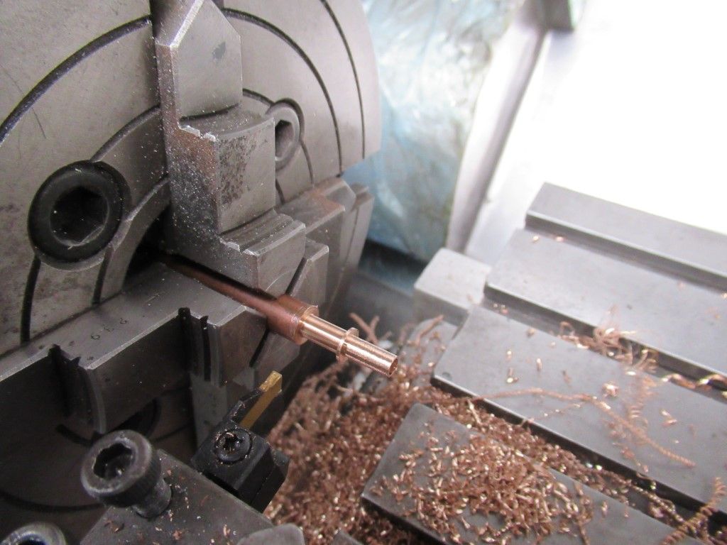

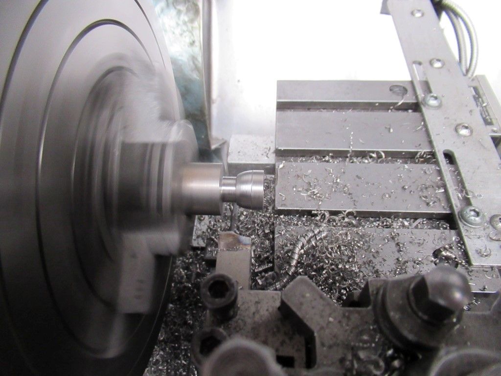

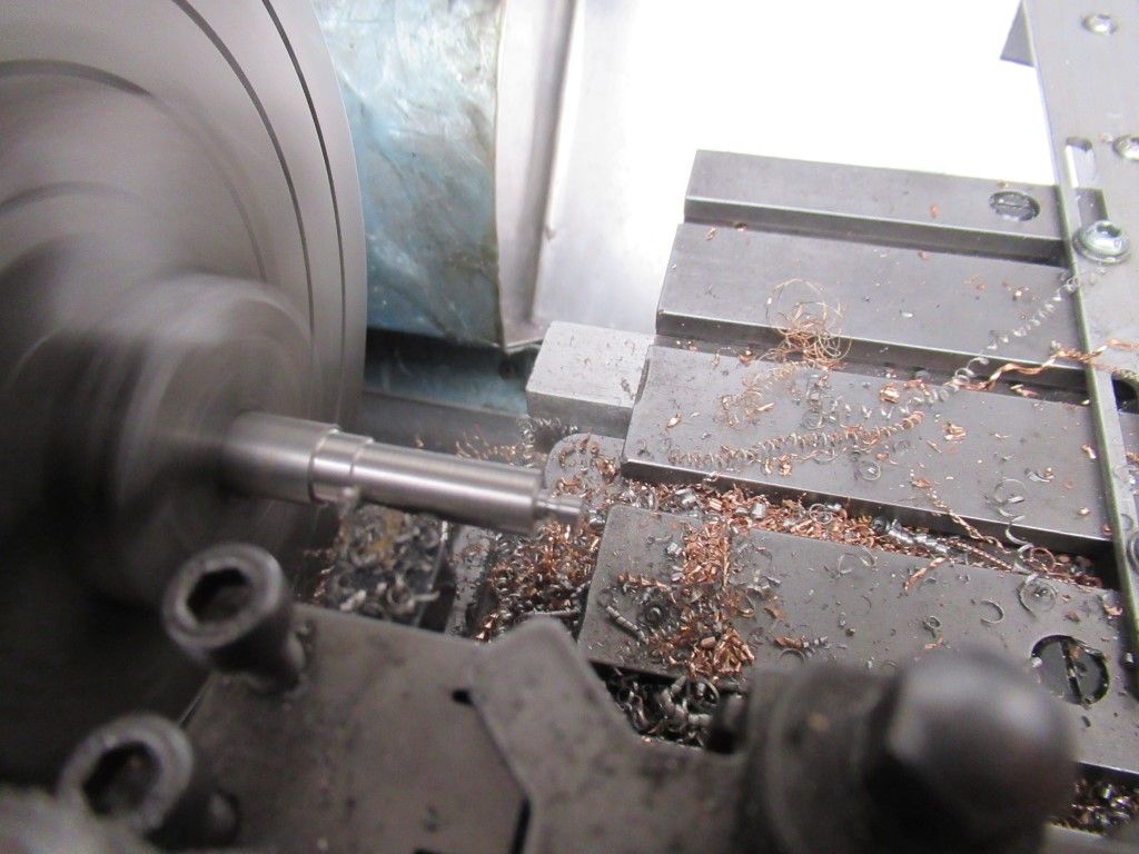

                    Turned some valve guides
                    I turned the valves a section at a time to help minimise flex in the material
                    Once complete a fine skim and polish before parting off
                    Valves complete with collets and caps , springs were bought items.

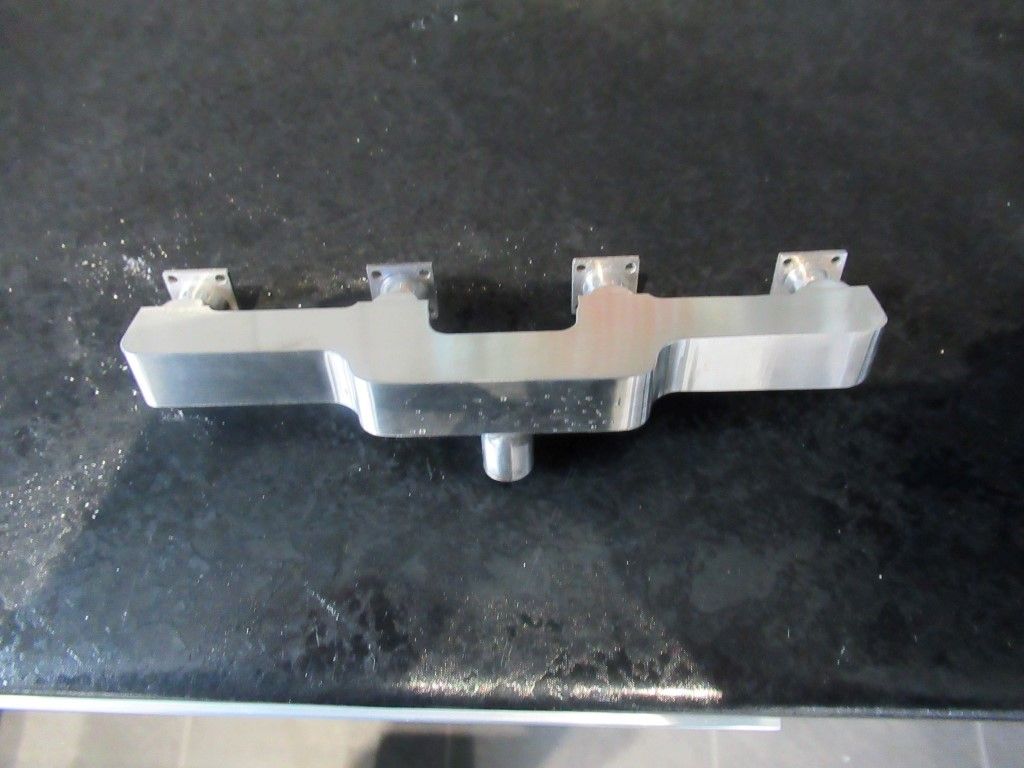

                    #456338
                    David K
                      @davidk77137

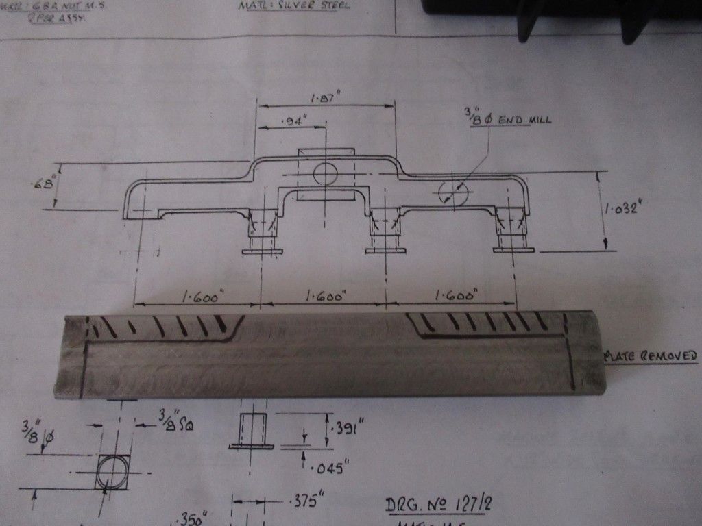

                      Machined the shape out on the mill
                      Turned the inlet stubs
                      Then finished them on the mill

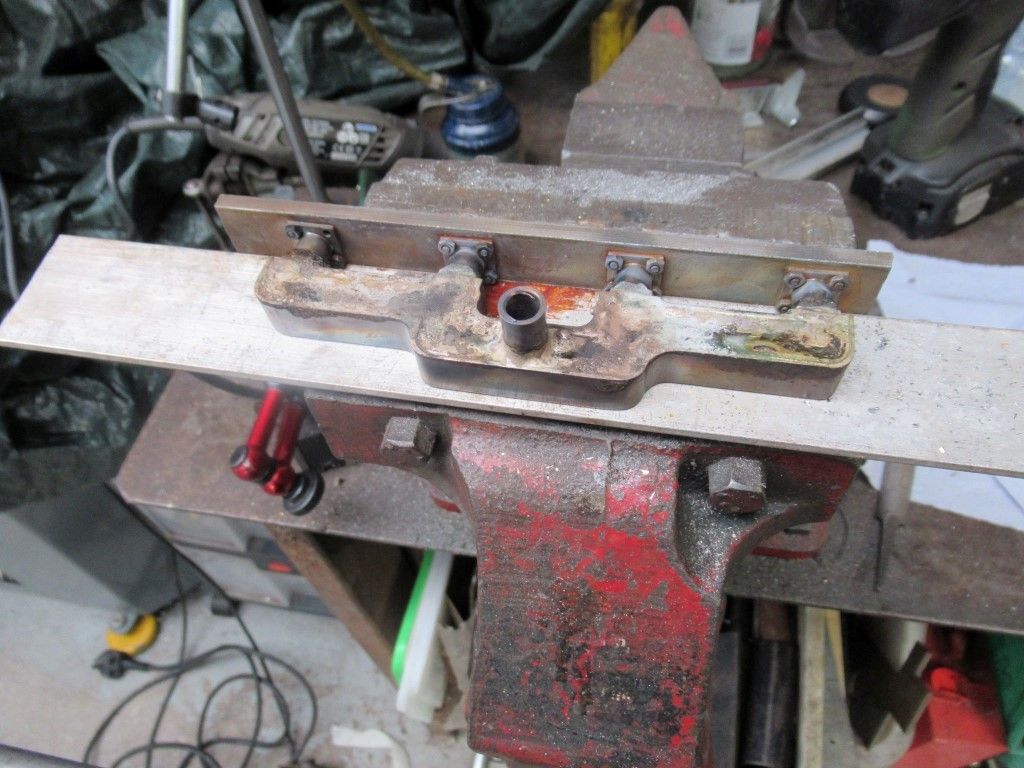

                      #456341
                      David K
                        @davidk77137
                        Made a jig to hold the stubs ready for Silver solder
                        Then soldered in the bottom plate ,
                        I soak in citric acid and then polish

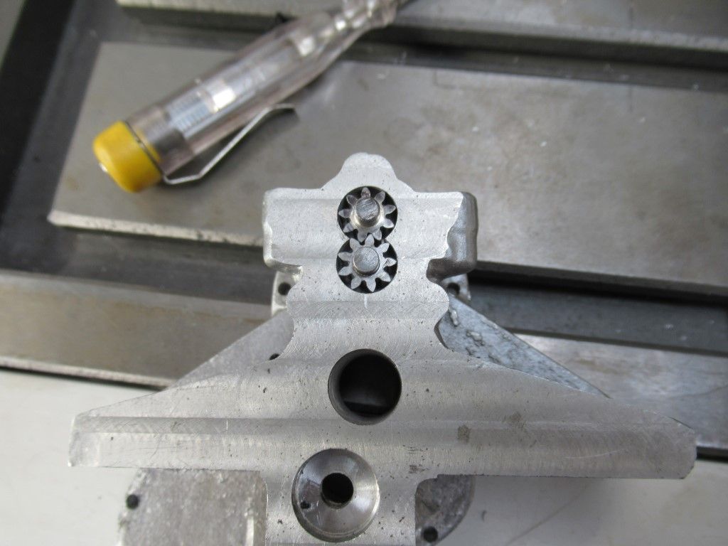

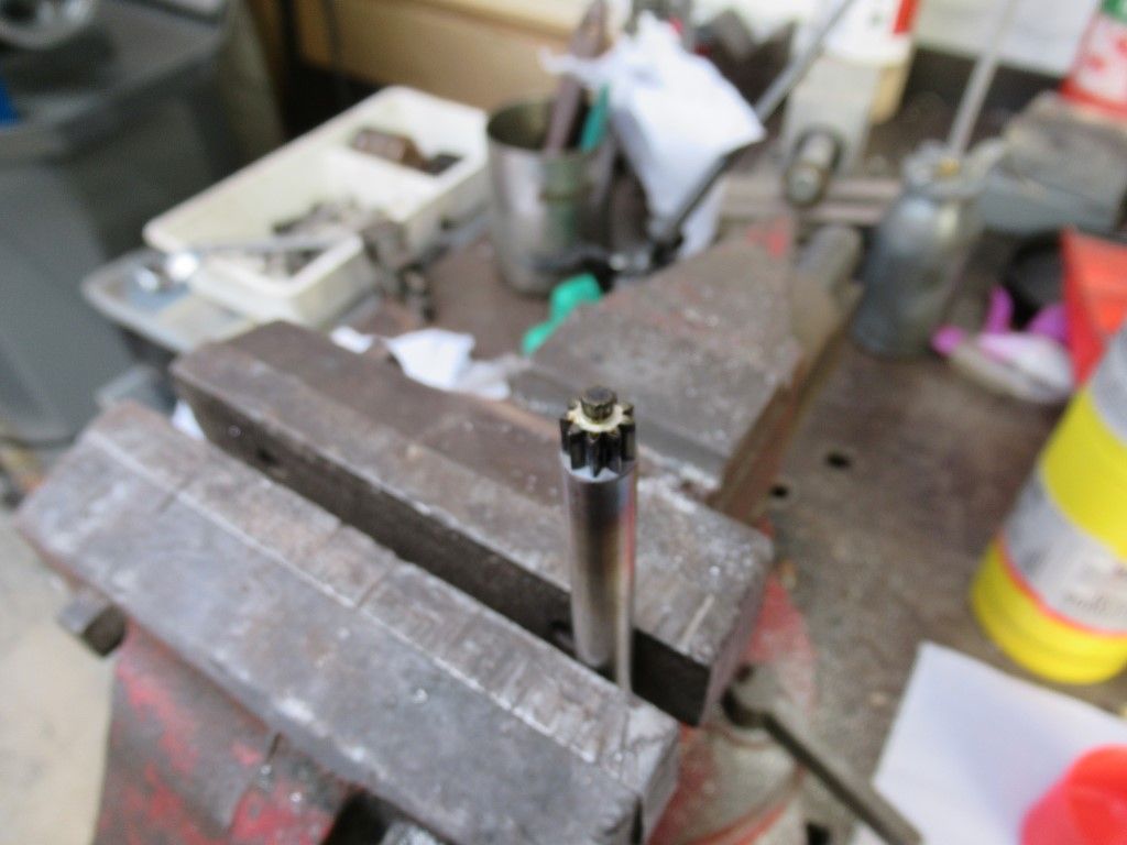

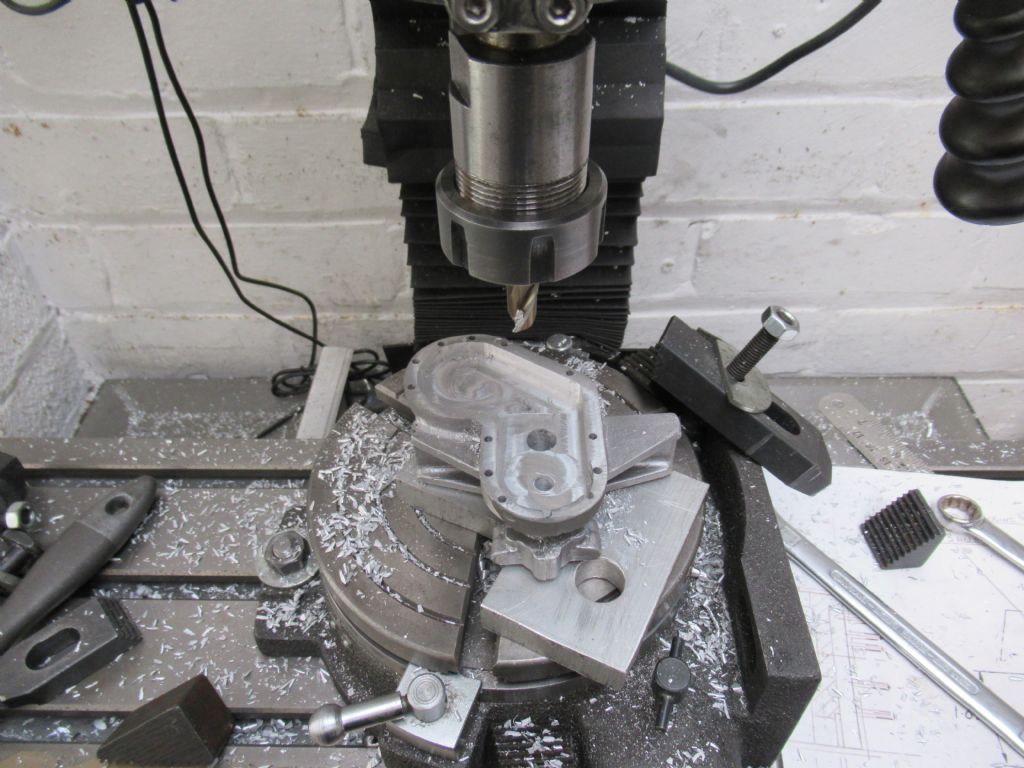

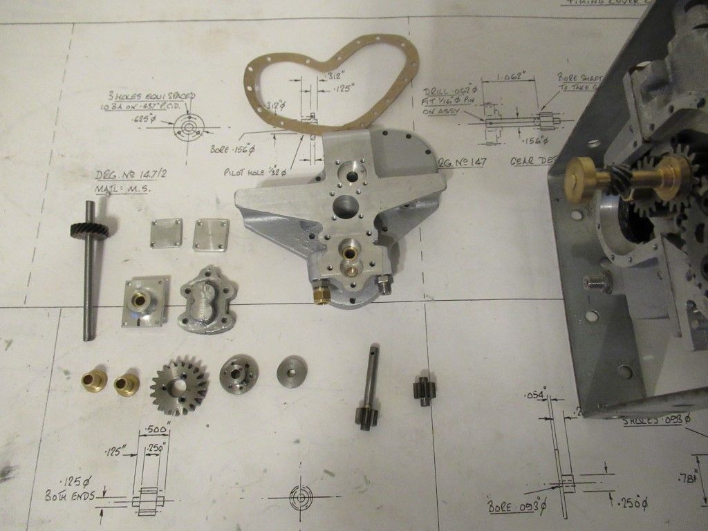

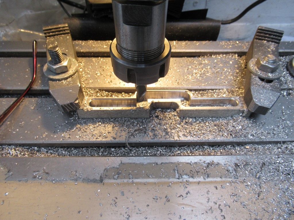

                          Started to mill out the end casing
                          Boring the oil pump
                          Silver soldered the oil pump gear to the drive shaft

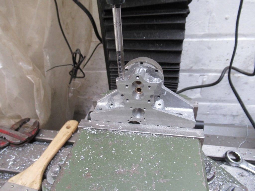

                            Tapping for the inlet/outlet unions
                            The end case and parts ready for trial fit

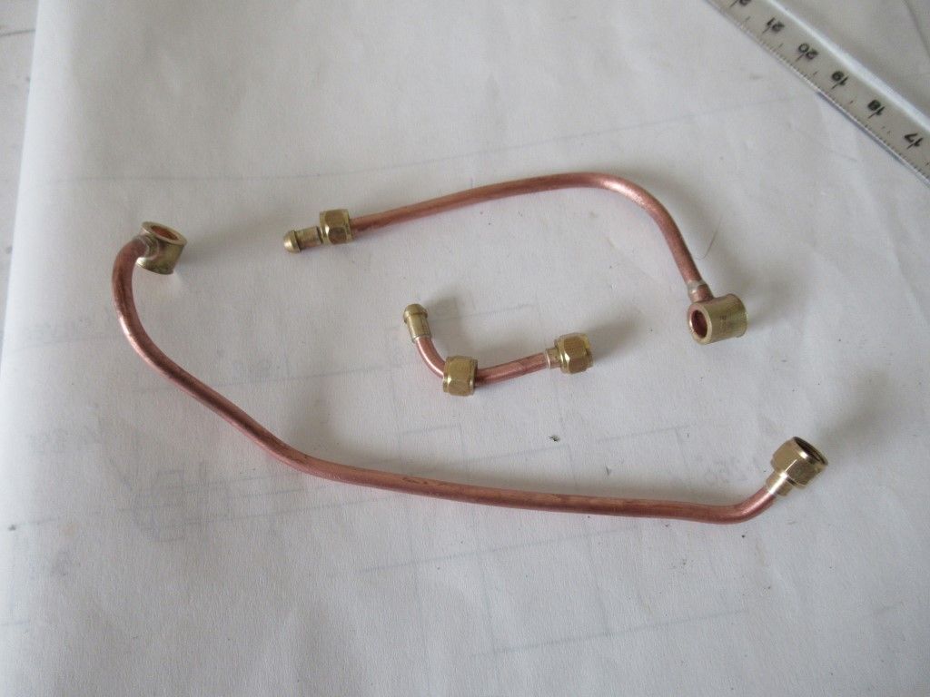

                            #480586
                            David K
                              @davidk77137

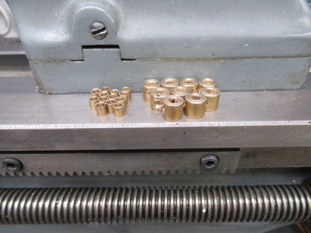

                              Turned some brass parts to make the oil line unions
                              Silver soldered the parts
                              Made a jig to join the unions
                              Some extra pipe work

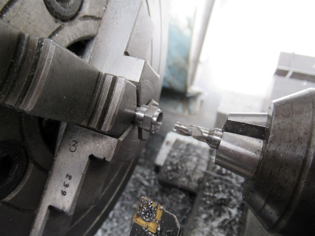

                              #480587
                              David K
                                @davidk77137

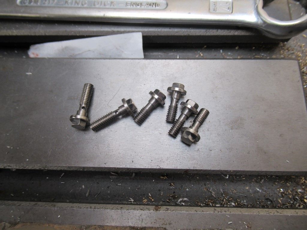

                                Made some union bolts
                                Milling the hex
                                A quick polish
                                Fitted to the engine

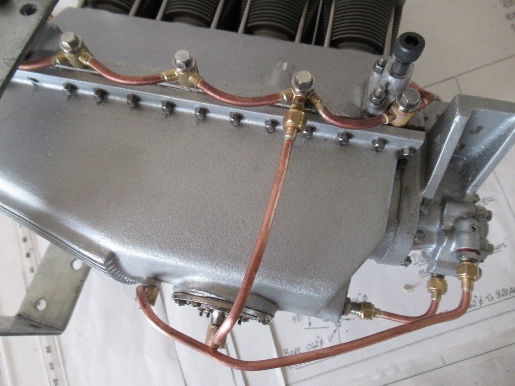

                                      Beautiful work which I could not come near to, but should the lower pipe under the sump not be routed under the mid position pipe closer to the sump which would look much better?
                                      #480697
                                      David K
                                        @davidk77137
                                        Hi it is routed as the plans described , I presume this is how they route on a full size engine.
                                        Also i think the angle of the picture makes it look a little more untidy.
                                        #480708
                                        Emgee
                                          @emgee
                                          Hi David
                                          I am not certain but guessing that on the full size any such pipes would be clipped at one or more points to avoid damage by vibration, same with fuel lines and electrical cables, not good to have any of those damaged.
                                          Nice work on the engine.
                                          Emgee
                                          Edited By Emgee on 18/06/2020 13:41:26

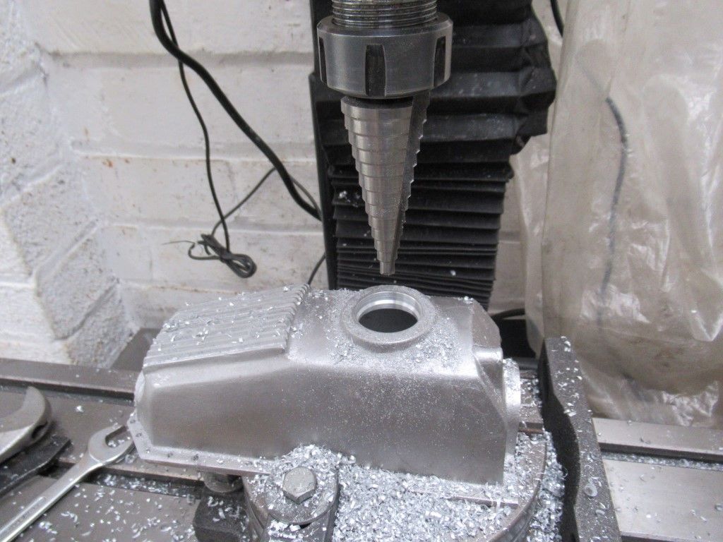

                                            David K

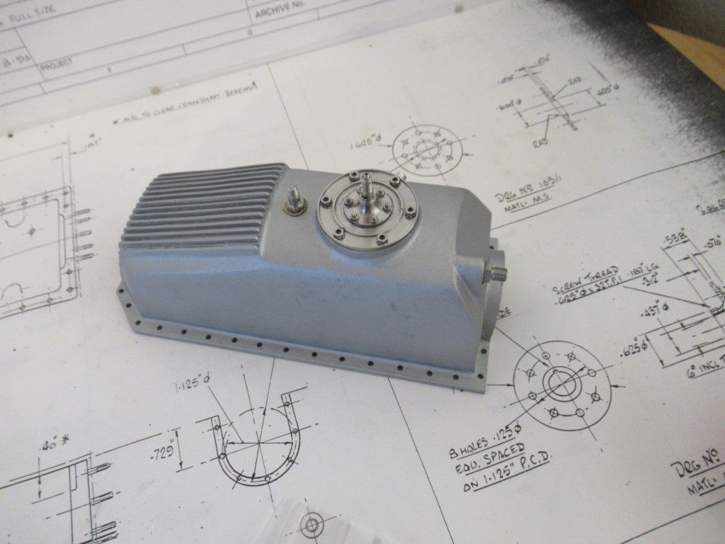

                                              @davidk77137

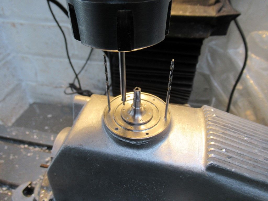

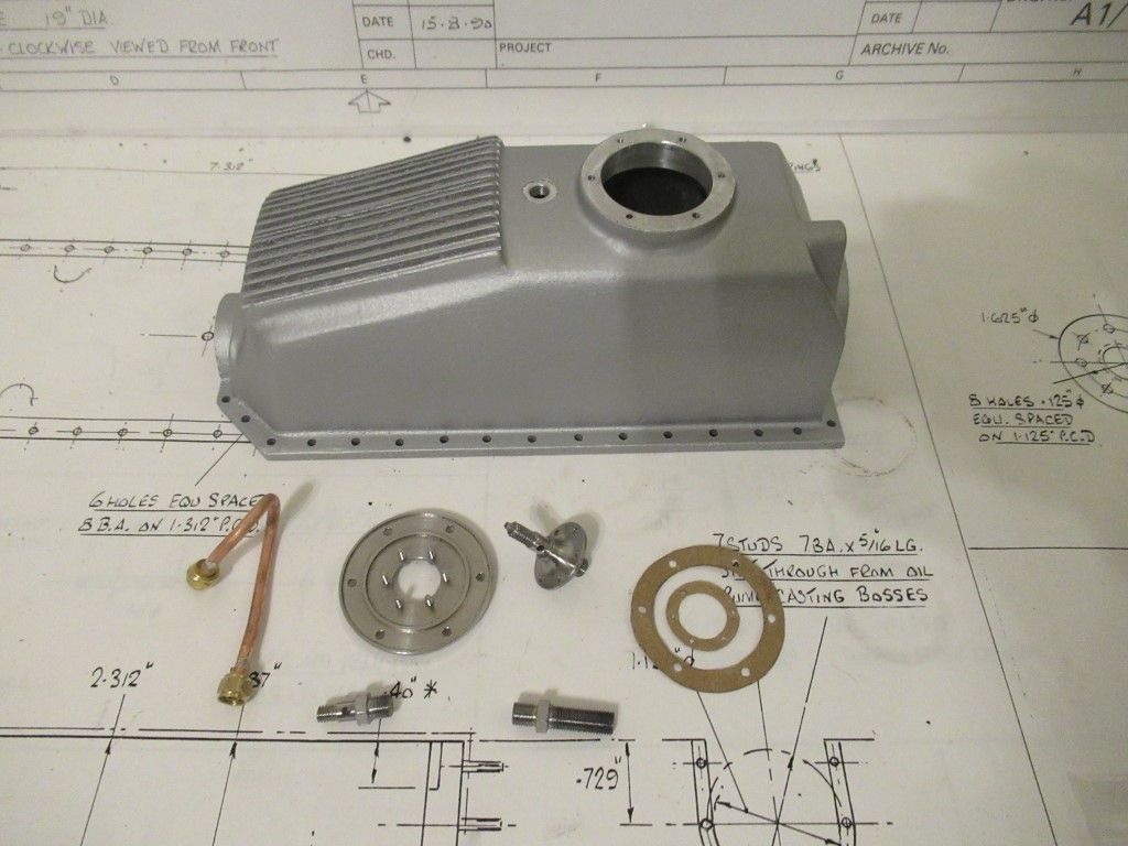

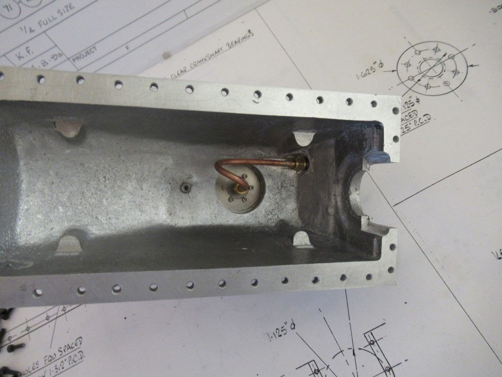

                                              I milled the cooling fins on the sump underside
                                              then drilled through for the sump plate
                                              The sump plate and oil union made from stainless
                                              These are the parts to be fitted to the sump
                                              The oil feed from the pump runs through the sump before running up to the main bearing

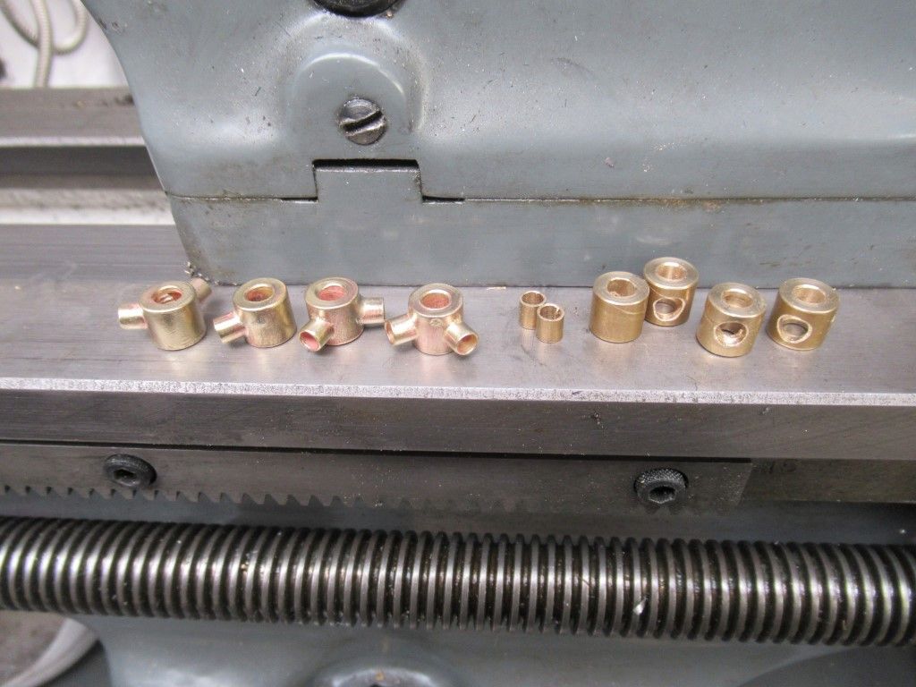

                                                  @davidk77137

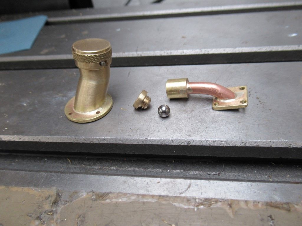

                                                  While i was soldering the oil lines i cut some brass tube and made the oil filler and
                                                  breather pipe.

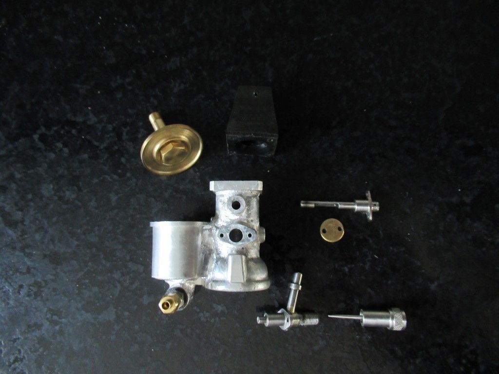

                                                    @davidk77137

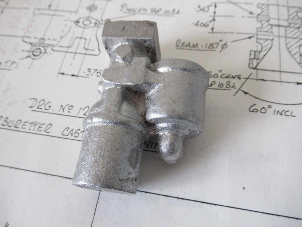

                                                    Casting for the carburettor was a little rough looking
                                                    Tried to tidy it up as much i could while opening up the float chamber and bore
                                                    The float chamber is a dummy so the fuel runs directly to the jet and metered by a needle.
                                                    I made these from stainless and also a brass float chamber lid and butterfly.
                                                    Carb and manifold

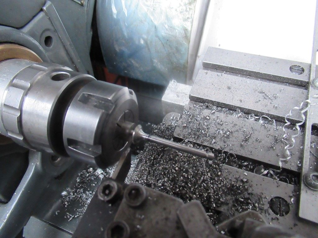

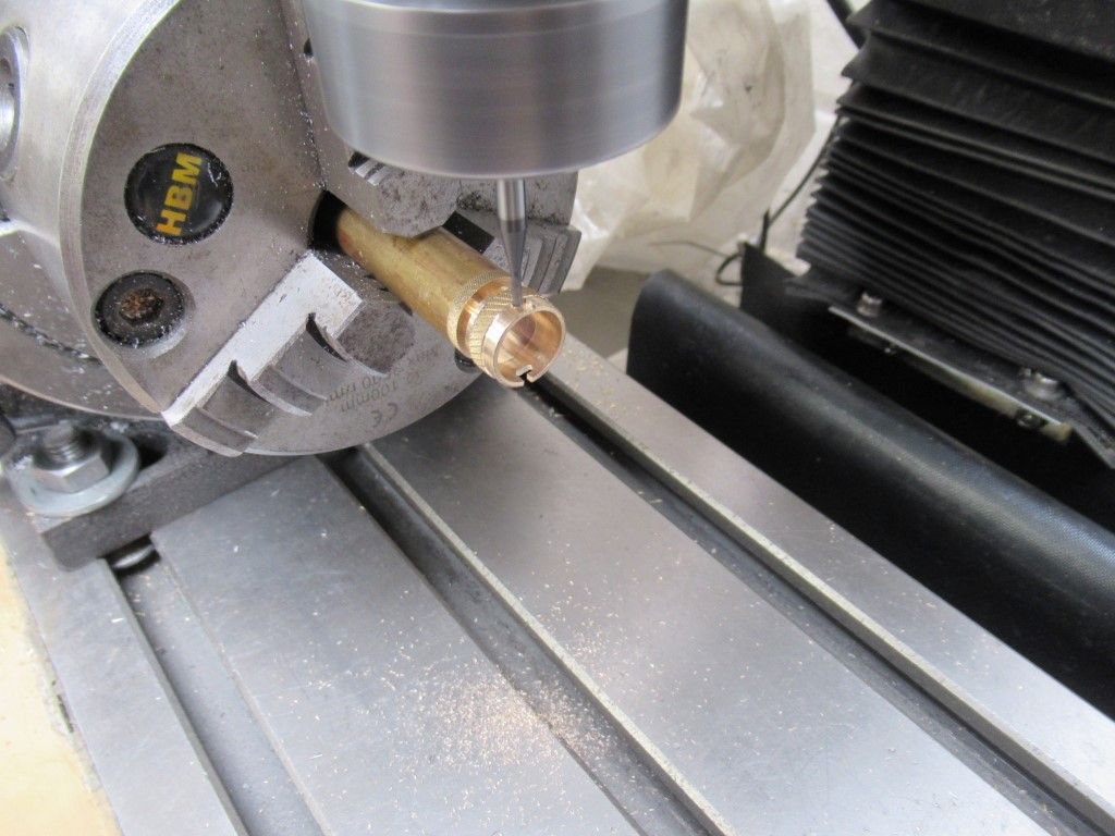

                                                      @davidk77137

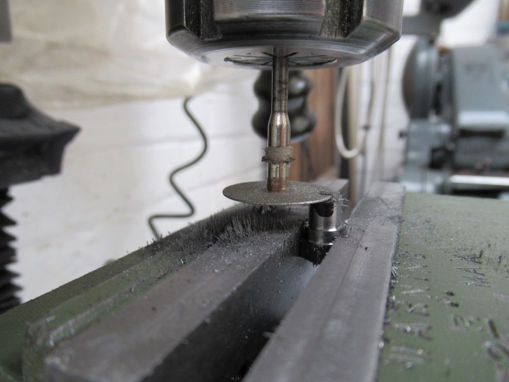

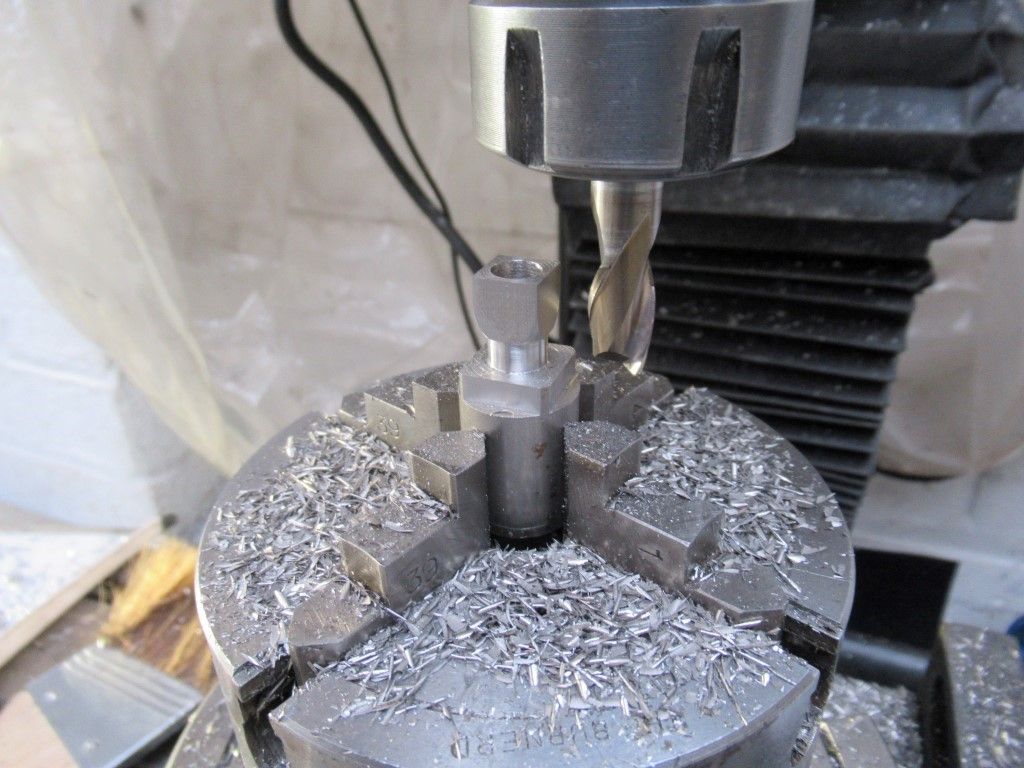

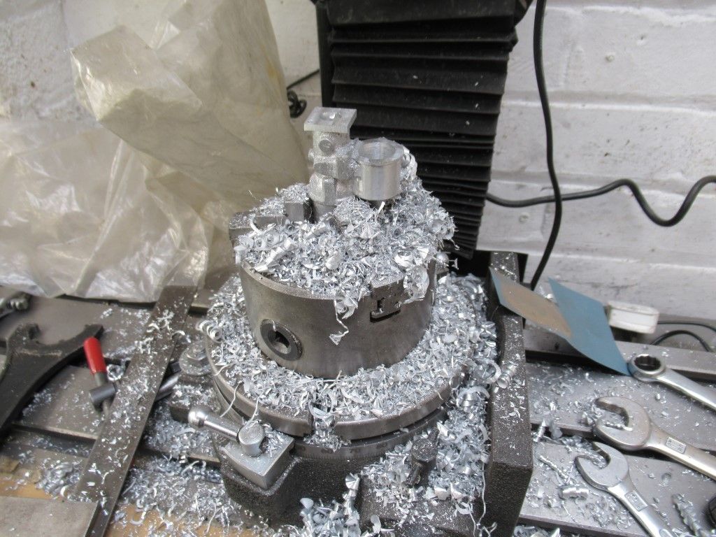

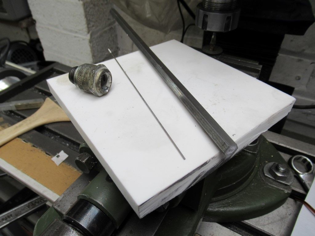

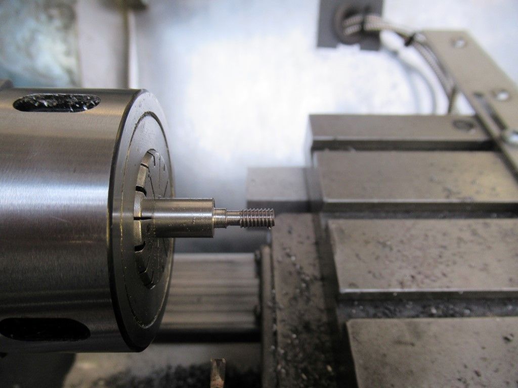

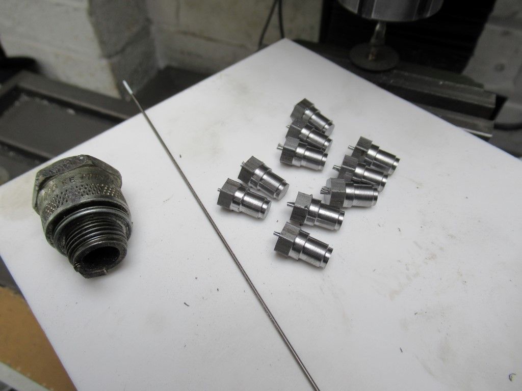

                                                      Spark plugs , i can buy 1/4 32 plugs but they are quite expensive so i had a go at making my own.
                                                      Started with some steel hex bar , Corian offcut for the insulator and some 1mm tungsten rod for the electrode.
                                                      I first turned the body leaving a little extra for the electrode, i would have threaded them but i realised i did not have a 1/4 32 die so i ordered one
                                                      I milled around the electrode and then undercut with a small diamond disc
                                                      I then used a flat bottom cutter to drill through to the undercut and form the electrode. The body was then counterbored using a drill and leaving a taper for the insulator to seal against
