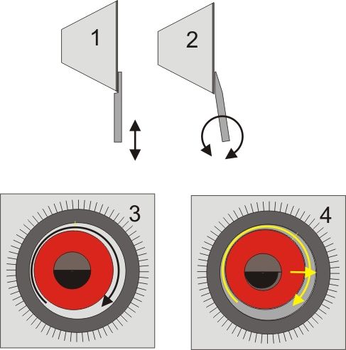

        I have a problem that I hope one of hte more mathematically competent can help me with. I was hiding when they gave out the bit of the brain that does Maths.
        I am designing a grinder workhead for Dbits and think I have the general mechanism down OK. What I don’t know is the relationship between an offset and degrees.
        What I want to do is have a sleeve that is bored about 1mm off centre in which a tool holder sits. The toolholder will be an ER 16 or similar collet.
        Once the tool blank is split, the sleeve is rotated by a number of graduations that hopefully corespond to real degrees of back off.
        Please see the pictures to get a better idea of what I mean.
        Thanks, Lawrie

          Lawrie Alush-Jaggs
            @lawriealush-jaggs50843
            Hi Andrew
            Thanks for your reply. I often need someone’s comment to firm up my own idea.
            What I have described above is basically the way that grinders like the Deckel and Pear et al work.
            The problem I am having is about the graduations. If as I stated, I have the bore offset by 1mm, how do I translate that into degrees in the graduations?
            With the Deckel, the machine with which I am familiar, you split the cutter by maintaining a plane between the cutter and the wheel. You then set the taper angle you want and grind that by rotating the collet through 180 deg. Once that is done, you loosen the colar for the offset and rotate it by the number of degrees you want the relief to be and then with the cutter at 90 deg to the wheel, rotate again through 180 deg and that gives you the relief and backoff from the cutting edge.
            I am trying to understand the relationship between the amount of offset of the bore, at this point an arbitrary 1 mm, how many marks there are around the collar of the collet holder and the number of degrees of relief I obtain behind the cutter.
            If I want 7 deg relief behind the cutting egde, it would be handy to to rotate the locking ring to a mark representing 7 deg and off I go. What I am thinking at present is that if I make the bore offset 1mm, I might get 7 degrees on the ring but if I make the offset 1.5mm does that mean that I by setting the ring to Gas Mark 7 I will actually get 12 deg or something else?
            I hope this clarifies the question.

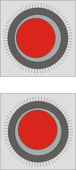

                    Lawrie Alush-Jaggs
                      To Steve, thanks for the reply. I ran the problem past my sone who at seventeen is strong on maths and geometry. Explaining the problem to him helped further clarify it for me. He did come up with an answer that makes sense to me and I will draw up a diagram of what he has proposed to see if others agree.
                      Firstly I have drawn up second set of pictures that may better explain the mechanism and information I am trying to elicit.
                      Number one is a D bit being split. In number two, the head is rotated about the Z axis to N degrees and the taper ground by rotating the collet and plunging it into the wheel – sorry, left out an arrow.
                      In number three the bit is rotated ninety degrees to present the cutting edge to the wheel.
                      In number four, the excentric that holds the collet is rotated by N degrees which in turn moves it across the X axis thereby altering the axis of the D bit in relation to it’s original grinding position. Rotating the collet and plunging it into the wheel now grinds at an offset giving a relief behind the cutting edge to about 178 degrees.
                      what I am trying to ascertain is the relationship between the degree of movement of the collet as established by the mount of offset in machining the bore – a nominal 1mm – and the degree of rotation obtained. So: If the collet is offset from centre at the time of grinding and I then rotate said collet, how do I know how many degrees that rotation represents to the D bit.
                      Or to put it another way, if I was to scribe the collar with a mark at every degree and then rotated the collar to the seven mark, how would I determine that I was going to get seven degrees of rake on the bit, short of doing it and then measuring?
                      To Chris: In a nut shell. Thanks.
                      To Steve: Thank you for one. I think the drawings will explain how the change in axes is obtained.
                      Thank you also for two. Touche.

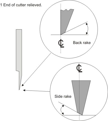

                      #68029
                      Anonymous
                        I’m probably being thick, but I don’t understand what you mean by rake angle on the bit. Can you post a diagram of the D-bit showing which angle is being referred to?
                        Regards,
                        Andrew
                        #68030
                        Lawrie Alush-Jaggs
                          Sorry Andrew, thanks for your suggestion. Rather obvious once it has been pointed out.
                          This is the angle I am talking about
                          Thanks

                                                    Of engraving tools I know exactly nothing, but on a taper reamer – I don’t see the need for the relief as drawn on the diagrams? They cut (in bronze which is my experience of them) at zero or 90deg, without that relief on the back.
                                                    That kind of relief is what one sees on the back of a gear cutting tool -or similar. There was a gadget called a Eureka IIRC? which put that kind of continuous relief on gear cutters. That used a cam I think??? Anyway its a Chaddock/Law thing and details of it are in Ivan Laws Gear Cutting book.
                                                    Less elegantly (and that may be part of the attraction) if I wanted that kind of relief on the back of a tool, initially I think I’d cut it with a milling cutter, and then do the rest on the Quorn. However Prof Chaddocks Quorn book does also show a way of applying relief by dropping the tool to be ground with respect to the wheel, and then rotating the tool using the spiralling head. That actually is rotating the tool around another centre – ie using a “non-material” eccentric So that may offer another way forward, and save a bit of work, particularly as there is a chart in there which gives amount of relief in terms of thous of offset, with respect to grinding wheel diameter?

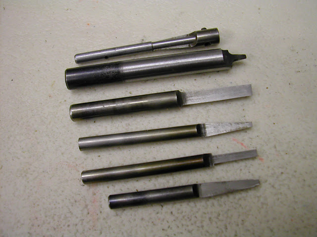

                                                      Lawrie, I understand your approach to achieve a means to relieve home produced ‘cutters’. Like some others however I personally do not see these as D Bits but that is purely academic.
                                                      Quite recently and somewhat coincidentally I was shown a piece of (professional) kit that does exactly what you are trying to achieve. This was in a local workshop and was used extensively for producing small engraving cutters. It produces the relief exactly as you describe.
                                                      It was the first time I have seen such an item and I was impressed at its ability to produce the relief needed for a rotating cutter. I can find out more about if you wish.
                                                      What I do perceive as a ‘D bit’, and over the years I have made the odd one or two is just as previously described ie half diameter form and, where parallel, relieved at the front, with slight back rake. Others of varying form are not relieved and have all performed well in producing the types of hole you wish to achieve ie convex or tapered.
                                                      This pic is of the ‘D bits’ made so far for the Bentley BR2. The top one, a reverse counterbore produced 36 tapers in which the headbolts locate. (Material was EN1a) The tapers on the head bolts were turned at the same topslide angular setting as the cutter to ensure a matching fit. It is as sharp as when first produced which was by conventional means – milling and stoning. They are all cut on the centre line and do not have any kind of relief.
                                                      Now I agree that this is forming the hole – scraping if you like – but that’s what other than a parallel D bit does and for me it does it well with consistent form and surface finish so this is really to say are you possibly persuing a path that may not need to be tread for the two items you mention.
                                                      Of course if your intent is to produce a cutter relieving device per se then I wish you well in your endeavour.
                                                      If I can be of further help with that local machine please say.
