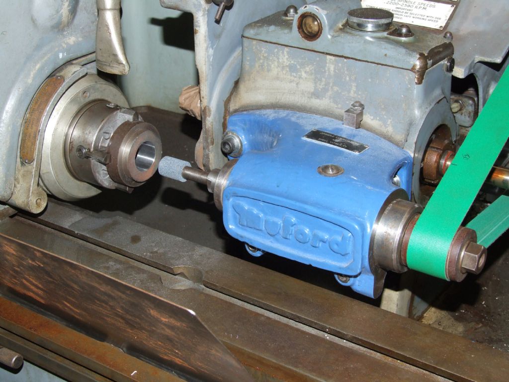

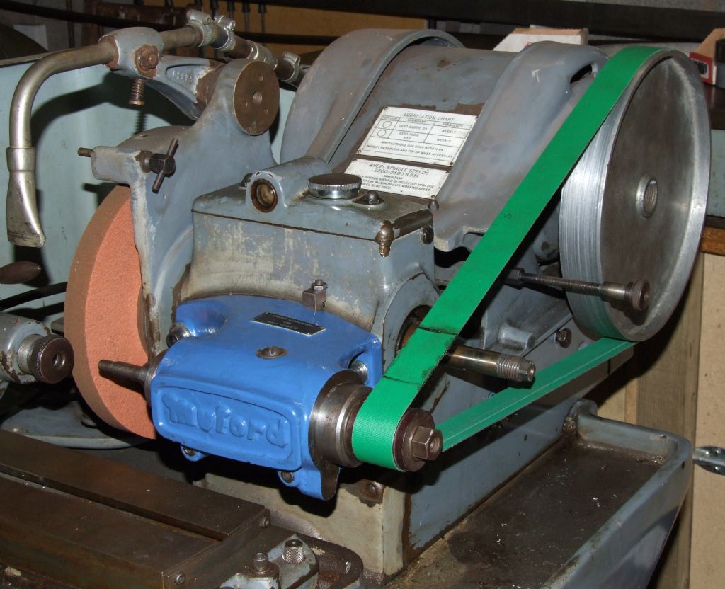

      I've finally got the internal grinding attachment for my cylindrical grinder running. However, I have a couple of queries.
      1. How tight should the belt be? I've tightened it enough so that it doesn't slip on start up. The Myford manual is singularly unhelpful; it just says adjust the motor mounts to set the correct belt tension, doooh. The top of the belt in the picture has a total play of about 1". When the spindle is running the top of the belt vibrates about 1/4".
      2. After a minute or two of running the spindle gets warm. I can hold my hand on it, without too much problem, so probably about 50ºC. After a five minute run it doesn't seem to have got any warmer. I assume this is probably normal? I estimate that the spindle is doing about 20000rpm, and is lubricated and sealed for life.
      Picture of the setup:

          Belt play should be about a half inch otherwise it flaps about, the bearings heating up seems to about the same as my lathe main bearings and it runs fine.

            Thanks for the information. I've tightened up the belt so that the play is about 1/2". It still vibrates a little bit, but at this stage I'm disinclined to tighten it any more. I did a few more runs, and got the impression that the spindle didn't get quite so warm. Given that the spindle is sealed and lubricated for life I guess the lubricant is grease. The spindle hasn't run for at least 5 years, so I assume that the grease needs to be re-distributed around the bearings. That's why I've been giving the spindle short runs.
            I've got a selection of small grinding wheels on order; when I get them I'll have my first go at internal grinding.

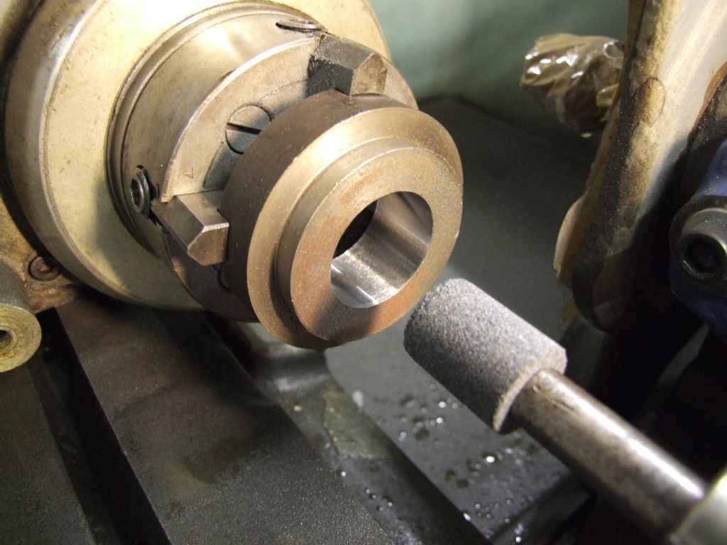

              I've now got my internal grinding wheels and have had a go at internal grinding. This is the set up:
              The wheel is a 60 grit regular aluminium oxide, specfied for soft steels. The test piece is EN1A from the scrap bin. Grinding was done dry.
              First off I tried grinding by moving the wheel radially out, and then engaging with the hole. This resulted in a hole with a good finish at the back and awful at the front. I assume this is due to the wheel and quill flexing slightly as the wheel enters the work? I then tried grinding with the wheel starting inside the job and then moving outwards radially until it started grinding. I then oscillated the wheel back and forth, but without disengaging from the work, a bit like honing. This seemed to give a more uniform finish. Like this:
              The finish looks, and feels, pretty smooth. It measures anything from 0.7µm to 1.6µm Ra. I reckon the 0.7 is about right for the grit size but the 1.6 is rather disappointing. I never quite achieved sparkout, despite many passes.
              So, does anyone have any hints on internal cylindrical grinding regarding techniques, methods, expected finishes or anything else?

                Is there not supposed to be a cover or guard over that belt ? Don't have the belt too tight or you will preload the bearings causing wear, have you put any dressing on the belt to stop it slipping squealing ?

                      Ronan: Yes there should be a belt guard. I have a Myford original cast aluminium belt guard for external cylindrical grinding but nothing for the internal. It's on the list of things to make. I don't think that the internal grinding setup was original to the machine, as I had to bore out the drive pulley to get it to fit the motor shaft. How tight is too tight for the belt? Following Clive's advice there is about ±1/2" play on the belt. The belt doesn't slip on start up, so I haven't added any dressing.

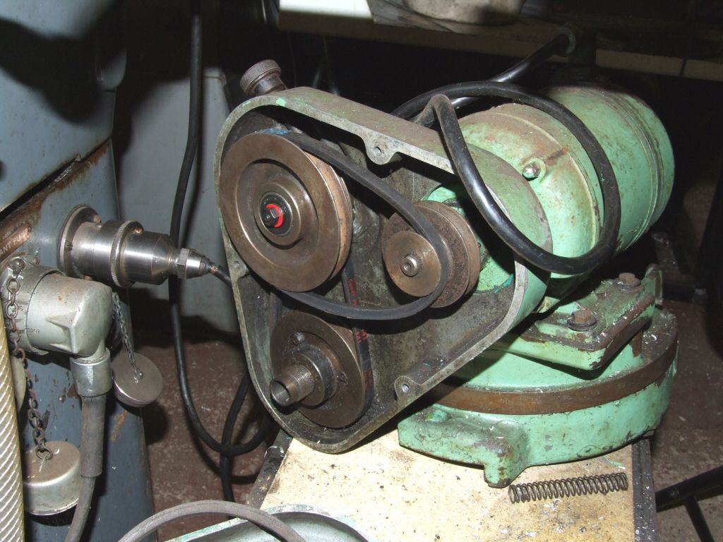

                                          The swivel work head has only got one belt to drive it. I got an adaptor and 3 jaw chuck for the swivel workhead from the US. Since the swivel workhead uses different adaptors and collets I needed at least one adaptor and chuck.

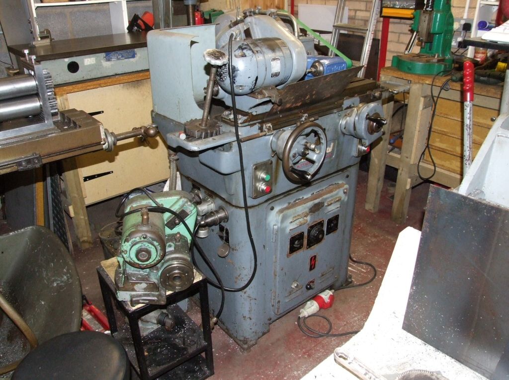

                                            Here's a picture of my grinder, I run on 3-phase hence the red plug on the floor:

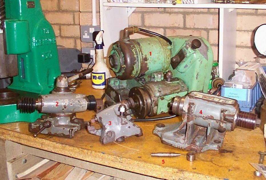

                                            According to Myford my grinder was built in 1969; unusually I have the original manual for the machine. To the left of the machine is a small stand I welded up to hold the accessories. Here's a picture of some of the accessories that I sent to Myford to confirm what they were:
                                            1. Swivelling workhead
                                            2. Angled wheel dresser
                                            3. Travelling steady
                                            4. Internal grinding attachment
                                            5. Internal quill and nut, which agrees with what you think are the internal grinding quills
                                            I also got a faceplate, 4 jaw chuck, spare workhead noses, two wheel holders and a centre, but no collets. I believe that the newer machines used standard collets (4C?) but the older ones used non-standard collets. So far I haven't really missed not having any collets. Both my workheads have DC motors, but I think later models used AC motors. Looking at your picture I'd hazard a guess that your swivelling workhead has an AC motor. Finally here's a picture of the back of my swivelling workhead to illustrate the two belts, the loose one is supposed to be 17.6".

                                            I need to move the motor position to adjust the tightness. Rather annoyingly the belt lengths are different again for the normal workhead.
