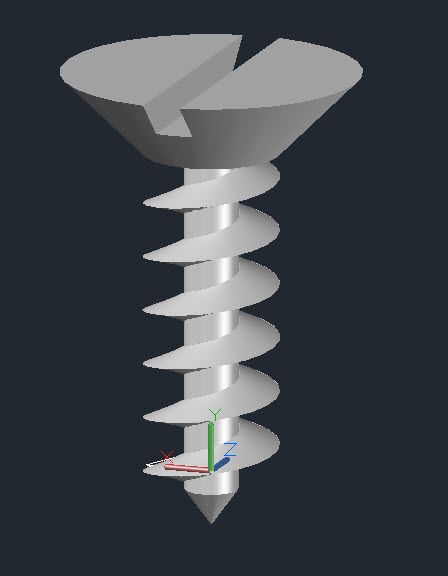

                    #113043
                    John McNamara
                      @johnmcnamara74883
                      Hi Thomas Gude
                      Below is a CAD sketch of a constant pitch wood screw you can make on the lathe. I have drawn it as countersunk slotted however the head can be changed.
                      This type of screw is not self drilling you have to drill a small hole at the root diameter first then the helix will cut it way into the wood. As you can see there is no taper.
                      I learnt about these screws when repolishing a firearm. A Brno .22 that I have had since I was 14. Brno use this type of screw in preference to the tapered kind, I guess due to the superior clamping force and the ability to precisely locate them.
                      It would not be that difficult to turn them on the lathe. You can make them to scale size.
                      Cheers

                                In the above diagram, I would tend toward a slightly deeper groove, with a sharper crest, make one or two steel ones, use these in the holes first, then use the brass ones in the tapped holes, I like Johns BRNO one, Had a BRNO Fox .222rem, it was good for goats and hares, and long range shots at rabbits. Ian S C

                                      #113361
                                      Sub Mandrel
                                        @submandrel
                                        Pierre's drawing is fascinating. It's dated 1935, and it really does seem a very odd screw profile.
