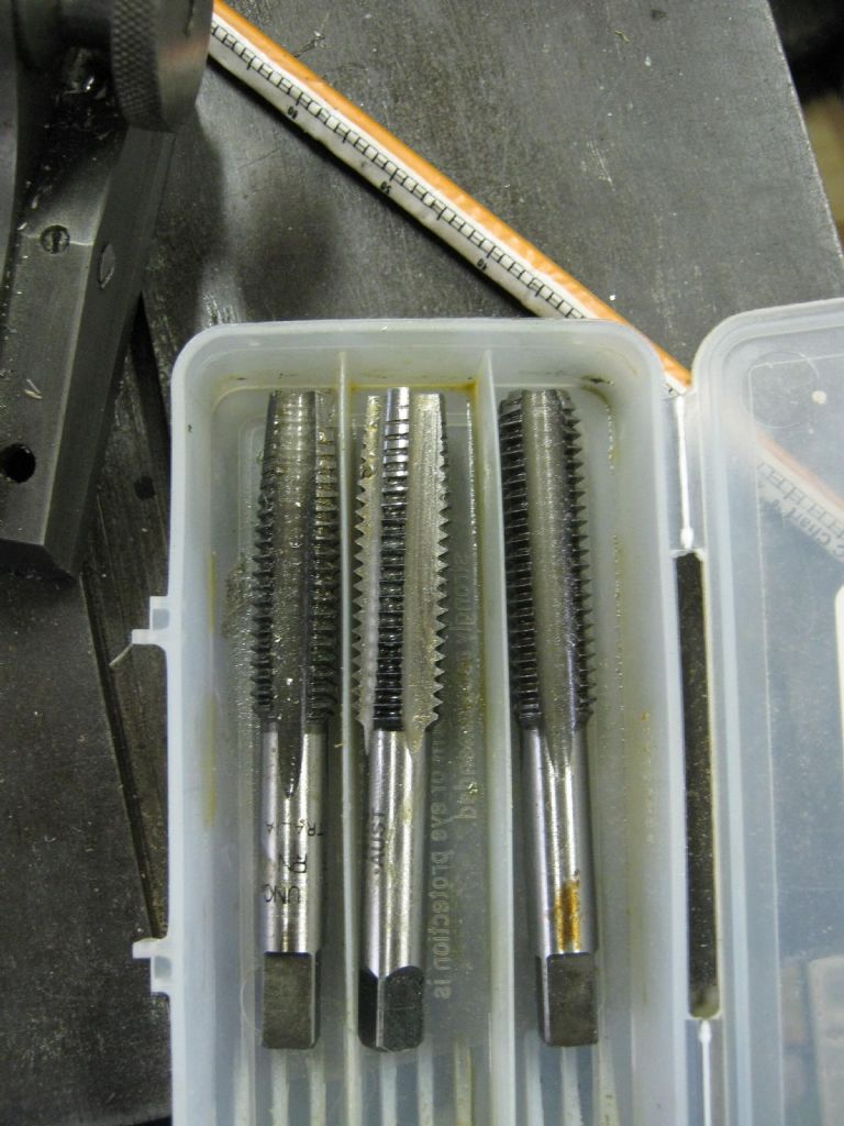

      Am wanting to cut some threads to make various workshop tools and am making a die holder for my lathe tailstock and mill spindle. The lathe is imperial so I bought some imperial taps and dies at Harrogate (1/4″, 3/8″, 1/2″, 7/16″, 5/8″) to go with a metric set I already had.
      Now some of these have a split in them (imperial) and some are solid (metric). When I make the die holder am I supposed to design it so that grub screws close the split up for the imperials to get the right thread cut? The metric ones will just have to hold the die centrally

          Oh forgot to add. In a tap set what is the difference between the first, second and plug taps?
          I presume first means first cut and second the second cut (?) but plug has me

            The split allows some fine adjustment so you can control the fit of a nut on the thread. The solid ones just cut at whatever they’ve been ground at. One of the retaining screws should engage in the split when fitted in the holder and two other screws either side are used to adjust the gap before tightening everything down.
            The first tap, as you’ve correctly guessed, has the most lead taper and used for starting a threaded hole. The second has less of a lead taper for following the first and the plug tap has no taper so you can fully form the thread all the way to the bottom of a drilled hole. Some of the smaller size taps only use a first and plug.

            Howard Jones
              @howardjones35282
              notice that the tap on the left has more taper. the tap in the centre has shorter taper and the tap on the right almost no taper.
              from left to right we call them start, intermediate and bottom taps.
              if the material you are trying to tap is difficult to work with then cutting the thread in stages will cause a lot less tool wear than attempting to cut it to full depth in one go.
              I recomend the use of “Trefolex” brand sulphurised lard while tapping. it significantly makes the task easier.
              the rest as for Chris Trice’s comments
