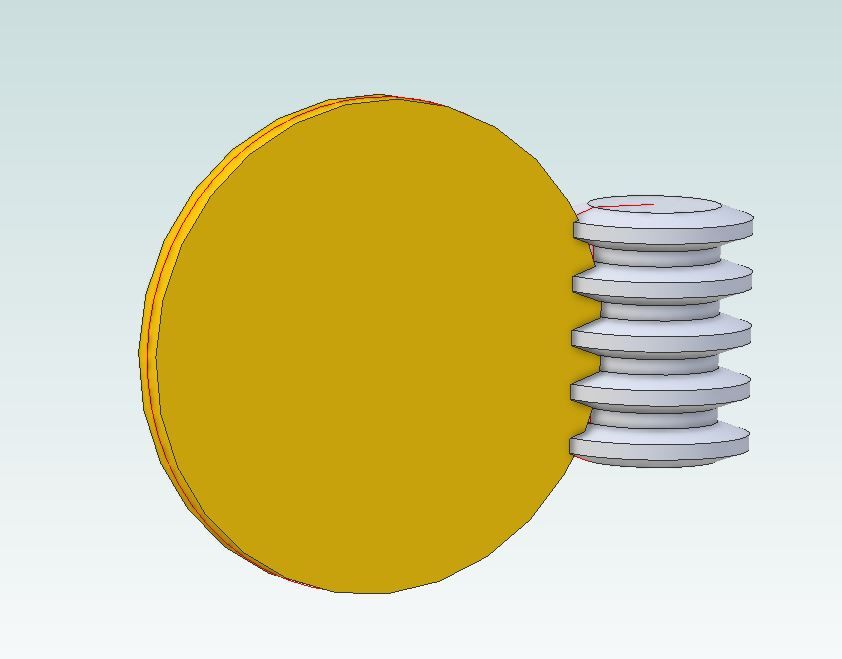

        Andrew, cutter would be rack form in section, think ACME form but with no helix so with the work moving in small increments you would get a facet per angular movement. So one cutter per DP or MOD size but it could cut any number of teeth save for very small ones. Much like a Sunderland but with a rotating action to the cutter instead of linear.
        #563567
          Posted by brian jones 11 on 20/09/2021 08:16:56:
          Ok JB, I agree with all your comments AND
          the fundamental limitation is the choice of screw thread pitches available for practical use
          To keep it simple, and assume that the CP is approx = to screw thread pitch then you could realistically go from 2mm say 1/2 UNC (or M14 x 2mm) to M24 x 3mm to M36 x 4mm
          That was one of the points I listed, "Limited tooth size as large threads are screwcut not cut with taps" even your M24 and M36 are doubtful unless you have means of holding that diameter in spindle.

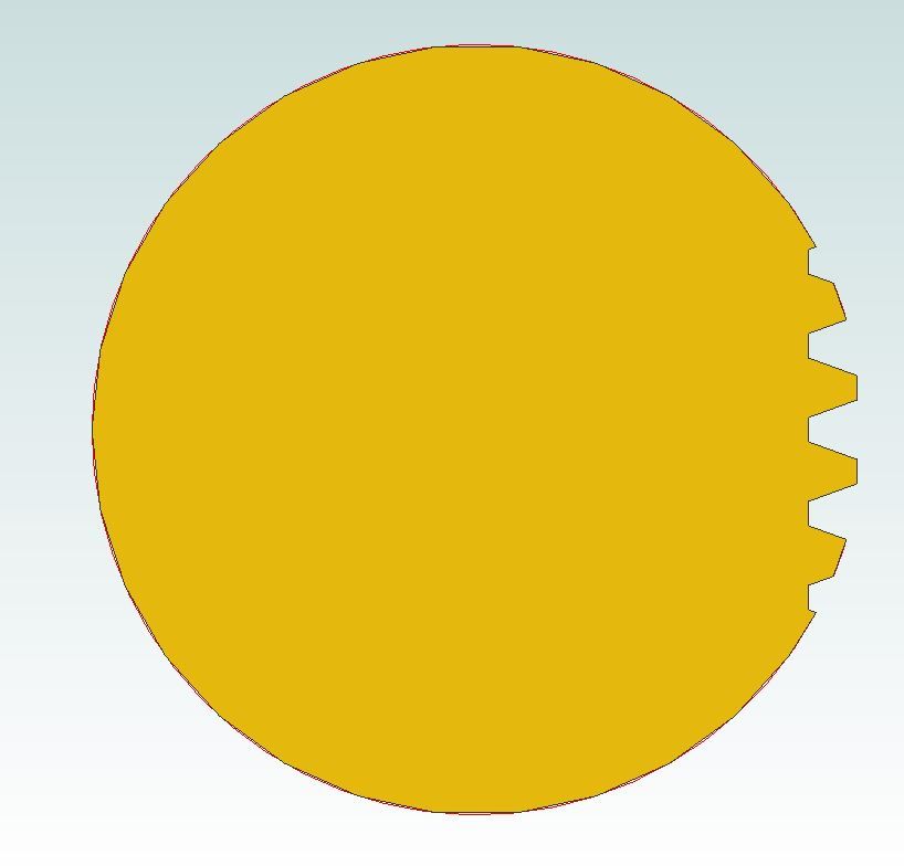

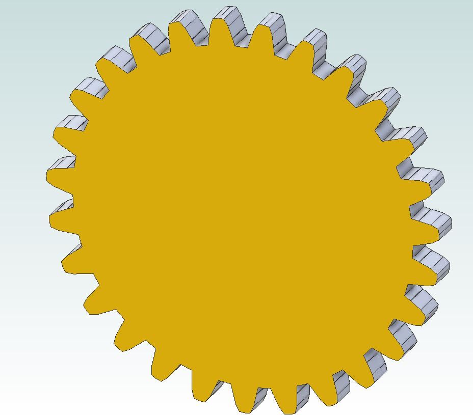

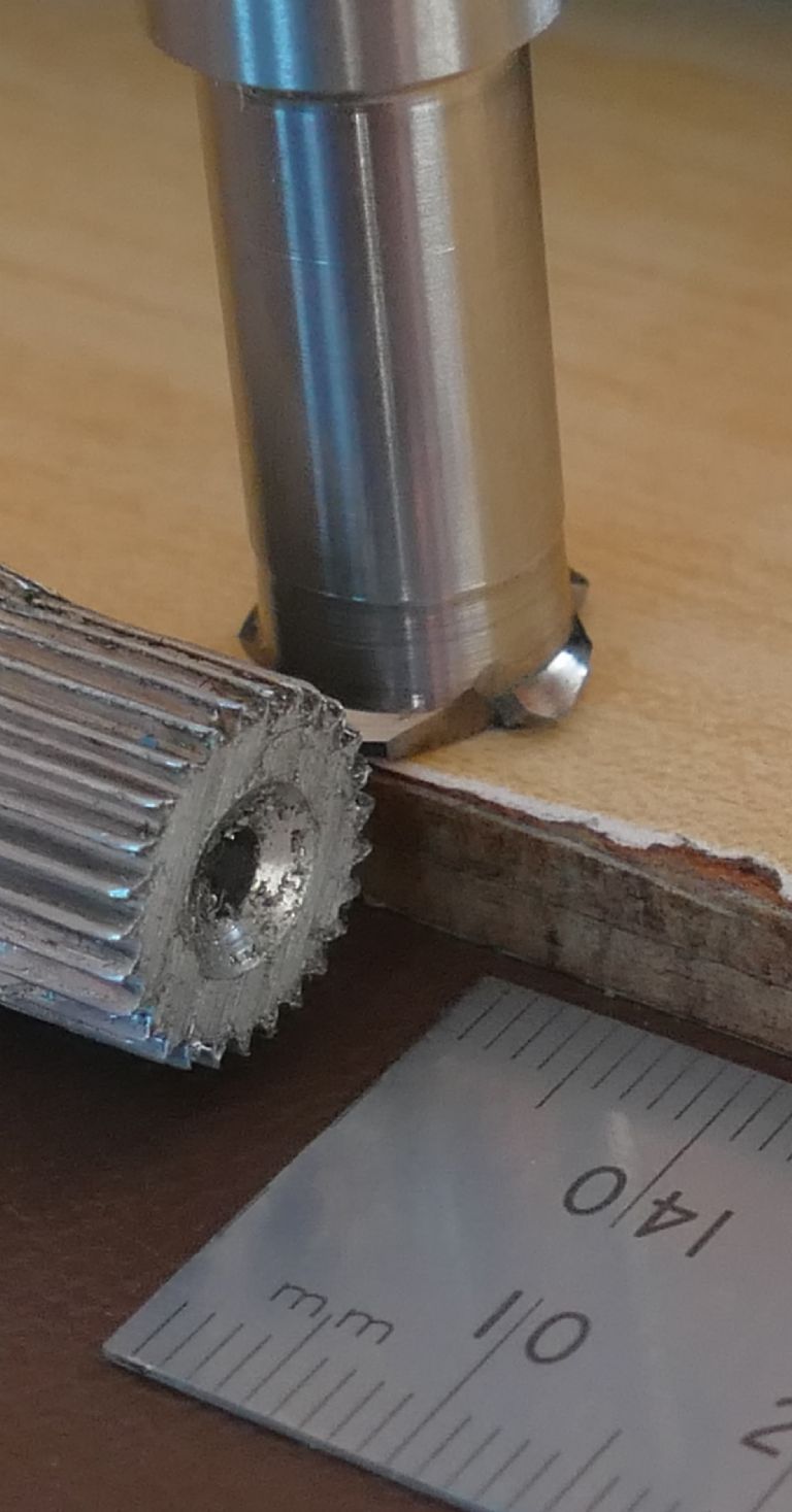

                        A single cutter formed like a rack with one tooth can be raised or lowered one or two pitches above and below the centreline of the blank's rotational axis to create DP or Module gears. This will be like having a 5 tooth rack cutter. Rotate the blank one tooth position (0, 1, 2, 3 etc) and repeat until finished. Then if you want less faceted faces you can rotate the blank half a tooth (0.5) and move the cutter to the intermediate positions between the first five followed by rotating the blank to the remaining positions (1.5, 2.5, 3.5 etc.) and repeat until finished. Easy with CNC and an a axis, fiddly but doable without CNC.
                        You can turn HSS with a ground and polished carbide insert.
                        This is a test piece left over from one I did for a specific need for a 0.4 module 27 tooth gear where an off the shelf gear was not suitable, the actual part was made from brass.
                        Single tool gear cutting
                        Martin C
                        Edited By Martin Connelly on 20/09/2021 16:32:19
                        #563607
                          The advantage of a cutter with a rack profile of say 5 teeth is that it will cut several teeth at each pass so the total number of A and Z movements can be reduced therefore making the run time less
                          As I think Neil posted images of all his brass gears were done with a cutter like that but only indexing the work by 1 tooth at a time so facets are quite marked, if you could get the CNC to give you another couple of positions you would get much smaller facets and a smoother face to the gear tooth. At some point it would not be worth making small movements as material removed would be so small (depending on DP or MOD size)
                          Something like this of reasonable diameter would give a good cutting speed and with 4 or 6 flutes machined into the cutter would allow it to move a lot faster than the usual 2-flute ball nosed milling cutter for the same chip load and it would be far more robust.
                          Several facets cut each pass
                          Just by indexing one tooth you start to get curved gear faces, imaging the facets being 3 or more times as many once A and Z start moving.

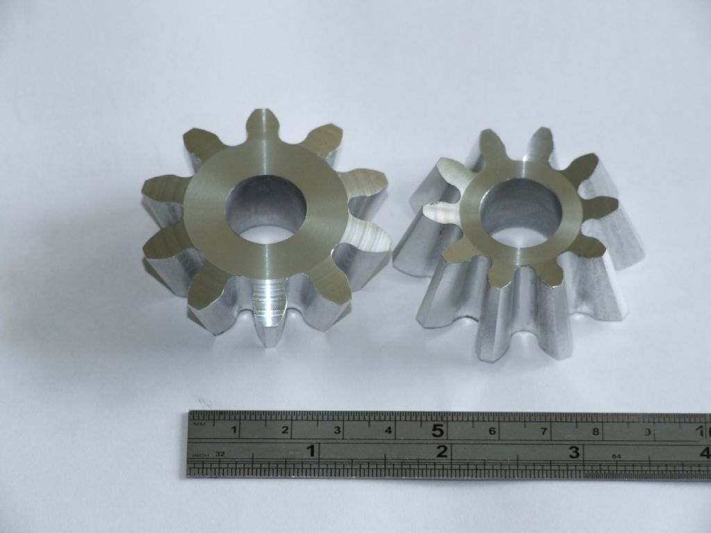

                          #563623
                            This works. One pass per tooth. Works for small gears. For really small you can shift by half a tooth and go round again.
                            Also cuts slightly ugly but perfectly meshing gears on slightly non-standard PCDs, over and under size.
