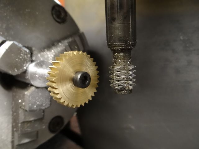

        Now your first result you reckoned you made a nice knurl but you were only using 1/4 BSF 26tpi
        Now I am using 1/2" UNC 13tpi so my pitch is ca 2mm and produces a more credible size gear
        BUT spiral flute taps are rare on EB and larger ones get very expensive, so not a practical direction I admit
        I had a cunning plan and Ive had more results from Doreen see below

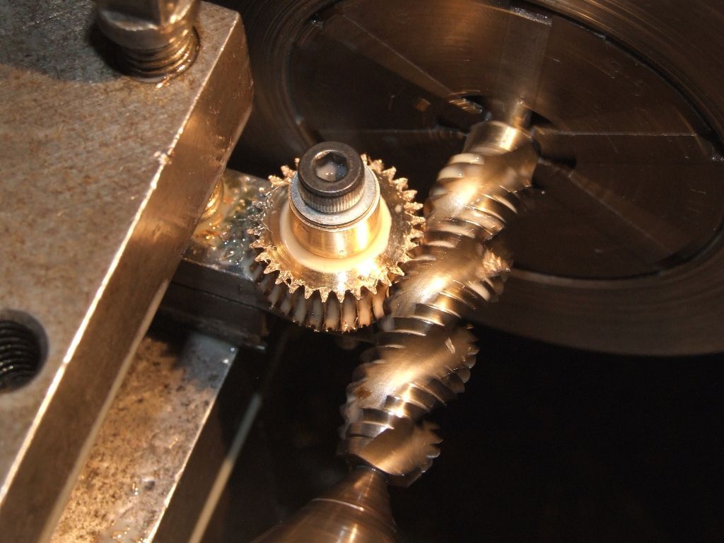

                Someone else not paying attention, as I previously said I used 1/4" BSP which is 19tpi and 0.518" OD. That's why there is a 19G thread gauge in one of the photos.
                Doreen Is his Dore Westbury mill.

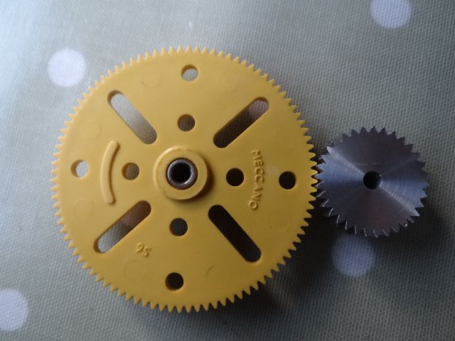

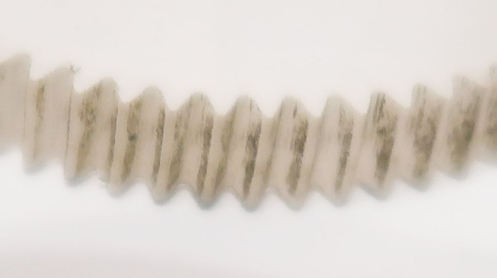

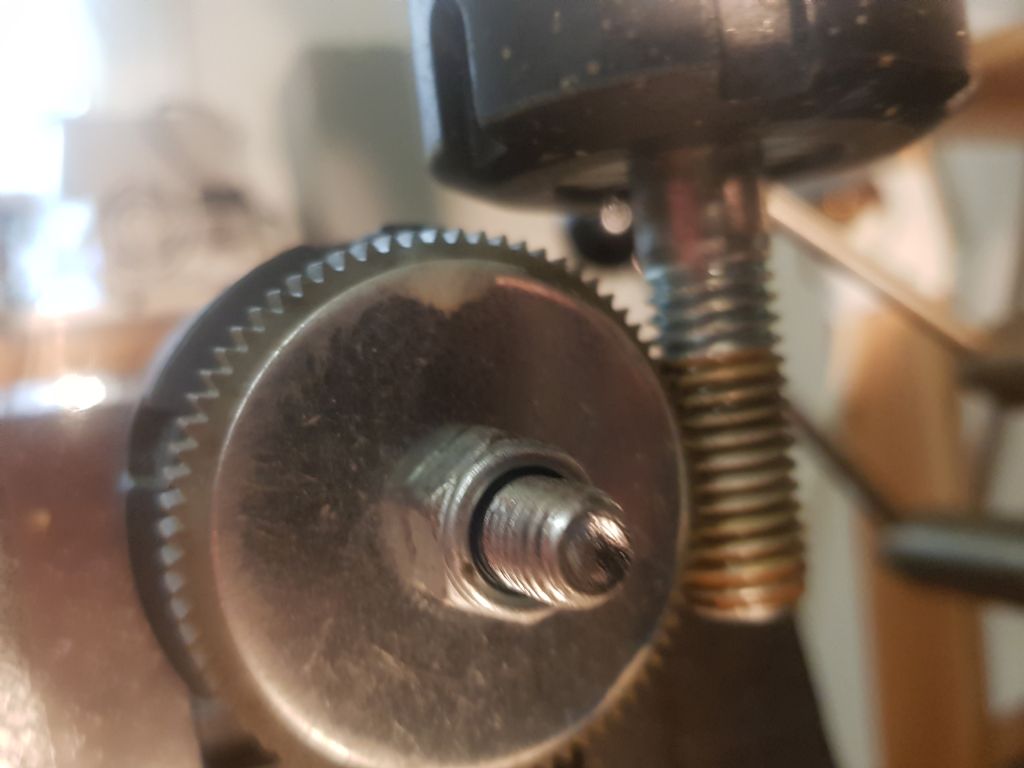

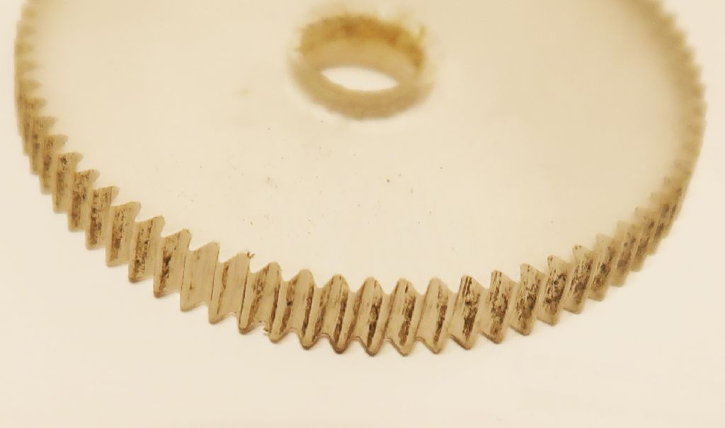

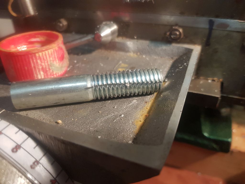

                    When I woke up from my pantograph AO drawing board this am, I was seized with a new direction . Why not try
                    straight slits down a bolt thread. My angle grinder disc is 1mm thick, so I made 5 axial slits coinciding with the hex head – in a heartbeat. If the gear blank is say minimum 3mm – mine was 6mm, then the cutter shouldnt come un meshed.
                    So this is the result
                    This is during the rolling and polishing process
                    This was just a quick try with my grinder, slitting along 6 edges to match the Hex head, done by hand so a bit naff, could do better
                    Not a chip in sight all round and SHOCK 74 teeth (not 73 predicted) -well it wouldnt suit a clock maker
                    Im not skilled in taking close ups. the gear is mucky from the brasso fluid which I applied to polish it up to please the Grommets
                    As you seen its a presentable form, even with rounded tips and roots?
                    I polished it up by using a plain bolt without cutting edges and some Brasso. I think the applied rolling pressure helped (after all they make quality precision threads by rolling process)
                    So even if it fails on soft metal, it can produce respectable plastic gears quickly and cheaply without complicated attachments, universal dividing head and loads of patience etc
                    I have some AL and brass blanks on order
                    Maybe look up some larger thread – 2" bsw 4.5 tpidevil that should knock the stuffing out of sofa dwellers

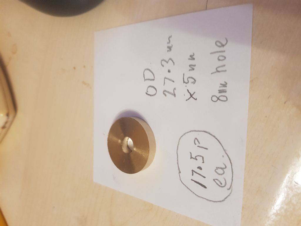

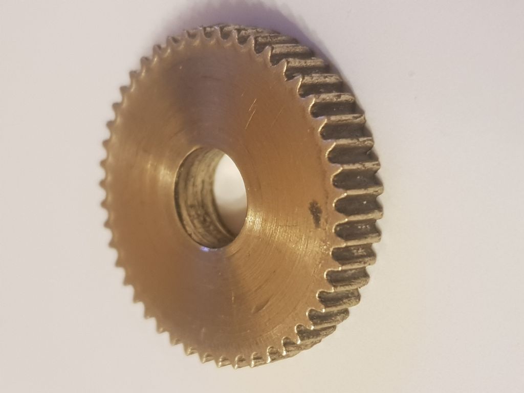

                        As I am sure you are all on the edge of your seats (not possible for sunken armchairs) here's my first attempt at a brass gear
                        I keep forgetting to landscape my phone, notice a cheapo brass blank – 17p whats not to like
                        before you all leap from your electrically assisted orthopaedic memory padded comfort
                        YES its not perfect, there are flaws but I put that down to the rough way I chivved up my spirally sliced bolt on my vice with an angle grinder, lots wrong with that method
                        I have a cunning plan to make better cutting tools from bolts the proper way
                        More work needed

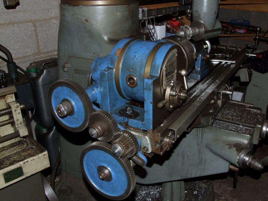

                                      Well PR post a pic of a hobbing attachment – not a specialised hobbing machine – that doesnt count, its not for the hobby machinist.
                                      My point here as I expect you noticed is that we all take for granted that a lathe is generally designed to be able to make screw threads. Its no big deal
                                      But a mill isnt set up to make gears in a similar way (nor a lathe for that matter)
                                      In both cases you can go for a dividing head and laboriously rake out each tooth
                                      I dont know of a simple system that allows you to cut gears with ease and speed (I am discounting the modern use of stepper motors for the job for the purposes of this discussion. No electronics allowable
                                      You need to lock the spindle rotation with the gear blank rotation by suitable gear chain and the whole should run and chew out a gear – you may need some movement of the cross slide if its a thick blank of course
                                      Thats hobbing on gas
                                      So is there a ready made attachment for mill hobbing?
                                      Hence my pursuit of a cheap charlie way of knock up spur gears – we already know the worm gear method
                                      and this is an expansion of this method
                                      #562971
                                      John Haine
                                        @johnhaine32865
                                        Indeed, looks like cutting a helical form, the rotary axis is driven from the table X feed not the cutting spindle.
                                        #562977
                                          Brian, you have not said how long those gears took, could you enlighten us as to how long each took and did you take any photos during the machining?
                                          Interesting that you seem to have about 47 teeth from a quick count up, with a 13tpi cutter and a 27.3mm dia blank I would have thought 42 teeth, so the method is very unreliable.
                                          From the one I cut I would not say it's super fast as I found the feed along the work needed to be increadably slow to get an even finish rather than a "shallow worm wheel" effect in a helical form along the face related to my feed rate.
                                          The milling setup with the driven dividing head is one of Andrew's photos for one of his hobby projects, not sure he has an arm chair either as his front room has too much engineering tools in it to find space for one.
                                          Edited By JasonB on 16/09/2021 07:12:54

                                              #562996
                                              Anonymous

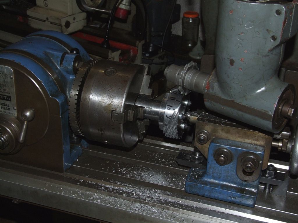

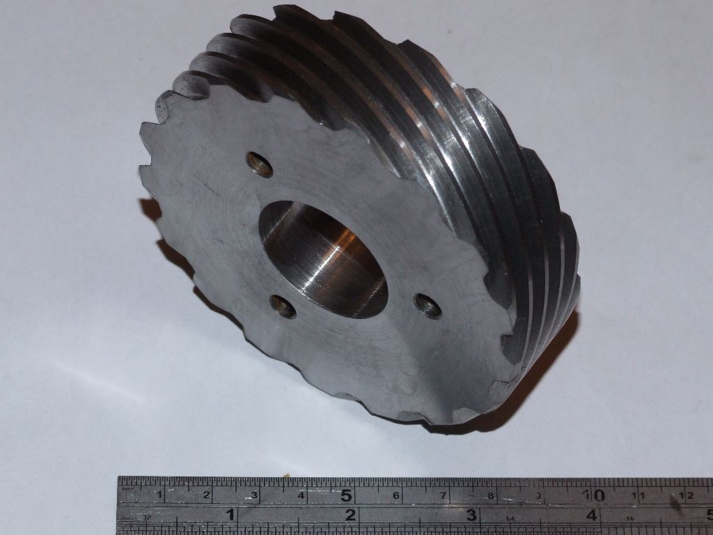

                                                If the OP is going to misappropriate my photos he might at least attempt to get the descriptions correct. The first photo is not of a gear hobber. It's a universal dividing head set up to cut a high helix angle helical gear, as shown here in more detail:
                                                And the finished gear:
                                                Such dividing heads are normally used on a universal mill, ie, one where the table swivels. The table on my universal mill only swivels ±45° so in order to cut a gear with a 70° helix angle it was setup on the Bridgeport with a right-angle head. This equipment would have been common in commercial workshops up until at least the 1980s when CNC started to make inroads. There are many forum members using ex-industrial equipment, so I doubt I'm the only member with this sort of capability.
                                                In the second photo "caught" is hardly the right word, given the photo is in a public album. The idea that increasing the gear OD makes it a spur gear is nonsense. Long ago (50+ years when I was still at school) I cut a much larger gear using the same method, with a straight flute 2BA tap, just to see if it worked. As in the photo the larger gear was also a worm wheel.
                                                It would be interesting to know how the OP would tackle this gear:
                                                It would need one hell of a tap!
                                                An underlying theme in posts by the OP shows an obsession with sofas and armchairs. Even if I had them nothing he's posted so far would have stirred me to get off them. smile
