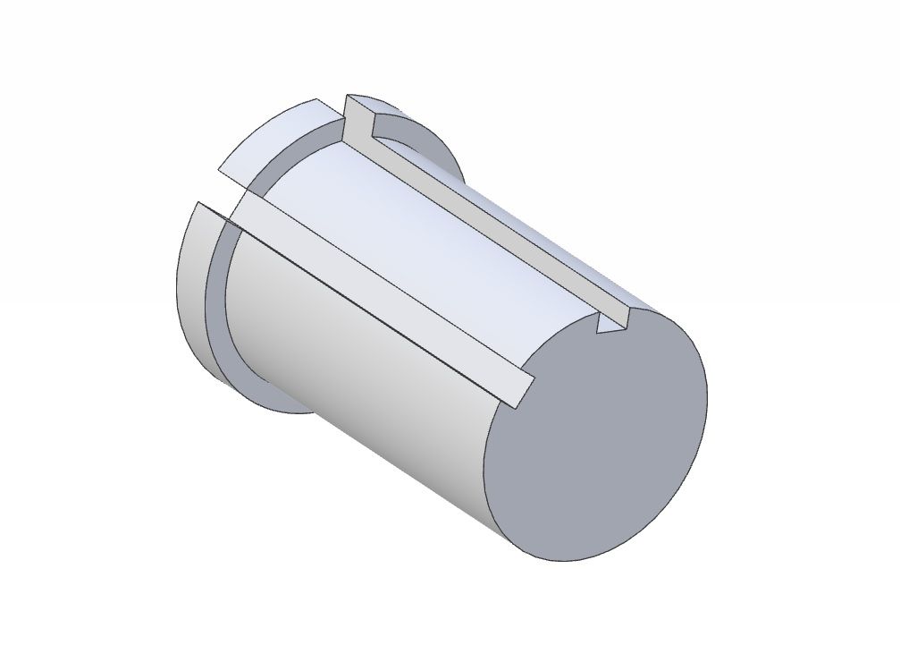

                            Chris how about two pieces of tube, one is 1/2 od x 3/8 I’d and one 5/8 od x 1/2 I’d. Slot both with an 1/8 cutter, slide one inside the other and silver carefully together. Before you silver them you can also set the spacing of the slots/ key ways.

                            Brian Wood
                              @brianwood45127
                              I was about to make the same suggestion myself, with the addition of inserting a filler of carbon in the internal slot to prevent silver solder from wicking in

                                I have known of, but not tried, using that insert method for splines.

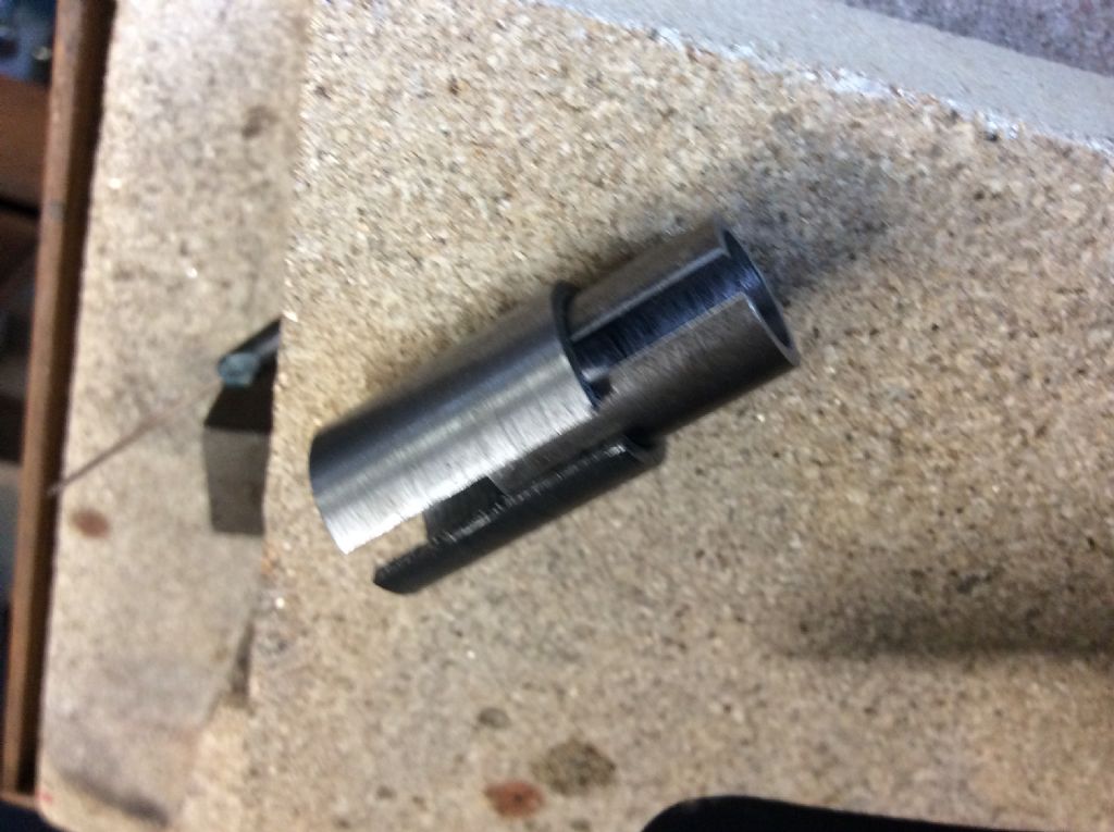

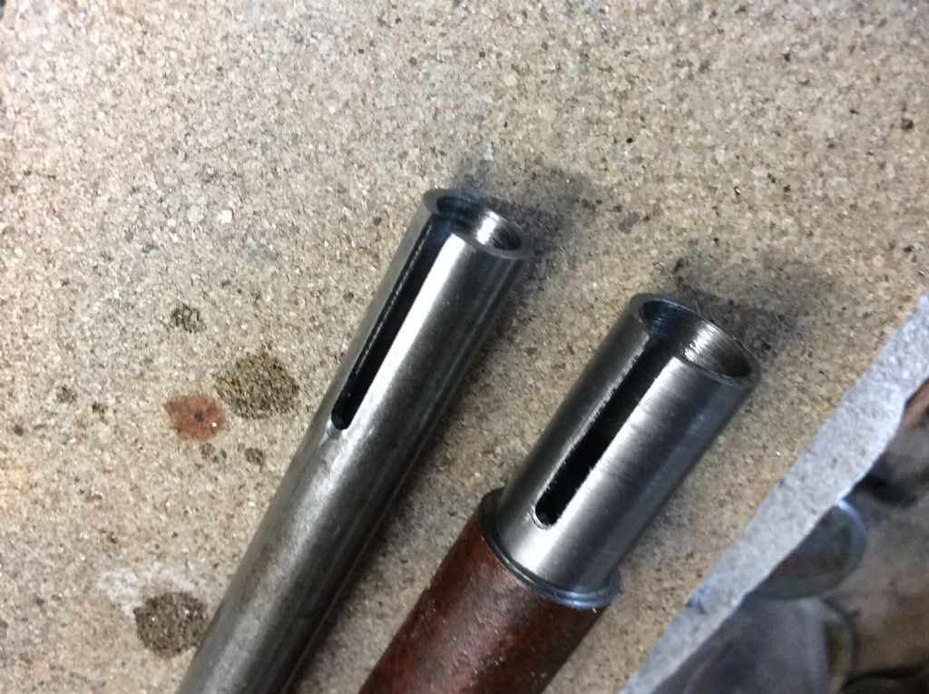

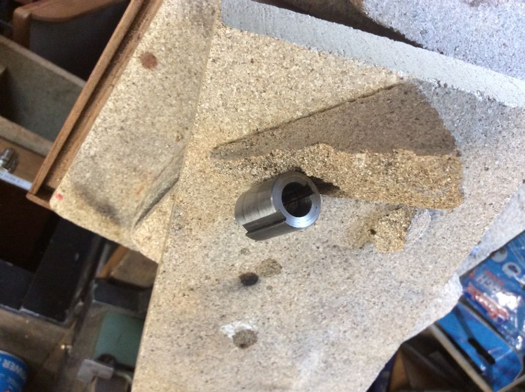

                                bernard towers
                                  @bernardtowers37738
                                  adfff631-155e-4104-9f65-c22411808d38.jpeg60ac2925-6c76-4c32-a78d-6f70672d7878.jpegI was curious if it would work and it too exactly an hour for what seems to be one way of doing it.99fe1df4-42de-4cd7-866a-9de66e525c60.jpeg
                                  Edited By bernard towers on 03/10/2023 10:49:18

                                    As per usual photos in wrong order and text moved all over the place and when you go into edit the text is in a completely different place, roll on the new edition
