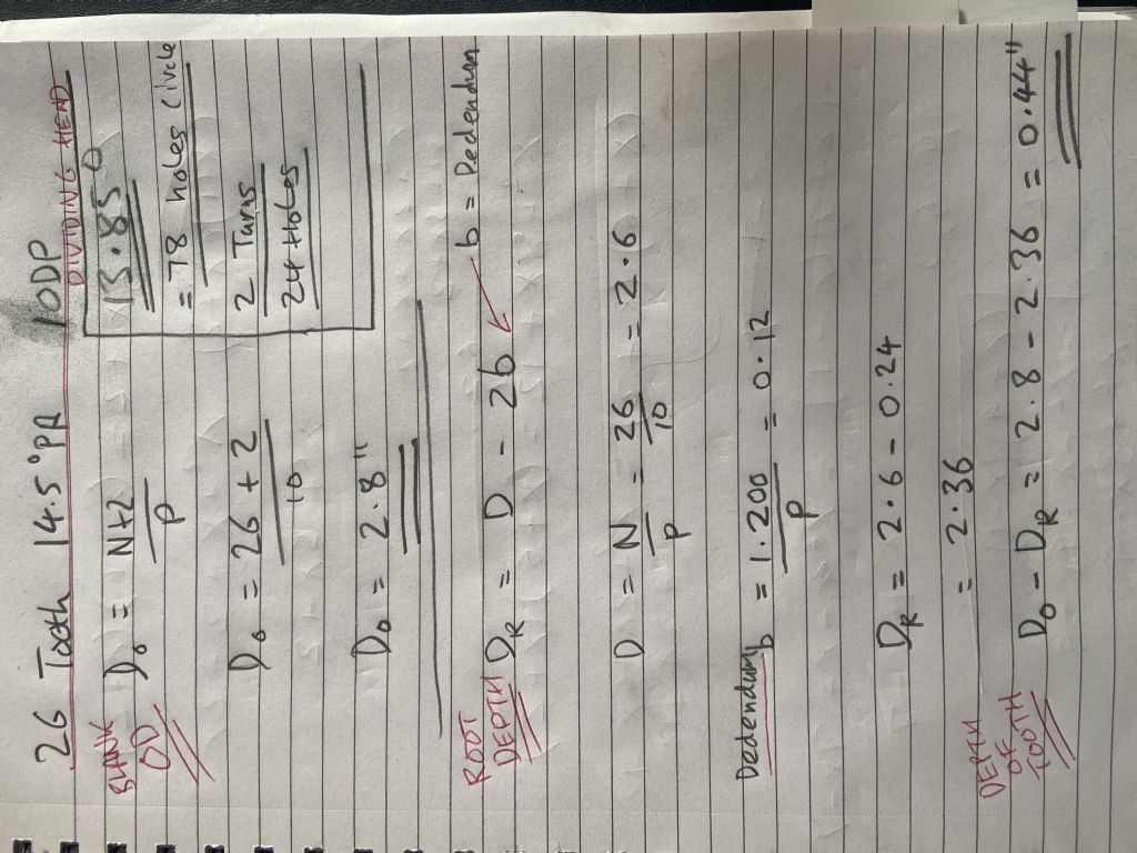

      Asking for help from someone experienced to check my calculations…

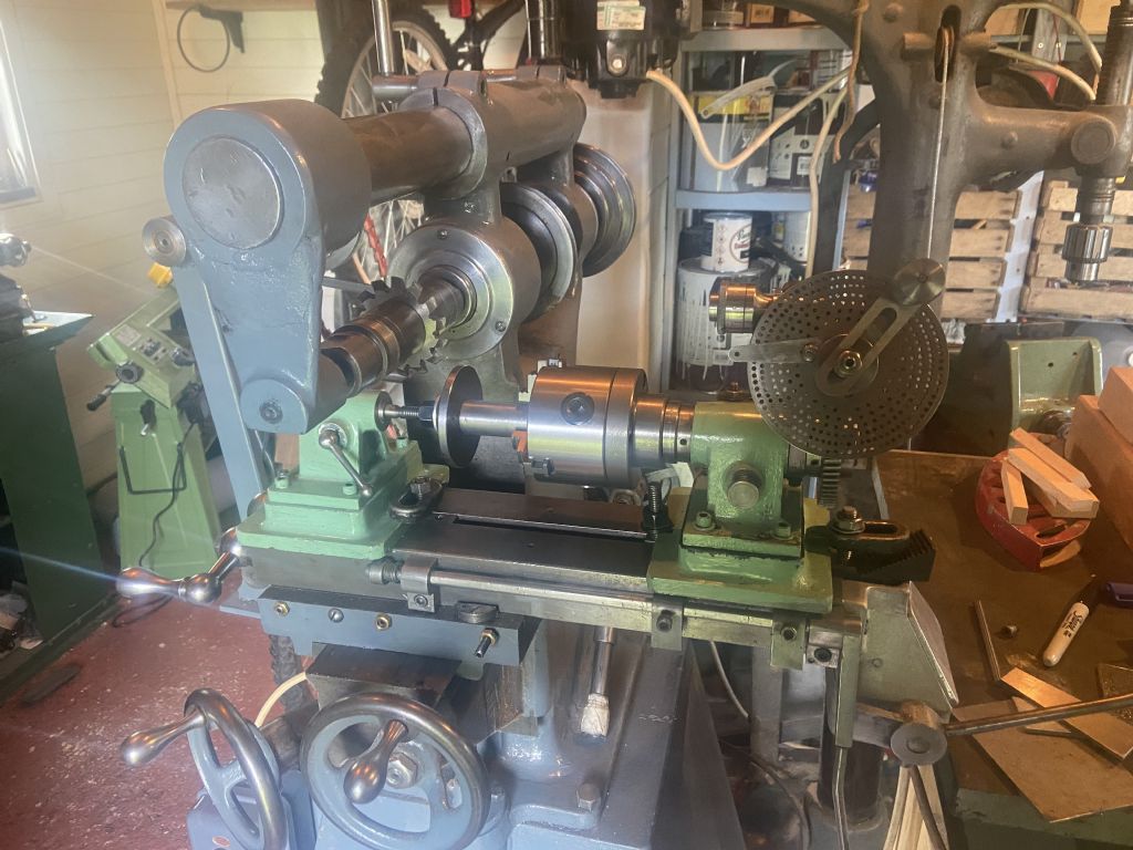

      I eventually got a VDH dividing head – good thing I asked on here before diving in and buying a bigger one, because anything bigger would not fit on my horizontal mill. After lots of fixing and fiddling I have it on the mill and aligned.
      I want to cut a gear as a test piece, to prove I can do it. I have a 26-35 14.5PA 10DP gear cutter than came with the mill so I thought I’d have a go with that, and try to cut a 26 tooth gear. I made a mandrel, broached keyways etc. See pic at the bottom for the setup.
      Next step was to consult Machinery’s Handbook for the numbers. See the calcs on the pic below.
      For a 26 tooth gear I think I need a 2.8 inch OD blank (Do)
      The dedendum seems to work out at 0.12”, which gives a root depth Dr of 2.36”
      So the cut depth is 2.8-2.36 = 0.44”. This seems a lot! Is this correct? Before I start cutting, even though it’s a throwaway piece, I might as well get it right.
      Any thoughts appreciated.

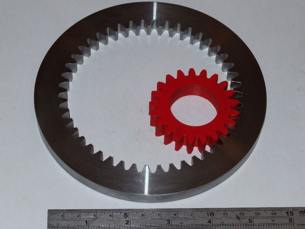

          The calculation for the OD is correct. The addendum is one over the diametrical pitch, so 0.1". In theory the dedendum is the same, but clearance is normally added. Common values are 1.157 or 1.25 divided by the diametrical pitch. Total tooth depth is addendum plus dedendum, so 2.157 or 2.25 divided by the diametrical pitch. The larger tooth depth is used for smaller tooth counts, but there is no hard and fast rule as to the changeover point. The tooth depth will be 0.2157" or 0.225" depending on the clearance allowance. If the cutter is old stock it should have the tooth depth for which it was made marked on it. If in doubt I'd start with a tooth depth of 0.2157"; you can always do another pass. But it's more difficult to add material. For scale these are 10DP gears:

            2.8 – 2.36 = .440 gives you the total tooth depth, on both sides. Depth of cut is half that. So .220" would be spot on the money for how deep to cut each tooth.
            Do it the handy dandy way with this online calculator: **LINK**
            Nice looking VDH you got there. It's worth getting GH Thomas's book on how to use the secondary adjuster dial to cut gears of all odd sizes such as 127 teeth etc. Also on mine I drilled the 60 tooth spindle gear with 24 holes to use it as a spin indexer for cutting hexagons etc without using the index plates.
            Ivan Law's book Gears and Gear Cutting is a must have too. One of the Workshop Practice Series so cheaply available.

              Ahhhhh … I was reading Andrew’s post and desperately trying to work out where I’d gone wrong with my calculation but in fact I hadn’t really. Thank heavens I asked. That’s straightforward then.

                Posted by Steve355 on 13/04/2022 12:51:20:
                …desperately trying to work out where I’d gone wrong with my calculation but in fact I hadn’t…
                Apart from using a non-standard value for the dedendum.

                    Many gear cutters are marked with the depth of cut "D+f".
                    Ivan Law's book, "Gears and Gear Cutting" contains the formulae to calculate this, ,if it is not listed in one of the tables within the book
                    On page 66 he quotes the depth of tooth for 10 DP as 0.216", so it may be worth rechecking your calculations, to find the few thou difference..

                      Posted by Howard Lewis on 13/04/2022 18:16:13:
                      …depth of tooth for 10 DP as 0.216", so it may be worth rechecking your calculations, to find the few thou difference.
                      It is simply down to the choice of clearance added to the dedendum; 2.157/DP in the book versus 2.2/DP used by Steve.

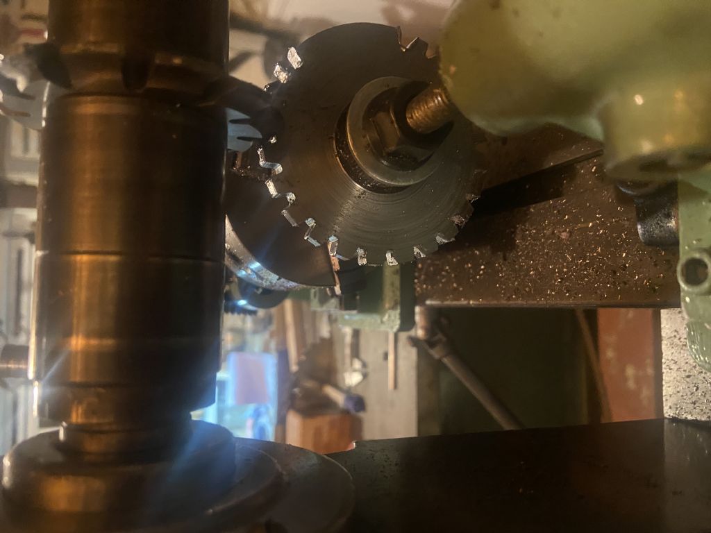

                        Well, I’m not currently having much success.
                        The cutter is c. 2” with 13 teeth I think. Spindle speed is 250rpm, which I think is about right for mild steel @ 120 sfm. My calculator says the feed rate should be around 10 IPM.
                        But it’s not really making chips, more rubbing.
                        What would be a suitable depth of cut?

                          Spindle speed of 250rpm is on the fast side, I'd be aiming for around 60 sfm. As setup 10 ipm gives a chipload of 3 thou per tooth, which is reasonable. Depth of cut is the full depth of the tooth; cut in one pass. Multiple passes just waste time and blunt the cutter.
                          Andrew

                            Steve355
                              @steve355
                              No Jason, even I know which way the cutter should run
                              Unfortunately that’s the slowest it will go Andrew, I thought about changing the motor for a VFD a while back, but couldn’t justify the cost really. Originally the mill had a geared motor, but that’s long gone. Whoever replaced it replaced it with a motor that runs too fast.
                              But …. Success… I was about to give up for the night, but thought I’d try another cutter that I have. I didn’t bother recalculating the tooth spacing, I had already failed with that blank. It went through it not quite like butter, but quite easily. So it seems simply that the first cutter was blunt. Is it possible to sharpen them? Can’t imagine it’s easy.
                              looks a bit like a gear…smiley

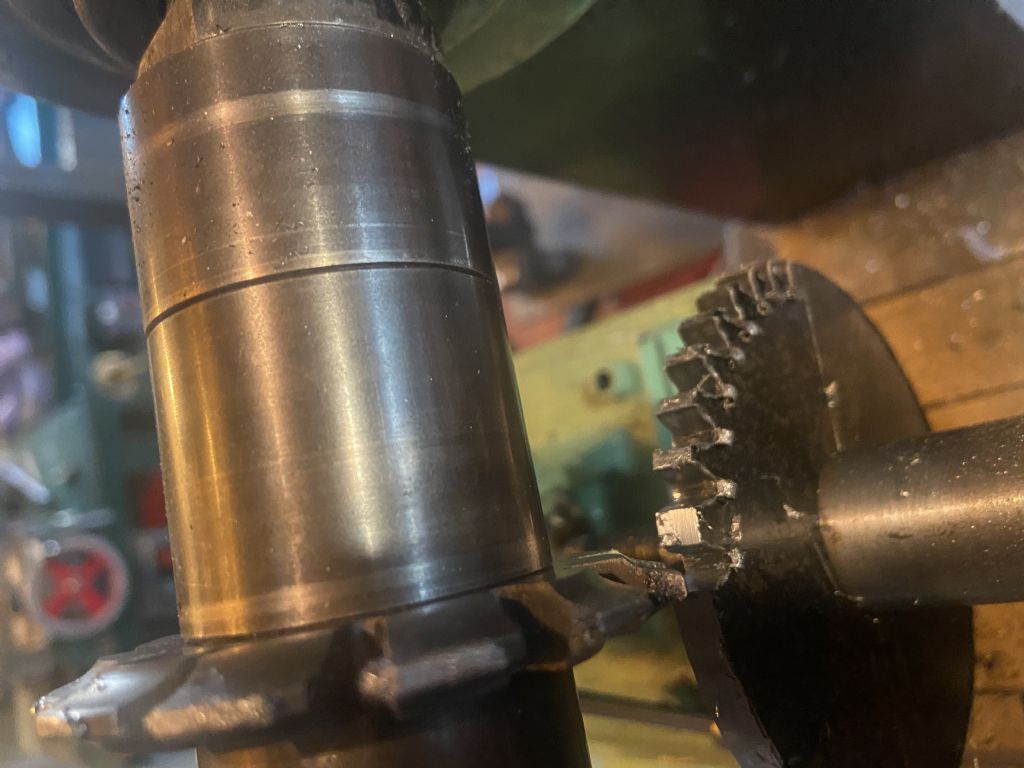

                                I assume the depth of cut isn't full tooth depth yet?
                                Involute gear cutters are designed such that grinding the front face of each tooth on a radius reduces the OD of the cutter but preserves the correct tooth form. To do so an indexing method would be needed. If the cutter isn't too blunt try giving each tooth face a lick with a diamond hone.
                                Andrew
                                #594325
                                Steve355
                                  @steve355
                                  No, the depth of cut in the pic is full depth. The reason it looks wrong is that it’s a different cutter, with a smaller tooth size, but I continued with the 13.7x  degrees I was using on the dividing head. Obviously it’ll never work as a gear, but I was just learning how to do it today. I will cut a new blank tomorrow, recalculates for this second cutter and try to cut a better gear.
                                  I’ll get a diamond hone also.
                                  it looks like there’s quite a lot of deburring to do. Is there a trick to that?

                                  #594327
                                  Anonymous
                                    Posted by Steve355 on 13/04/2022 21:38:02:
                                    …quite a lot of deburring to do. Is there a trick to that?
                                    Just tedium with a round needle file. sad
                                    If there is a sacrificial blank on the exit side of the real blank the burrs where the cutter breaks through can be almost eliminated.
                                    Andrew

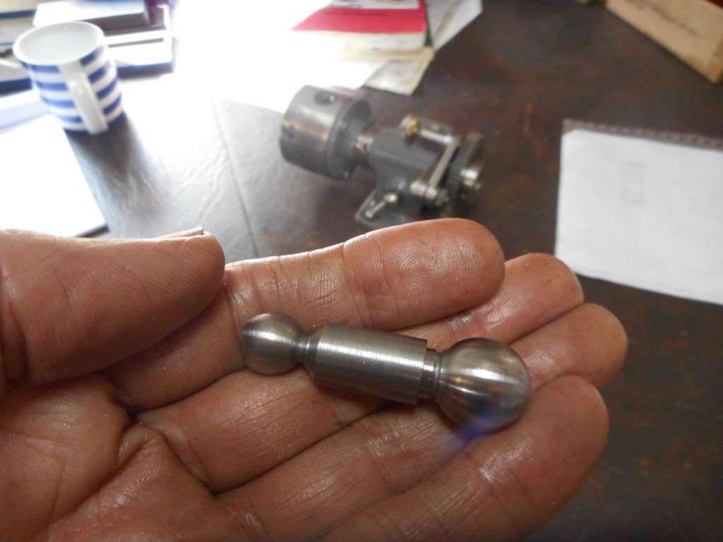

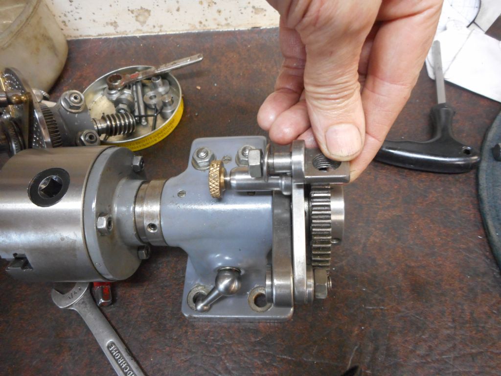

                                        Here's a few pics of the spring loaded plunger on my VDH. It's just a stepped spindle with a spring inside that body that screws into the pice of flat bar bolted to the existing index plate holding bracket.Easy to make without drawings.
                                        I made this non-standard right-angle mounting for the plunger so it can engage with the outside teeth on the 60T gear, which allows you to index more numbers, including fives and tens etc.

                                          Yes, you are right, that’s straightforward. I should be able to knock one up pretty easily.
                                          I’ve been using a Myford chuck for mine, but is there a way to convert it for a collet (ideally mt2)?
                                          #594362
                                          Thor 🇳🇴
                                            @thor
                                            Posted by Steve355 on 14/04/2022 10:54:07:
                                            Yes, have a look at the bottom of this page.

                                              I don't have GHT's books in front of me — they are out in the shed — but from memory his book includes making a set of collets that fit inside the VDH parallel spindle bore. I think they use those three or four grub screws around the end of the spindle to close the collet down for grip. I'll have a look at the books tomorrow and refresh my memory. It is the last part of the VDH I have not made and really need to do because with a chuck there is way too much overhang unless using a tailstock, which I can't in the lathe with vertical slide. I am doing a job right now milling hexagons on some bolts for the tailstock lever attachment I am making and if I had those collets it would be a quick job. INstead I am faffing about clamping the job to the vertical slide and using a protractor to index 60 degrees at time for the flats.
                                              I thought about making a sleeve to put an ER collet chuck's shank up the centre of the VDH spindle, but you still get way too much overhang. So I think GHT's collets are the way to go. Will take a look tomorrow.
