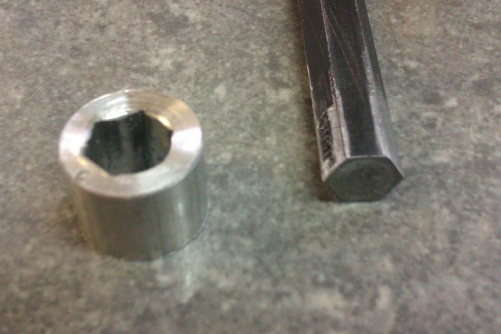

        I need to cut about a dozen Hexagonal holes, about 7mm across the flats. If it was just one, for a one off I would sacrifice an Allen key, but these need to be presentable.
        Material is aluminium about 20mm dia by 12mm thick a hole in the centre and then broached.
        I may need to make more than a dozen eventually so thinking of making a tool. Suggestions anyone?

                      Hi Graham,
                      As the material is aluminium I would try to make a broach from a long Allen key. Using a carbide tool I would turn a number of grooves spaced a little over 12mm apart They only need to take the points off the hexagon. I would then turn the first section to 7mm dia and the following sections to slightly larger diameters until the last section was the full hexagon. It should be possible to force this through a 7mm round hole as each step would only be removing a small amount of metal and only one groove would be cutting at a time. This is only an idea – I have never tried it.
                      Les.

                                          Just tried it and its not a problem to do.
                                          Took a spare 6mm allen key as I could not be bothered to search for a 7mm one, hacksawed off a 1" length, faced and then turned the end slightly hollow.
                                          Drilled a 6mm hole in some ali bar, applied a bit of tapping fluid and pressed the key into the hole using the bench vice.
                                          Not too shabby
                                          If doing it again for a proper job I would cut a slightly steeper cone into the end of the punch, make two punches, one with the corners turned off so the first punch will remove 50% material and the second take it out to size and lastly make a simple guide to keep the punch true while pressing it in.
                                          J

                                            I have had a little bit of a redesign and I can machine the thickness down to 5mm by turning the end cap into a cup shape, will save a bit of weight too. But turns the machining operation into a two stage process, suppose you can't have it all ways up.
                                            I like Jason's idea, cheap, simple, fast. Just need to make it accurate and I am all sorted. I have a couple of presses so that isn't going to be a problem, maybe the fly press. I have looked at some of the ideas and as always, very creative. I still like the rotary broach idea and that is something I could tuck away for future reference – and construction.
                                            The hole doesn't need to be a perfectly formed hex because it is just for an Allen key to remove the cap. It does need to be central though, quite important.
                                            Thanks very much for all the suggestions guys.
