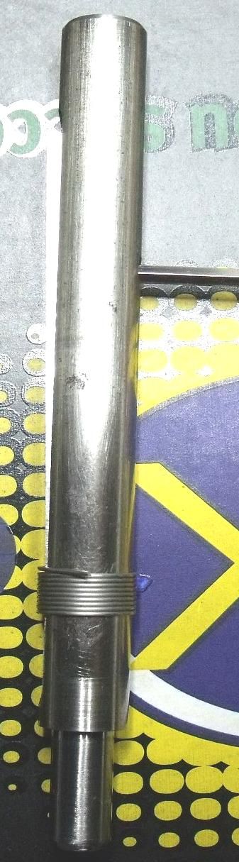

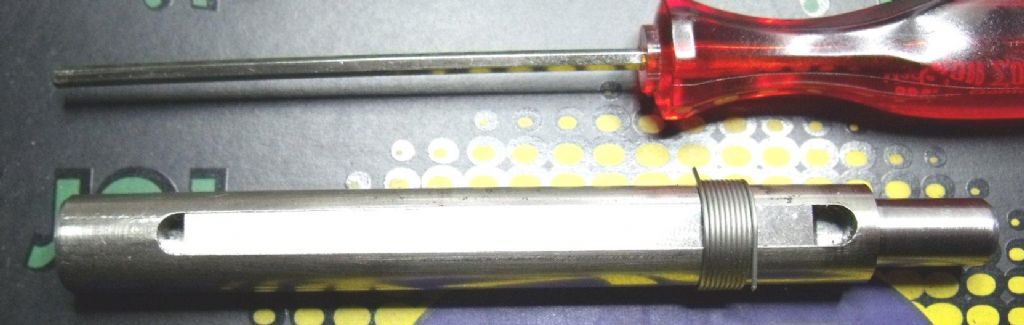

      Posted by Michael Cox 1 on 08/11/2018 21:59:27:
      Here is an easily made adjustable broach:
      http://mikesworkshop.weebly.com/small-hole-slotting-tool.html
      I would suggest that you remove most of the material by drilling or milling first and then use the adjustable broach to clean up the slot.
      |Mike
      That tool is based on the one that I published on another forum some years ago
      One of the things that makes it unique, is the method I used of retaining the cutter.

          #380155
          BW
            @bw
            Does that little bit of wire really hold the toolsteel securely ? Am I missing something here ?
            Edited By BW on 11/11/2018 06:48:45
            #380179
            John Baron
              @johnbaron31275
              Hi BW,
              Why don't you try it !
              I'll guarantee that you can't pull it out by hand !
              That retaining method has been around for a great number of years ! One of its uses is to retain two round shafts that are not in perfect alignment and provide drive from one to the other. You can find examples of this in some of the old radios of the 20's and 30's. I do believe that its used in some rotary tools today.
