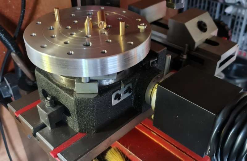

            I personally find a fixture plate like this
            Rotary Table Plate
            much more useful on my 4″ rotary table than a chuck. It’s a 6″ diameter slice of aluminium 25mm thick, with a pattern of M6 threaded holes (same size as my T slots). A 10mm hole in the centre gives location for a centre, and I made a few threaded pins, which with standard clamps let me mount all sorts of shapes on the table.
            It’s held down by four T nuts in the table slots. If you are careful with the placement of the holes for bolting it down, it will also bolt directly to the mill table if needed.
            The only reason for using a chuck on the rotary table would be to allow you to move work from the lathe to the mill without disturbing the concentricity, but that means mounting the lathe chuck on the table, rather than a separate item.

              Thank you for your replies. I thought that I was missing some vital point as it seemed too simple to just bolt the chuck to the RT surface when everybody I could see was faffing around with adapter plates. It is my intention to use a self centering 4 jaw which mostly have a 4 bolt fixing. Both Chronos and RDG sell suitable chucks of this design, but I now realise that I have a good quality Rohm front fixing 4 jaw from my lathe that doesn’t get much use, and provided it’s not actually too big may well fit the job.
              Peter Cook 6, a fixture plate was to be the first task I will complete. I agree whole heartedly that this would certainly be the most useful fixturing device and likely to get most use. I made a small one a while ago that fits in my vice and which allows me to fixture small odd shaped component’s under a cutter. Yours looks a super job. Thank you for sharing.
