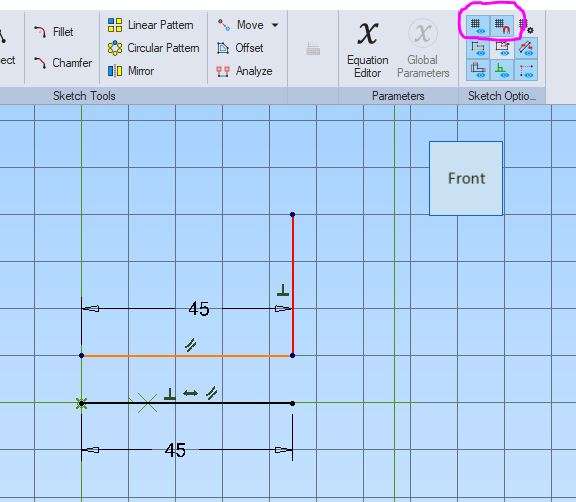

                  like Nick I am unsure of what you are trying to do.
                  Even if Alibre with the grids visible and it is set to “snap to grid” you can click on any line when the dimension tool is selected and give it an exact length. Just tried iyt a sit it not something I ever use
                  Both the horizontal lines were allowed to snap to five squares so nominally 50mm long. I then selected the dimension tool, clicked the line and 50 came up in the box which I change dto 45 and the line got shorter (longer if I entered anything over 50)
                  snap

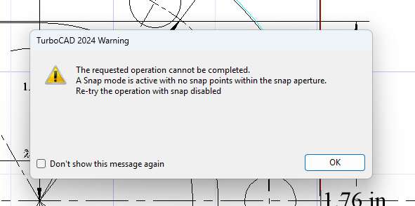

                                Nigel Graham 2
                                  @nigelgraham2
                                  Weary –
                                  That is exactly what I am doing, but something must be going wrong to prevent it working!
                                  The system tells me there are no snap points in the aperture so I should turn the snaps off. So the dimensions will not be to the vertices, but only as near as I can judge by eye. So not correct.
                                  Dave –
                                  I studied the page you cite, but it does not tell me anything very useful at all, I’m afraid.
                                  I am not sure of the difference between a running and local snap, but I use only those available from the toolbar menu, so presumably all running ones. I turn them on or off by need, but not those I am using frequently and can be left active without harm.
                                  I need know why I can’t use the snaps for the dimensions: not the drawing’s outline but its numerical descriptions. That is what is failing, not the drawn objects but their annotations.
                                  For example, if I draw a rectangle 4.000″ X 2.000″ I know it will be 4″ X 2″ to three decimal places (actually far more behind the scenes), but I need the finished drawing to have arrows and numbers telling me those. That is what is going wrong.
                                  I use TurboCAD because it was the first sensible engineering CAD available to amateur users at affordable, single-cost, prices. Every other make was for commercial customers paying commercial costs. Its UK agent, Paul Tracey, advertised it regularly in ME and presumably MEW; and demonstrated and sold it on stands at the major exhibitions. He also prepared a .pdf format tutorial course, on its own CD, packed with the IMSI programme disc.
                                  Alibre came much later and “won” by a commercial tie between its own publishers and those of the magazines, with an introductory, short-term free licence for its Atom edition slimmed from the full industrial software, and a tutorial series in MEW. I assume, of course, it was simply a co-incidence that Paul Tracey’s ads for TurboCAD vanished around the same time, but TurboCAD still thrives and he is still the UK seller.
                                  Fusion 360 had also appeared but I did not like its “in your face” presentation, rather thin and baffling tutorial material, and doubts over its future costs.
                                  Some model-engineers use Solid Edge Community Edition, somewhat like Alibre Atom, introduced by Siemens as they spotted the commercial potential of a stripped version of their massive industrial software. It deterred me by very scant, hard-to-find tutorial material full of references to unintuitively-named, unexplained concepts of its own. (Rather as Microsoft’s ‘Access’ had.) Despite the web-site claims it appeared aimed at experienced CAD users – or their employers – moving to the Siemens products from other makes.
                                  I did turn to Alibre Atom because I was making such heavy weather of trying to grasp TurboCAD’s 3D system; and it is true there is considerable informal support for its users via this forum, presumably a consequence of the magazines’ promotional materials.
                                  Initially I found Alibre much simpler than TurboCAD but it was not long before I discovered its own quirks to fox me, such as Parts arriving in an Assembly all the wrong way round and refusing to face the right way. And the Constraints ganging up to “over-constrain” the thing with no clue how and where. (There are no equivalents to either in TurboCAD: you need build up an assembly directly.)
                                  In essence neither programme is necessarily better or easier than the other, at least not at this level.
                                  I am not convinced I “need” nicely-coloured 3D images if I can bypass that stage. I know they can useful, e.g. by rotating assemblies to verify clearances, but those can be tested in static orthographic drawings too. A 3D rendering helps you visualise a complex item, but if you design it you should know what it looks like!  Nor do you need show gear-teeth or screw-threads unless designing the profile itself: use symbolic cylinders.
                                  I do not go by “Because I can”, but by “Because I need”; but sometimes can not do what I need do!
                                  TuboCAD’s “help” manual is not an easy read, indeed! It is not a tutorial but an aide-memoire for experienced users. The publishers, IMSI, have contracted making introductory tutorial videos to a company in Zambia (?: IT address ending .za) but they seem to have cobbled together several existing ones without much sequencing, and the files do not transmit fully anyway.

                                    Weary
                                      @weary
                                      Aha!
                                      Nigel,
                                      you may have given-away what the problem is …… “The system tells me there are no snap points in the aperture”.
                                      The ‘aperture’ is the surface area in which the chosen snap is affected by the cursor.  Brief explanation here if you scroll down to near the end of text.
                                      Sounds like you need to get the mouse better ‘aligned’ to the desired ‘snap’ point; in the example given, the vertex of the line.   Perhaps ‘zoom in’ on chosen end of line and then try again, BUT, you need to be aware that the ‘snap aperture’ is not always intuitively obvious, so you can make it ‘visible’ if you wish (Programme Setup -> Options ->  Preferences). You can also increase the size of the snap aperture.  This is done in the same Programme Setup -> Options -> General.
                                      This video here shows your problem & the ‘solution’ – I suspect. (Vid’ only 2 mins long.)
                                      Phil.

                                      Nigel Graham 2
                                        @nigelgraham2
                                        The advantages TurboCAD have for me, over Alibre Atom, are that I can draw directly in 2D mode without needing the difficulties of 3D parts and assemblies first, and geometrical constructions are easier in TC’s 2D mode than in Alibre Atom.
                                        Atom is still on my PC for the odd occasion it might be useful; but I don’t use CAD very often anyway. I cannot progress beyond occasional geometrical problems and accurate rough sketches in 2D, and pretty but largely useless 3D images of simple objects.
                                        Phil –
                                        Thankyou. I know what is the Snap Aperture but still watched that video to see if I had missed anything. No, I hadn’t.
                                        I enlarged the aperture and made it visible, then tried various tests, all with the same useless result including the error message reproduced below.
                                        Rogue workplanes? These sometimes creep into my 2D drawings. No, not that.
                                        Had I unknowingly built in some sort of block? Try with a totally different drawing. Same effect. Select a line and the Inspector Bar tells me its true length, but I can’t record that on the drawing in the proper way.
                                        A New drawing from scratch? A simple 4-line rectangle (not library rectangle) using the Inspector Bar and Vertex Snap for the line lengths and orientations. Same error.
                                        Basically, I can no longer dimension even a simple drawing accurately, in the way it should be and as I had always previously used without problems.
                                        Screenshot 2025-06-24 215912

                                            I see it like this:  TurboCAD provides a number of power-assisted snap features that boost productivity when used appropriately.  Features include an adjustable aperture (set in preferences), Running Snaps (turned on/off by the operator), and Local Snaps (also operator activated)   Possibly related are Constraints and Dimension Constraints.   These tools have to be used correctly, in combination,  and confusing problems can occur if they aren’t.
                                            I think root cause is operator error.  At some point, a snap or snaps have been activated in a combination that TurboCAD can’t sort out automatically.   What should TC do when several snaps are within range?  Not guess!  I think it throws an aperture error, a hint to the operator that a snap combination is ambiguous and some should be turned off.  Which ones is down to the operator, his drawing, he decides.  Some more obvious than the others; the grid is unnecessary when dimensioning.   Others depend on the drawing, but the principle is the same: when a snap isn’t needed, turn it off!
                                            Been suggested by others already, my bold:
                                            Weary said: Your ‘snap issue’: Have you got too-many snaps on perhaps? I vaguely recall having a similar issue when I had too-many snaps ‘on’ that were therefore conflicting when doing some very fine work. This can be especially so when you have grid ‘on’ and ‘snap to grid’ ‘on’ and numerous other snaps ‘on’ too.
                                            Remedy = as Nick suggests -> reduce snaps ‘on’ solely those immediately pertinent. Turn others ‘off’.
                                            Nick said:  Using the correct snap or constraint is one of the fundamentals of CAD.  You turn them off so you specify exactly what you want instead of the program guessing. It can do that so unobtrusively that you don’t realise until something else doesn’t work that it guessed wrong.
                                            And IanT said: One of the key takeaways was to use keyboard shortcuts (e.g. move completely away from the drop down menus) as using the drop-downs was time consuming and could be confusing – especially for snaps.   This helps because TC shortcuts use Local Snaps, reducing the need for Running Snaps; if Running Snaps are turned off, they and Local Snaps cannot conflict.
                                            Turning snaps off is easy in principle, but not if a preference has been set behind the scenes, or an obscure option selected, or it was invoked by an accidental key combination.  If turning all the obvious snaps off doesn’t fix it, then the operator has to find the incorrect setting by wading through the detail.  Pointing and clicking randomly is unlikely to help.
                                            Not easy: understanding TC is a wet-towel-around-the-head and strong-coffee job!!!  Other CAD tools take effort to learn too, but  TurboCAD isn’t simple.   The operator is expected to understand it’s power features.
                                            I’d try something simpler, perhaps QCAD.   And, if CAD is more trouble than it’s worth, go back to the drawing board, literally!

                                              Phil –
                                              A point I missed earlier, that you made. You can change an entity’s size in TurboCAD but not by editing the dimension annotation as in Alibre. Instead you edit its values shown at the foot of the screen.
                                              TurboCAD’s dimensioning is purely reactive, not a line-setting tool.
                                              What I mean throughout by dimensions and dimensioning, is the instructions you add to the drawing to tell you what size to make the thing. Not the drawing controls, even though Alibre combines those functions.
                                              Dave –
                                              I have tried all sorts including having only the one relevant snap turned on.
                                              There are no “constraints” in the Deluxe versions of TurboCAD.
                                              I’ve also asked on the TurboCAD Users’ Form but that elicited a long reply “helped” by two screen-shot videos, and not answering my question. They merely demonstrated some aspect of a different version of the software.
                                              However, elsewhere in that Forum, someone had encountered Snaps problems when he changed his computer from MS Win-10 to WIN-11. I am not convinced by that but having TurboCAD 19 on my spare, off-line WIN-7 PC I have nothing to lose by trying the same simple drawing by the exactly the same steps on that, as in TC 2024 on my WIN-11 computer.
                                              Both of my TurboCAD editions are of the “Deluxe” strains.
                                              It seems no-one else has had the same problem here, which is why my question appears to have puzzled everyone!
                                              TurboCAD’s SEKEs (Single-Entry Keyboard Entries), its keyboard short-cuts, accelerate drawing for experts (especially professionals) who can remember them; but there is no harm in using the drop-down menus instead despite the switching back and forth. I use perhaps three menu Snaps all the time, turning those off only when necessary.
                                              Whatever is going wrong wants ALL the snaps turning OFF – which does not make sense!

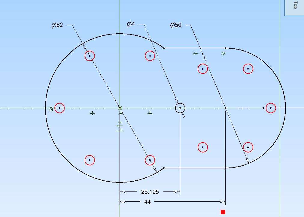

                                              #804515
                                                You still seem to be unable to accept that any part in Alibre starts with a 2D sketch. No different to doing it it TC, F360 or any other CAD. So why not try it in Alibre.
                                                2D sketch
                                                2d sketch
                                                2D drawing ready to go. I did not need to go into assemblies and just gave it a nominal thickness which is the only 3D bit and is not rocket science
                                                2d drawing

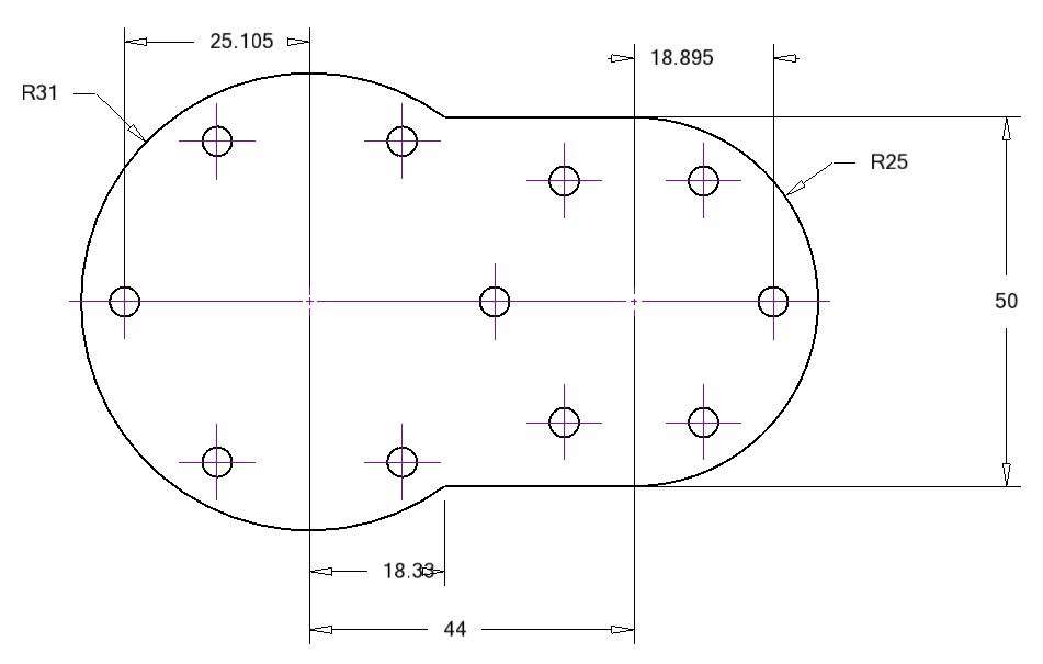

                                                    Another user on TC’s own Forum suggested if all else fails, adding dimensions to a drawing as text labels, copying the values of each selected shape from the “Inspector Bar”. Fine for defined entities like circles and rectangles, but not for resultants like clearances and diagonals.
                                                    Clearly I must be doing something wrong to make a basic drawing tool fail, but so far still have no idea what!
                                                    Because CAD is so difficult and an occasional necessity at best, I use it infrequently and only enough to get by; but I do want the drawings to tell me how big to make their subjects.
                                                    Jason…
                                                    Do you mind? I know perfectly well that an object in an Alibre Atom 3D model starts as a 2D sketch, thankyou!
                                                    I have used Alibre a fair bit, most recently in February. I had modelled many of my steam-wagon engine’s components in 3D and perhaps even correctly, but Assembling them into a decent 3D image of the whole engine proved impossible.  I still have the result but it is very rough, as useful as a ‘Cerrobend’ fire-door.
                                                    My cylinder covers were my first TurboCAD drawing for months, too. Though I could represent them in 3D (just simple extrusions) I could not create a TurboCAD 3D model of even just the crankshaft, let alone the entire machine.
                                                    I’d gone back to TurboCAD because I felt I can never create 3D assembly drawings at useful levels in either programme, but I can draw vaguely useful 2D ones directly in TurboCAD. Though printing them is very difficult and confusing.
