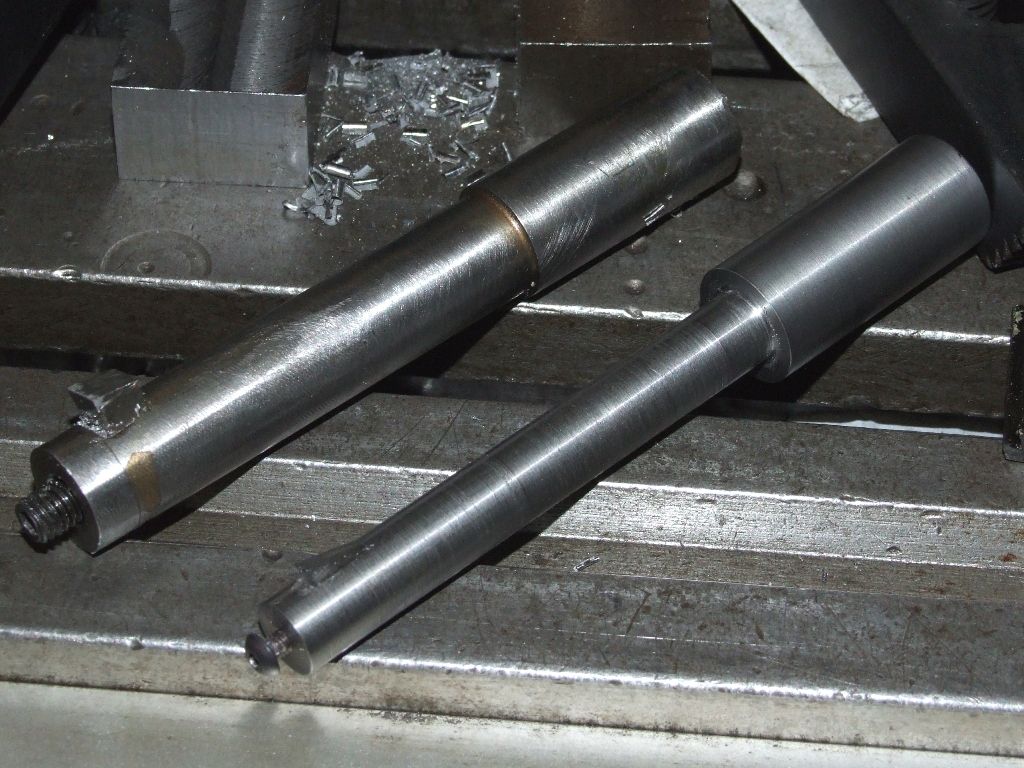

                    Here is an easily made adjustable broach:
                    http://mikesworkshop.weebly.com/small-hole-slotting-tool.html
                    I would suggest that you remove most of the material by drilling or milling first and then use the adjustable broach to clean up the slot.
                    |Mike

                        I did something similar but in a much simpler crude way. Drilled a steel bar to take a drill bit radially, locked in position by a screw. 20181006_142735[1].jpg

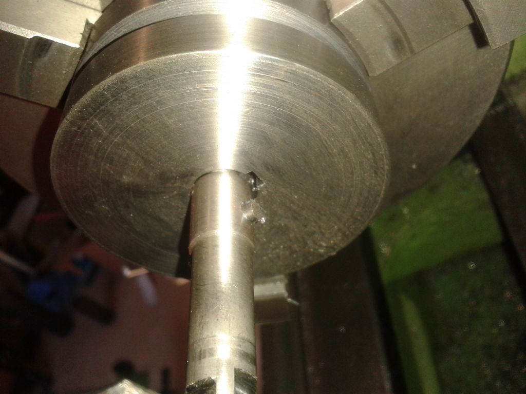

                                              This post spurred me on to put the keyway in my otherwise finished flywheel!
                                              Using Andrews method, I fitted a length of shaft into the bore secured with a dab of picture on the end, just enough to hold it in position.
                                              I then drilled down through the joint line with a 3/32 drill which was then opened up to 3mm.
                                              Shaft tapped out I adjusted the broach to remove about ten thou per cut. Could almost be tapped through by hand although a hide mallet was used.
                                              Came out well and didn’t take long.
