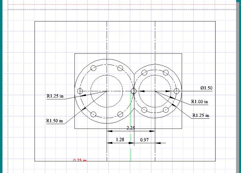

        I copied the TurboCAD 2024 Deluxe drawing via a USB stick from my WIN-11 PC  to my other computer, running TC 2019 Deluxe on Win-7. And perfectly happily.
        It would not open: I don’t know if by Microsoft or IMSI, or both.
        However, using a partial drawing already on the TC2019 library, I could produce a new 2D sketch of those cylinder covers without difficulty, even solving the aesthetic problem of making 2 unequal discs share a central stud – the mismatch loses a mere 0.03″ from one side.
        Crucially, the dimensions worked as they should.
        I saved the drawing, copied it back to the USB stick and opened in TC2024 for printing. Which it did – but I could not dimension the rectangle (the cylinder block outline) in TC2024: that snaps/dimensioning conflict again.
        The dimensions and snaps in the 2024 edition I have, will not work together.
        Those in TC 2019 on a different computer, do work.
        Result shown below: ignore the coloured fragments.
        So “Sit-Rep” as they used to say… whoever “they” were. Characters in Z-Cars perhaps.

        Screenshot 2025-06-27 092230

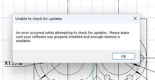

            Yes, my experiment does suggest a software fault. When I open TurboCAD it says it cannot look for up-dates. I would not naturally assume those to be as basic as dimensions and snaps. I read them to mean more architectural tools and image-rendering power; possibly enhanced security too, to protect professional users’ IP.
            It must have been properly installed because it was working right up to last time I used it, whenever that was – January I think.

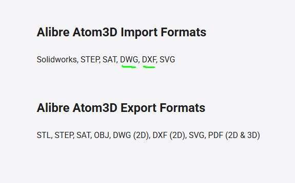

              Atom should import the two that is said
              dxf

                  In the meantime I have sent an e-post enquiry to Mr. Tracy, with a picture of the “can’t find updates” message that appears when I open a drawing file.

                    No I said IMPORT them into Atom, why are you looking at files it will export?
                    I just snipped that image from Alibre’s website wher eit says what it can import.
